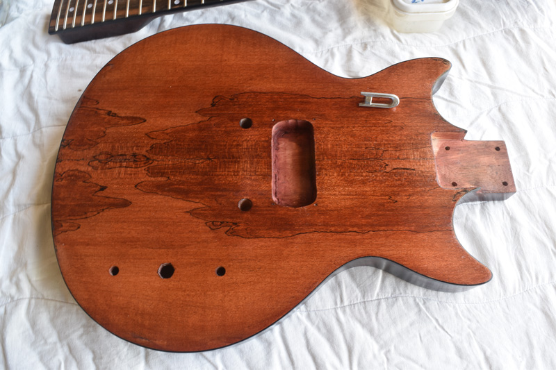

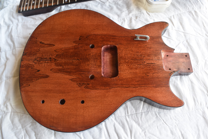

    Have about 6 coats of TO on so far. Have adjusted the pick up cavity to take the humbucker , it needed some off all round and some extra depth as well as there are so many wires coming off it.
    I mixed the stain from wood dyes and a touch of black ink. The sides are mostly cedar with some red and black. the top is a mix of cedar, orange and red.
    There was a thin glue line down the centre and in a couple of spots near the edges. I got out my tamiya modelling paints and mixed up some colour to match the stain, dabbed it on, then got a super fine paint brush and painted some spalting over it.

    nice one Deddy looking very nice. 6 coats in 3-4 days, hope they were thin coats
    Will that D letter be stuck onto the body or headstock ?
    the D is just a joke Wokka, Duesenburg have a D about there on their guitars.
    I do one coat in the morning and one late afternoon Wokka, TO dries pretty quick.
