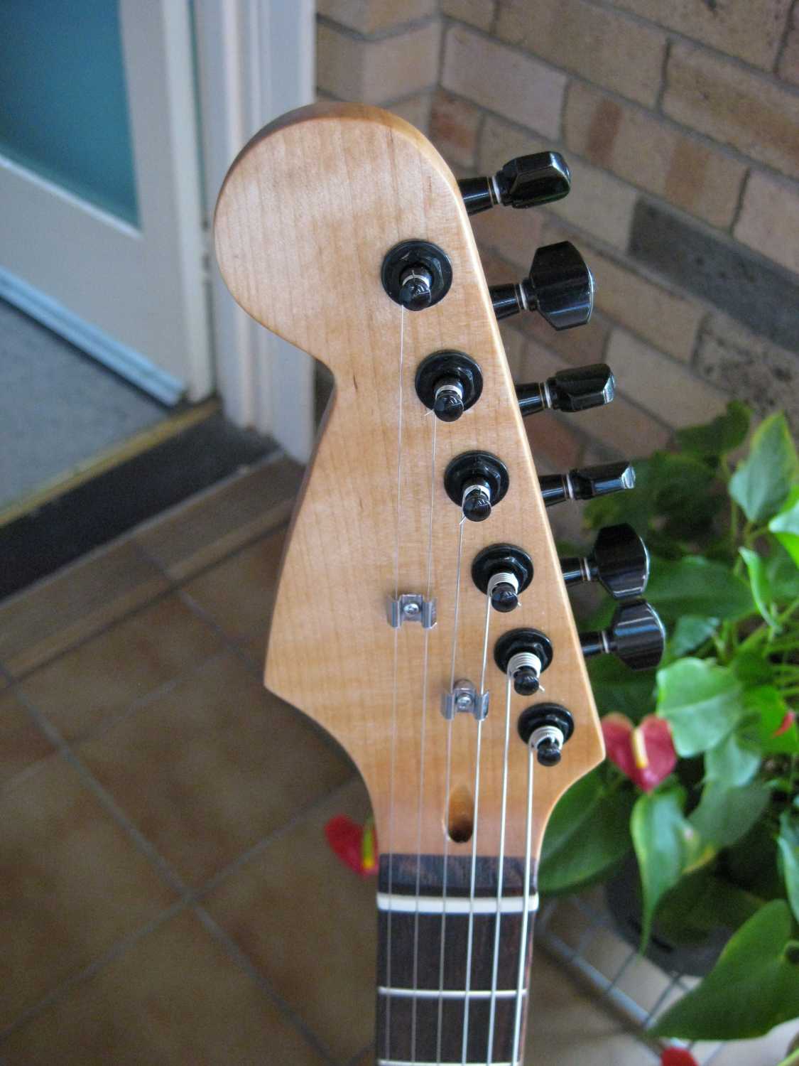

    One string tree or two? Usually around the g string tuner is good, but I don't think it really matters all that much,

    String tree positioning does depend on the height between the nut slots and the headstock face. On shallower necks, the trees need to be nearer the nut, on deeper trees, further away. And you may not need two string trees. Try living without the D/G string tree if you can.
    Here's the Fender take on it.

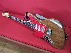

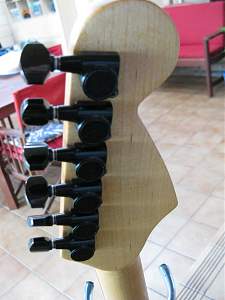

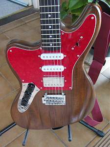

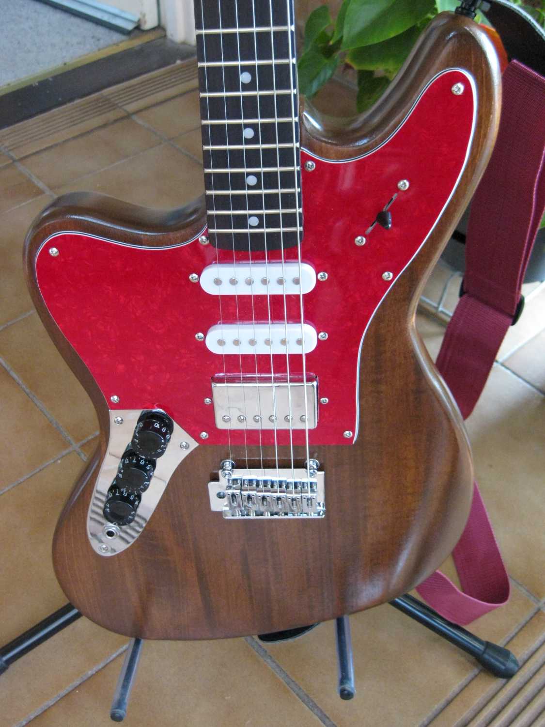

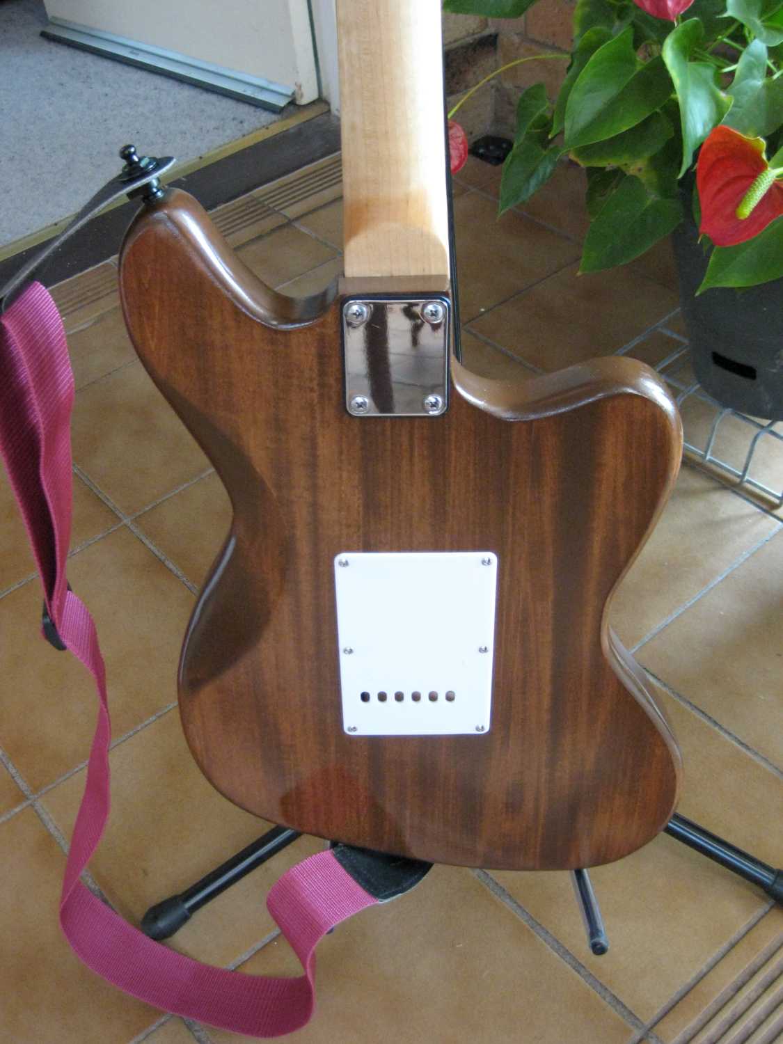

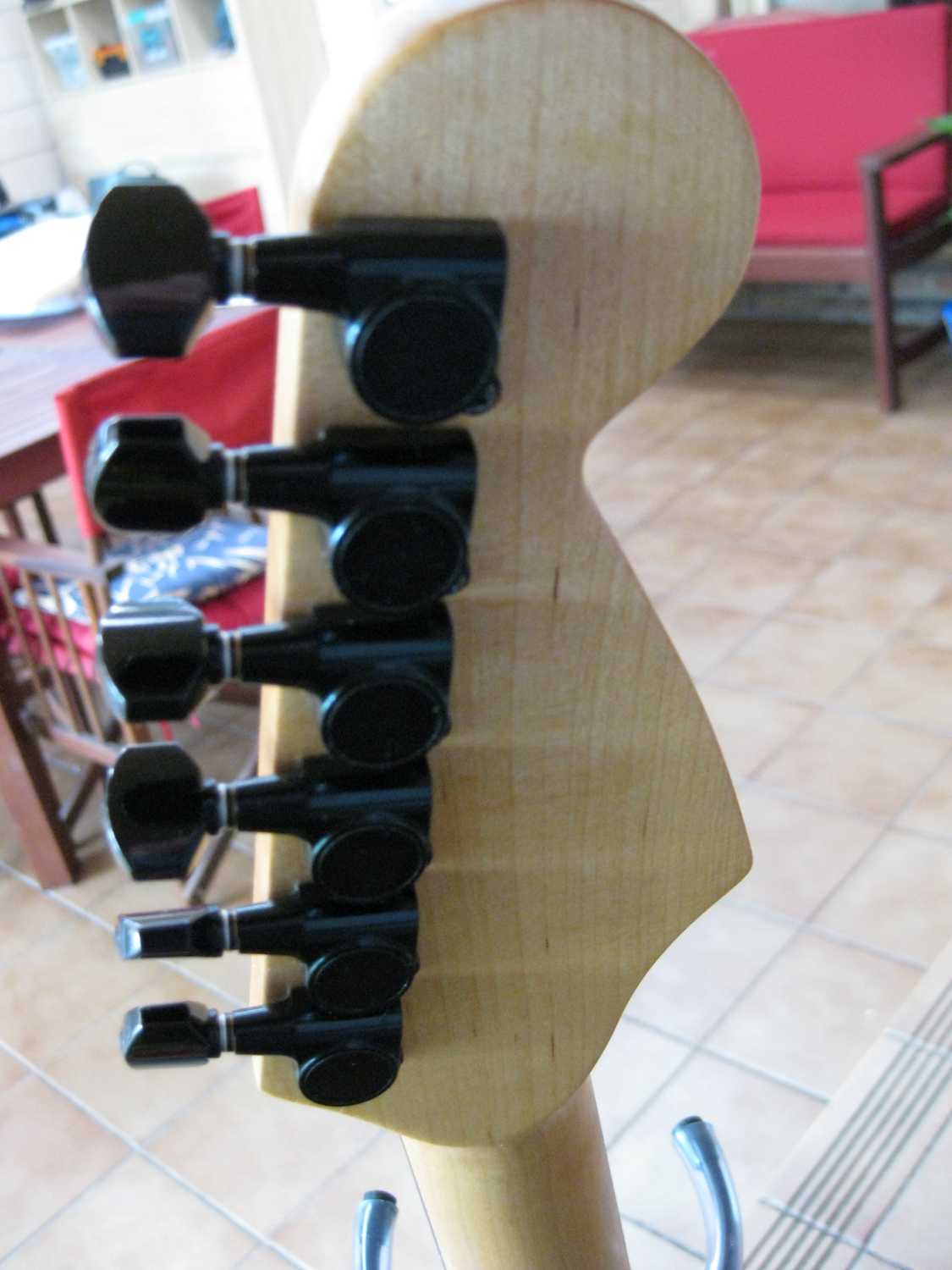

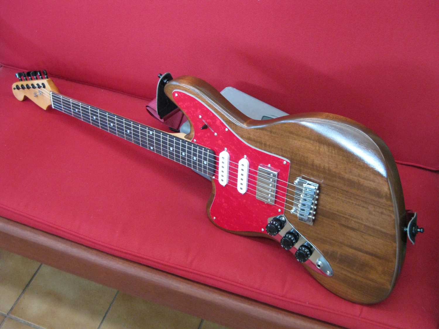

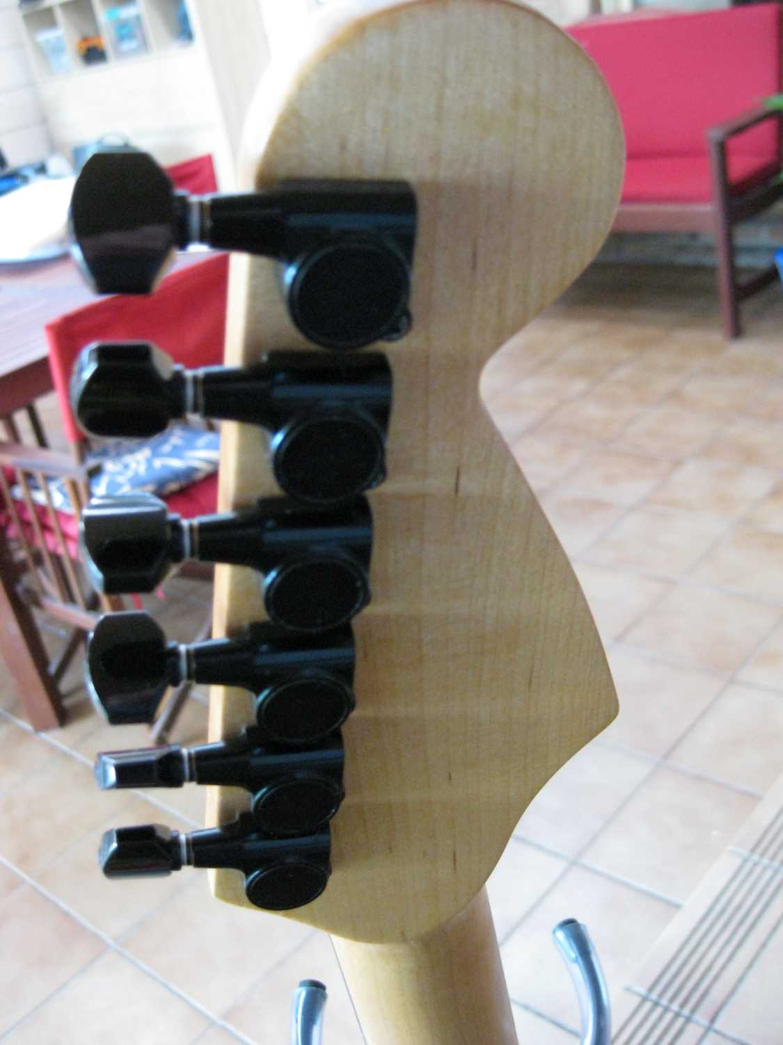

    Apart from the ongoing small adjustments, I would consider this now basically finished.
    Standard apart from the nut (Tusq) and tuners (Gotoh).
    I am happy with the way it came out - the biggest issue was the incorrect soldering from the factory and the cryptic nature of the wiring diagram.
    But it all works so I am happy. Pickups are nice and loud and the action is low with no fret buzz. I was a bit iffy about the bridge at first but it is very adjustable.

    Looking very sweet!
  7. #17
    Came up really well Colin. How do you find it weight wise? I'm toying with the idea of putting mine on a diet when the inevitable rebuild to MK 2 happens.
  8. #18
    I'm thinking of taking around 50mm off the 'bottom' of it and re/shaping it a bit, but keeping the overall style and shape. I also want to move the hum bucker closer to the bridge, and redistribute the centre pickup.
    I may yet just buy another body and neck for the MK2, it will be little while anyway. I have a few things on the go that I'll share in due course.
  9. #19
    Looks good Colin. Well done.
  10. #20
    hey man, very nice. Im at the start of a JMA build now. Your finish is very close to what Ive chosen for mine. Looks awesome!
