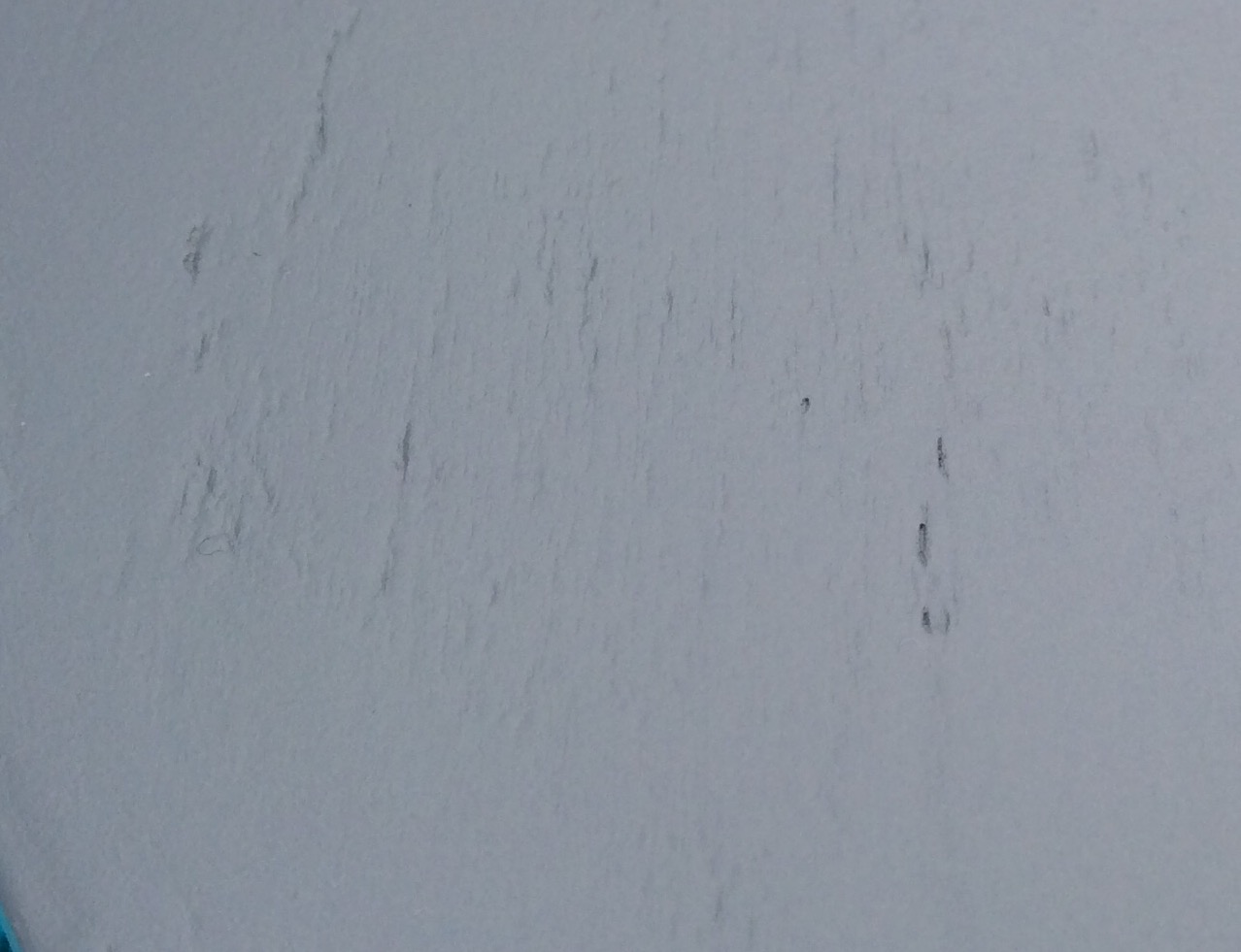

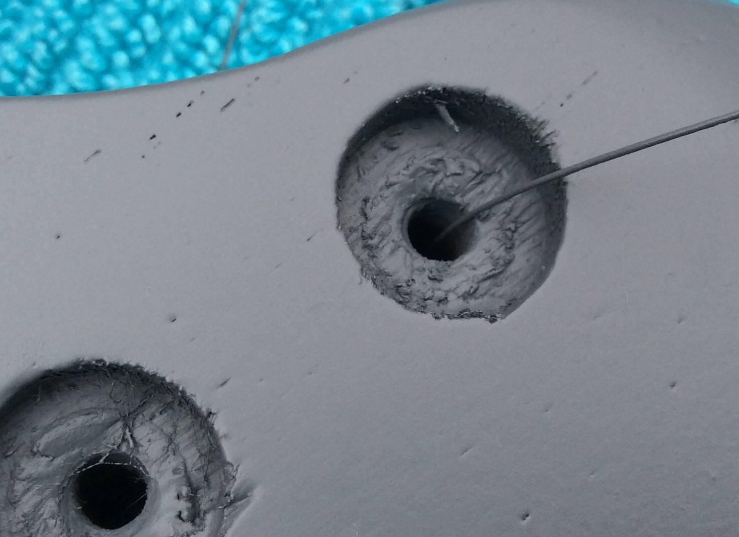

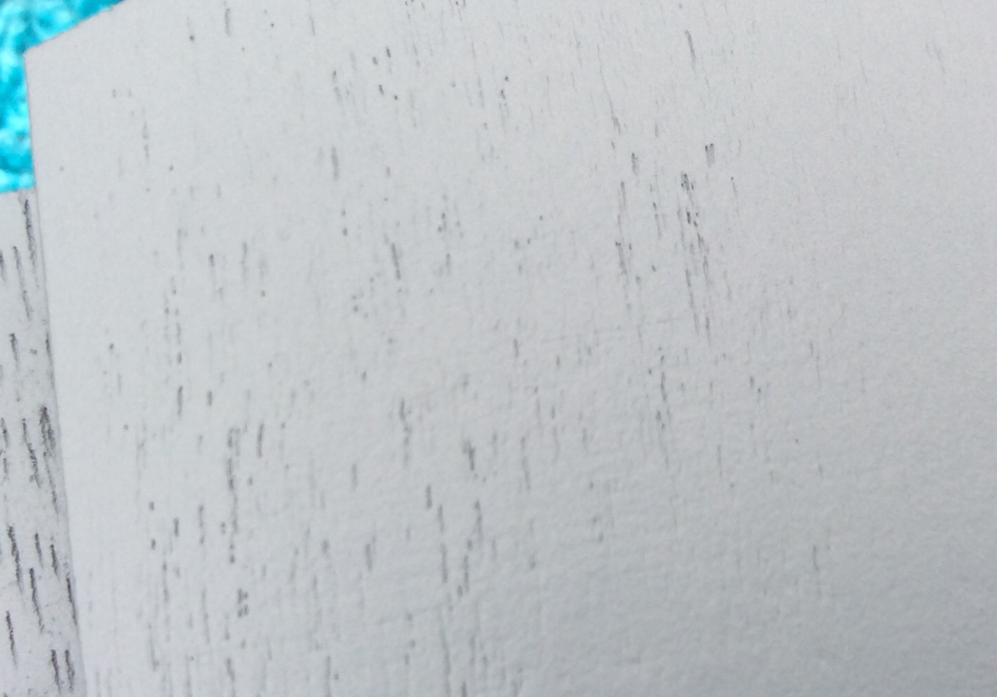

    Hi all
    After some contemplating I have decided to paint my IB-1 kit a metallic blue. There were far too many glue spots on the spalted veneer and I didn't want the veneer looking ugly and poorly finished. Anyway I began my painting process a week ago by spraying on multiple coats of primer/sealer, so far 6 coats. The majority of the body has accepted the primer/sealer very well and has left me with a smooth and flat looking surface, however some areas still have little pores that have not been sealed despite 6 coats of primer/sealer. Strangely enough the spalted veneer has the most pores compared to the mahogany which has very small pores. I have added pictures below to show what I'm talking about, and so my question is do I need to seal these small pores with an actual wood filler or would more coats of primer/sealer do this?
    The pores are nearly all over the guitar body but I took pictures of the worst ones

    Hi Joe, it's usually best to grain fill before the primer goes on. I know about the large pores in the spalted maple veneers. I would press on with more primer/sealer coats until the pores fill, then move onto the colour coats.
    EDIT just saw the photo's that will take many more coats to fill those pores. Have a crack at grain filling and you will need to dry sand it off (after overnight curing), wet sanding will moisten the grain filler too much and pull it out of the pores. It may create a few fine scratched on the primer but I think that's the best option.
    in hindsight would have been easier to sand off the spalted maple veneer. Note this process needs good ventilation and a proper dust mask as the fungus in the grain can upset your lungs.
    Did you attempt to use goof off to remove the glue on the veneer ? I would be crying if I had to sand that off or paint over it
