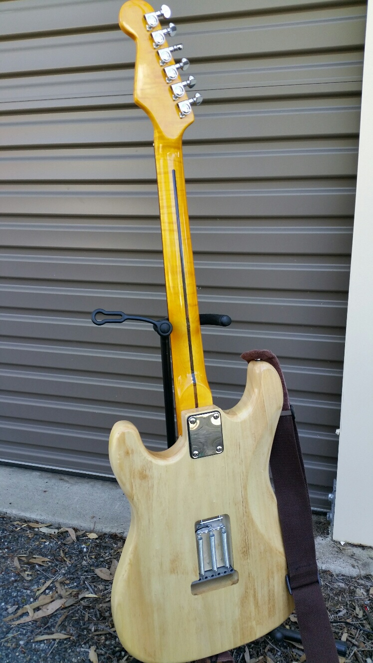

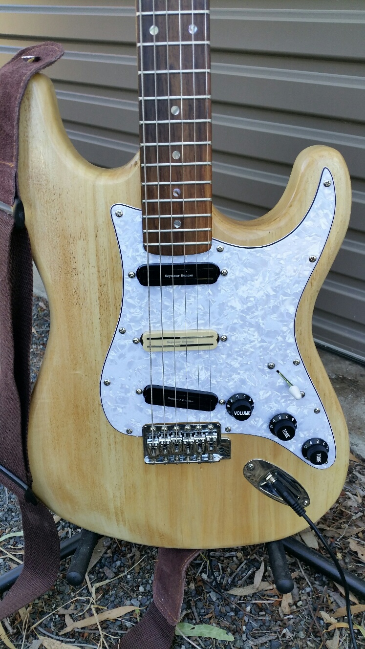

    When I did my last Strat build the body wasn't accepting the stain very well so before it dried I wiped as much of it off as I could, and then when it had dried I gave it a gentle touch with some sand paper. I actually liked the result so went ahead and clear coated it. Since then it has become my favourite Strat to play.... but that may just also be the SD HR/VR/CR combo that it has fitted....

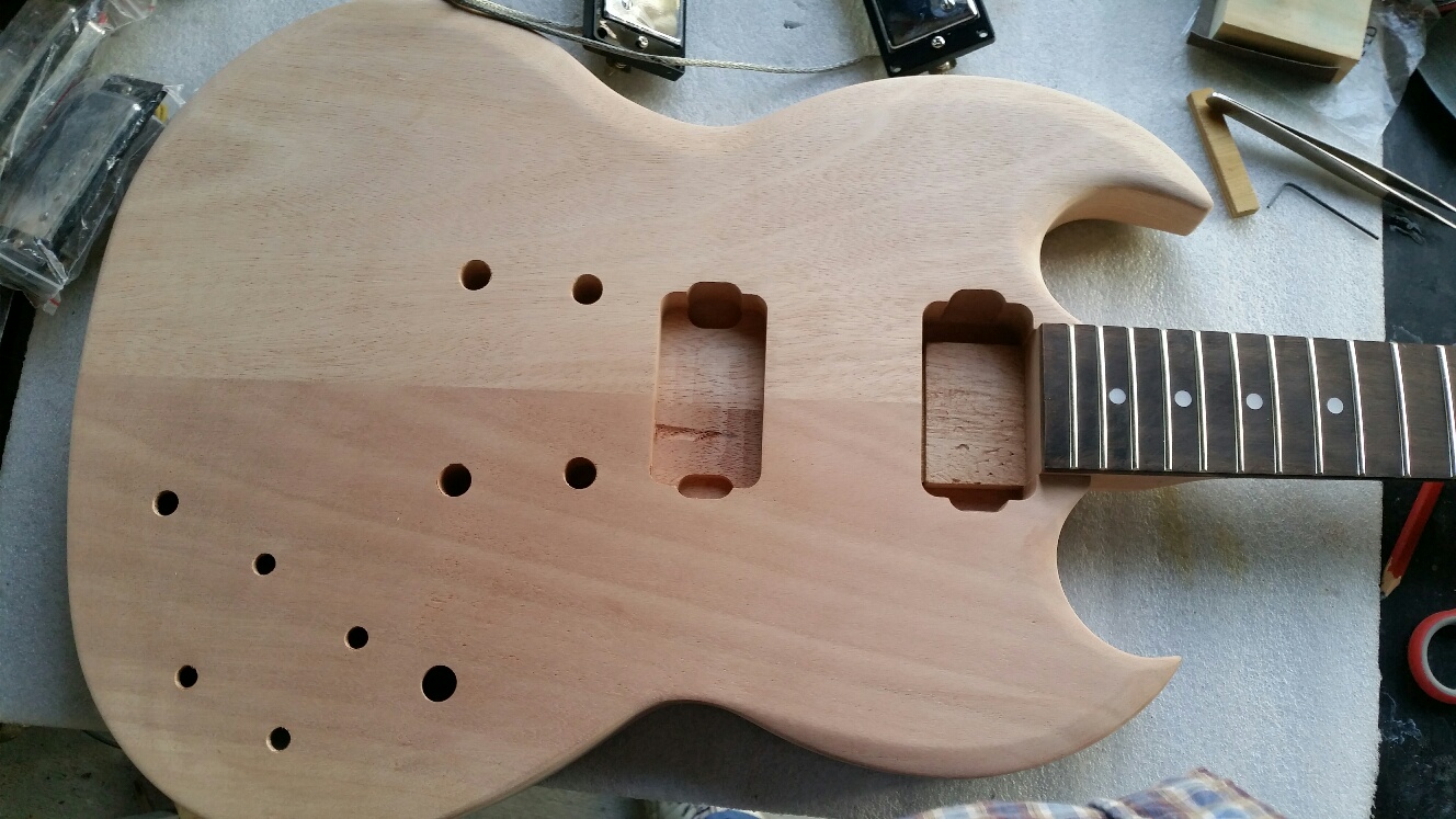

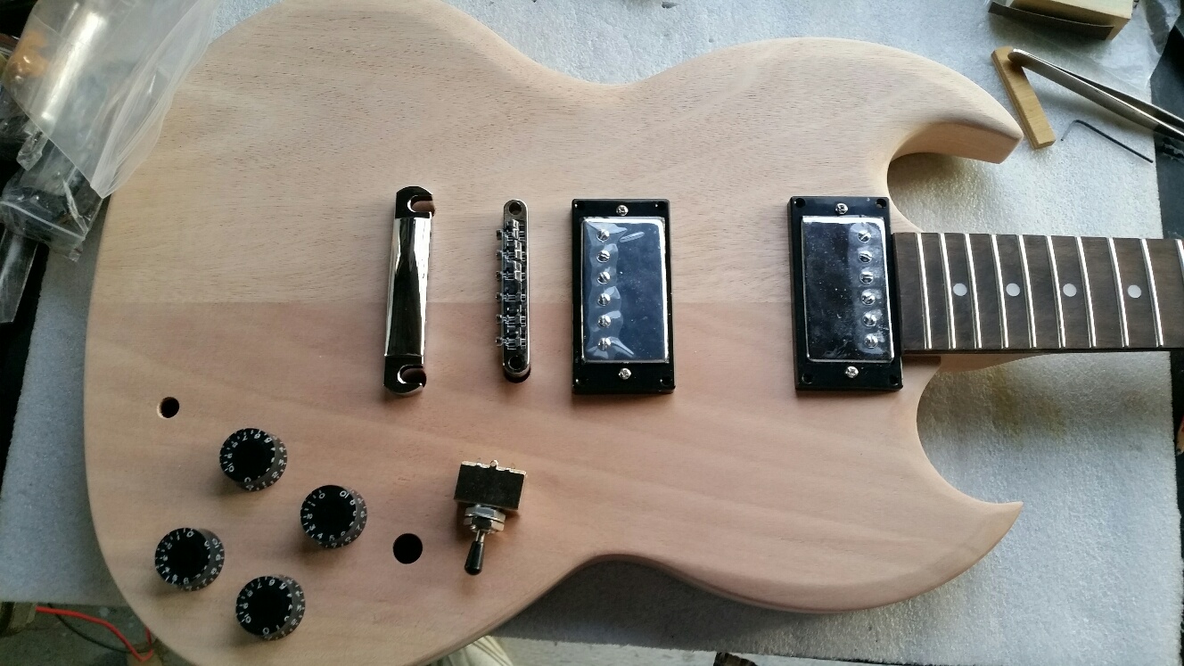

    While waiting for my nephew to turn up I did a dry fit of the SG, and checked the neck position relative to the bridge. Mahogany body and Mahogany neck.... With the Alnico 5 Belcat PU's it should sound interesting when built.
    313mm to the 12th fret, 630mm to the high E string end of the bridge, with just enough room left to squeeze in the replacement neck PU. With those measurement and if things go as hoped it also should intonate okay.
    Will need the TimberMate treatment to get closer to an ideal finish. Thankfully nil major dings anywhere in the wood
    Still undecided on colour...

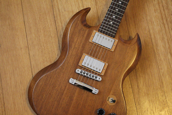

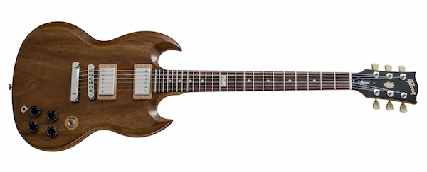

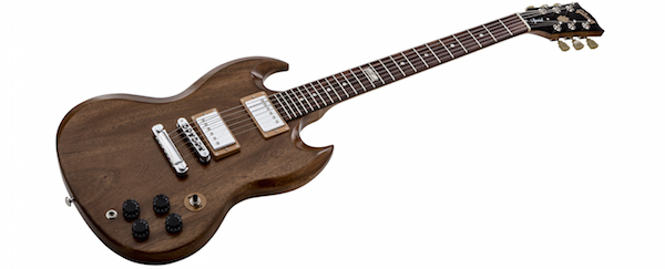

    After a bit of hunting around, and weighing up the options over what colours and finishes I can achieve on hand, the direction I want to take this build can be envisioned in these photos from the net.
    Essentially I'll be trying for a 1979 SG special type look ...

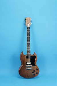

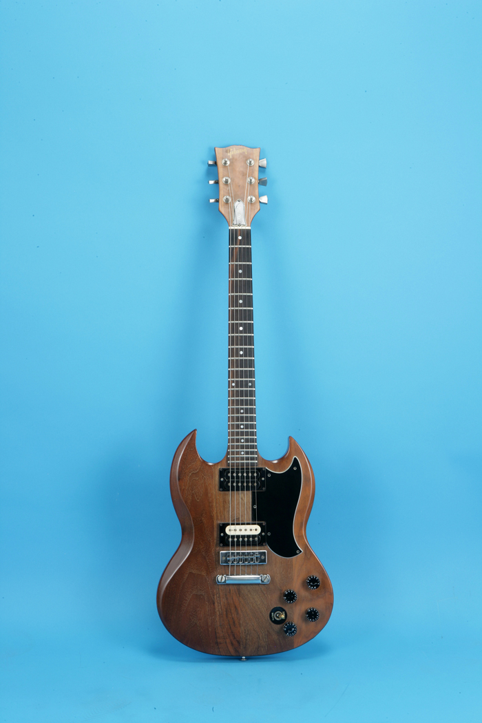

    That's a 2014 SG special (120th Anniversary neck inlay) in the pictures. Otherwise you are more likely intending to refer to either the 1979 The "SG" model with a walnut body and a small scratchplate...
    ...or the similar looking Firebrand SG which replaced it in 1980 with a mahogany body. The original SG Special of course had the twin P90s (which is now re-made as the SG Classic model).

    Main thing on the pictures was the colour and finish aspects. I know I'll never exactly match the colour but the picture is indicative of the target I'm aiming for.
    So with that finish, moving the switch to match the Firebrand layout would create a Mahogany grain matching nightmare in trying to fill the existing switch hole that exists now. Hence my reasoning for not attempting that.
    As for the scratch guard.... For the moment I'm liking its absence more... We will see how that progresses...
    I note that in the original Gibson 80's model the P90's were made with Alnico V magnets which apparently made those SG's quite bright, Hoping my Belcat HB's with their Alnico V's show themselves to be a slightly less bright and less noisy alternative.
