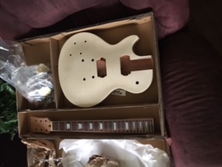

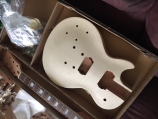

    Thanks Wokka, I thought that would be the case. I reckon I'll replace it with a bone nut and that will be a job that I complete somewhere at the end of the build. I have to add pics via my work computer so here are a couple for when I un-boxed it on Friday. looks like a kit guitar in a box!

    kit looks good Melkor. The images are too small to get any detail but looks like some nice flame maple

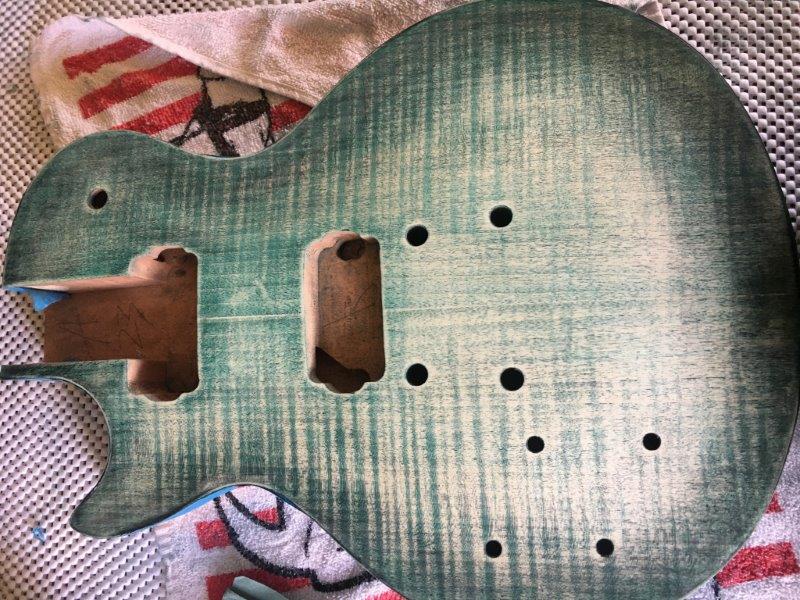

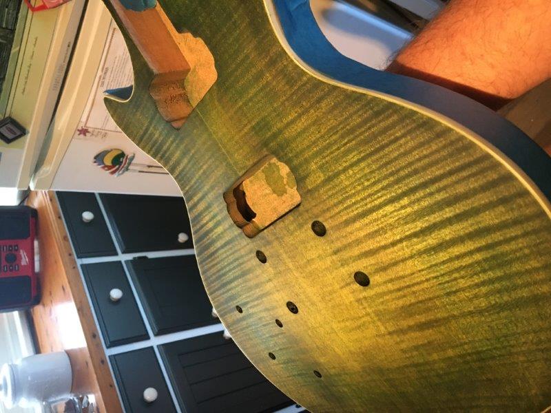

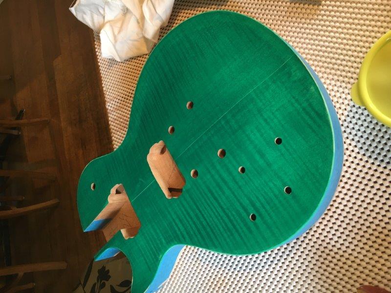

    Guitar staining process.
    After a number of botched processes I have finished doing the top of my guitar. Should have started with the black then the colour, but didn't which gave me no end of grief. finally settled with the last image, doesn't look too bad but it won't win GOTM.
    cheers, Melkor.
