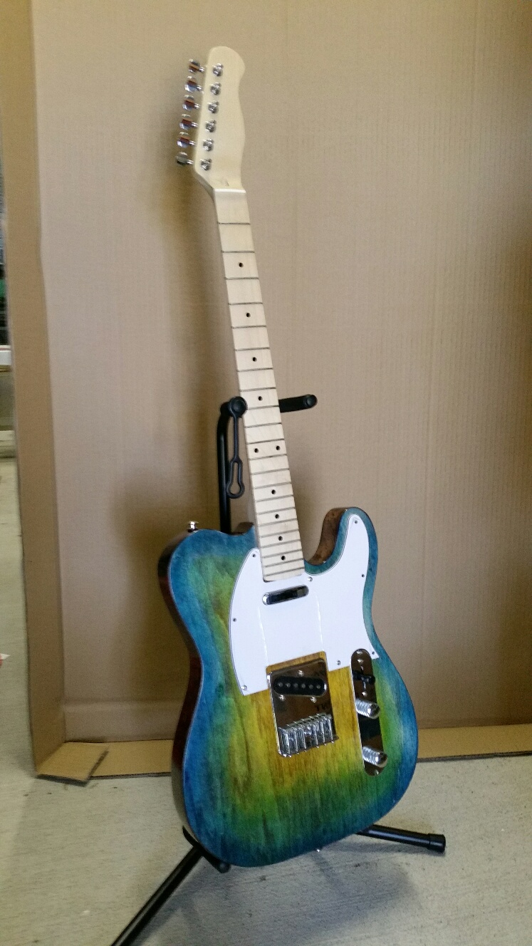

    Simply for reference here is a Tele body where I used Yellow and Blue Keda powder dyes over a sanded body that was once stained with professional Rosewood coloured furniture stain. The grain in the middle appears Red, and the Blue over the Rosewood on the edge gave me Purple, so in effect by using only three colours I sorta got a Rainbow....
