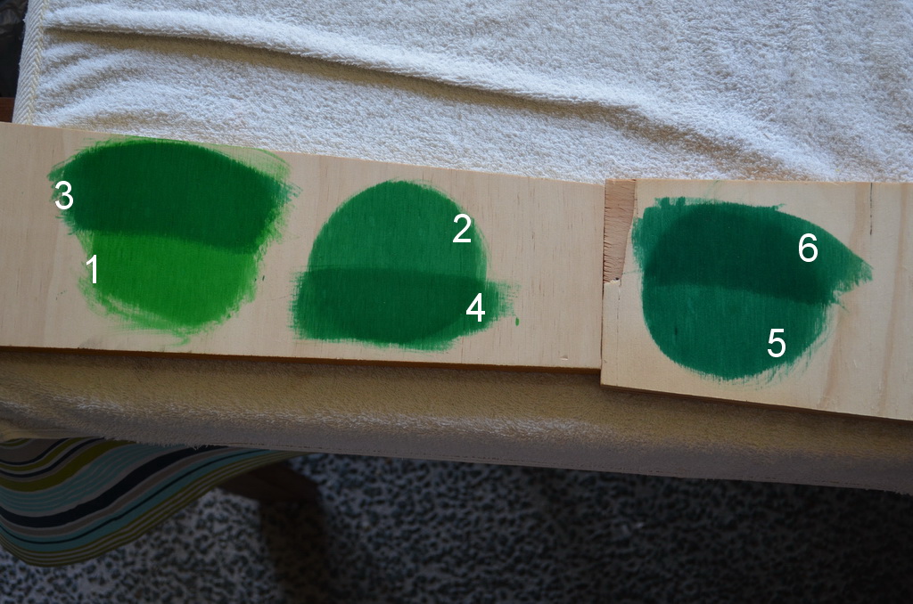

    Here's some mixes I made up with the green and blue pots:
    1 - Plain green, diluted 3:1
    2 - Green and blue 2:1, diluted 3:1
    3 - 1 with 2 second coat
    4 - 2 with 2 second coat
    5 - Green and blue 1:1, diluted 3:1
    6 - 5 with 5 second coat
    So I decided to go with number 5, green and blue 1:1 diluted 3:1. Applied with a rag.

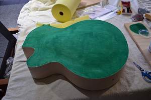

    So here's the result of one coat (sorta) on the back of the body:
    It's still wet in this photo, but looks rather patchy. The biggest problem was as soon as I touched the body with the rag, I could feel it pulling the grain up, felt bad, really bad. So I had to try do it in such a way as to try to minimise the grain being pulled up. Didn't have too much luck.
    And it seems if you go over it just a bit, it immediately gets darker where you previously applied and overlap with where you're currently applying. So I was also trying to minimise that effect.
    So not real happy with it as this point. Just checked it again, it has been about an hour, so it's reasonably dry. Still looks like shit. Damn. Lots of grain raised I prepped how the guide said - sanded up to 400, wet it with a sponge in water, which didn't raise too much, sanded it down again with 320 and 400.
    I need to come up with a better way of applying it.

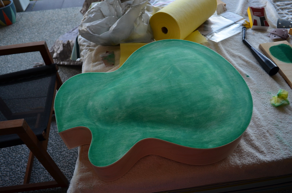

    But, application has been difficult. After sanding the back with 400:

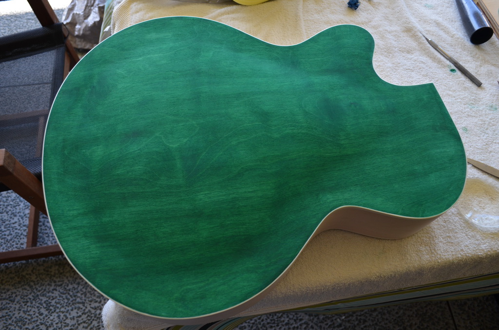

    So it wasn't in very deep, as it became quite patchy in places. But it was nice and smooth. So I tried a second coat, this time with a different rag with finer weave. Immediately could feel the grain lifting again. Grrr. Swapped to a wide soft two-dollar-shop brush, and did two more coats (after letting dry overnight in between):
    Not what you'd call perfect, but I was happy with the result - not happy as in "I did a great job", but happy as in "I doubt it will get any better unless I sand it all off and start again". Hmm. I guess at that point I figured it didn't look too bad (but changed my mind later on after I'd done the top).

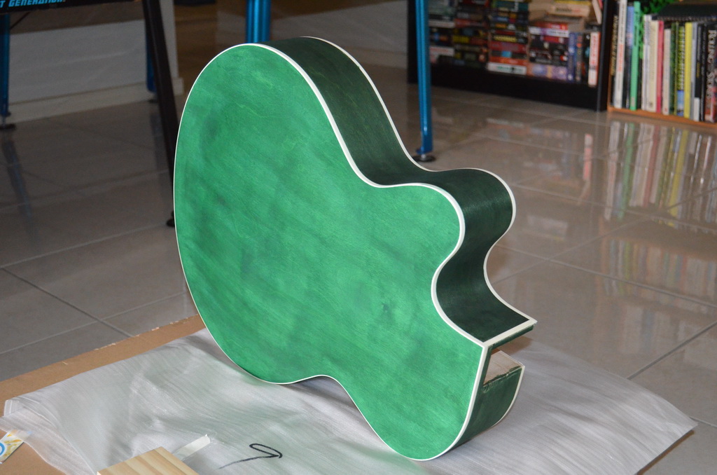

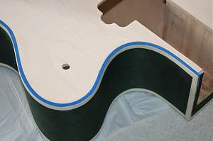

    I wanted to do a different colour on the sides, so used a mix of the green black ink with green in 2:1. Used the brush from the start, and by this time I'd developed a technique to minimise the visible brush strokes. Doesn't look too bad:
ID:	21881 Click image for larger version.

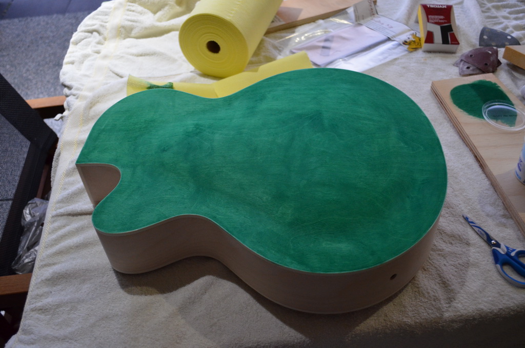

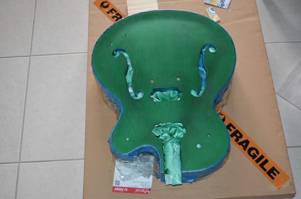

    At this point, I didn't want a similar streaky effect on the top as is on the back, so decided I would spray the top with my airbrush. The top is probably the worst for the grain raising. Even after sanding perfectly smooth, a few hours later or overnight, it's very rough again. Anyway, masked up what'd already been done, and proceeded to spray (Aztec A470 with yellow (large coverage) nozzle):
    Once dry, looks reasonable. Still tossing up whether to do another coat, so leaving the masking in place for the moment. Will take another photo once the masking is off. It looks lighter on the arched part due to the flash, it's not really like that in reality. But now I realise how shitty the back looks.
