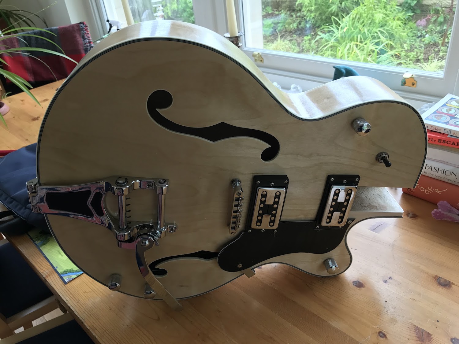

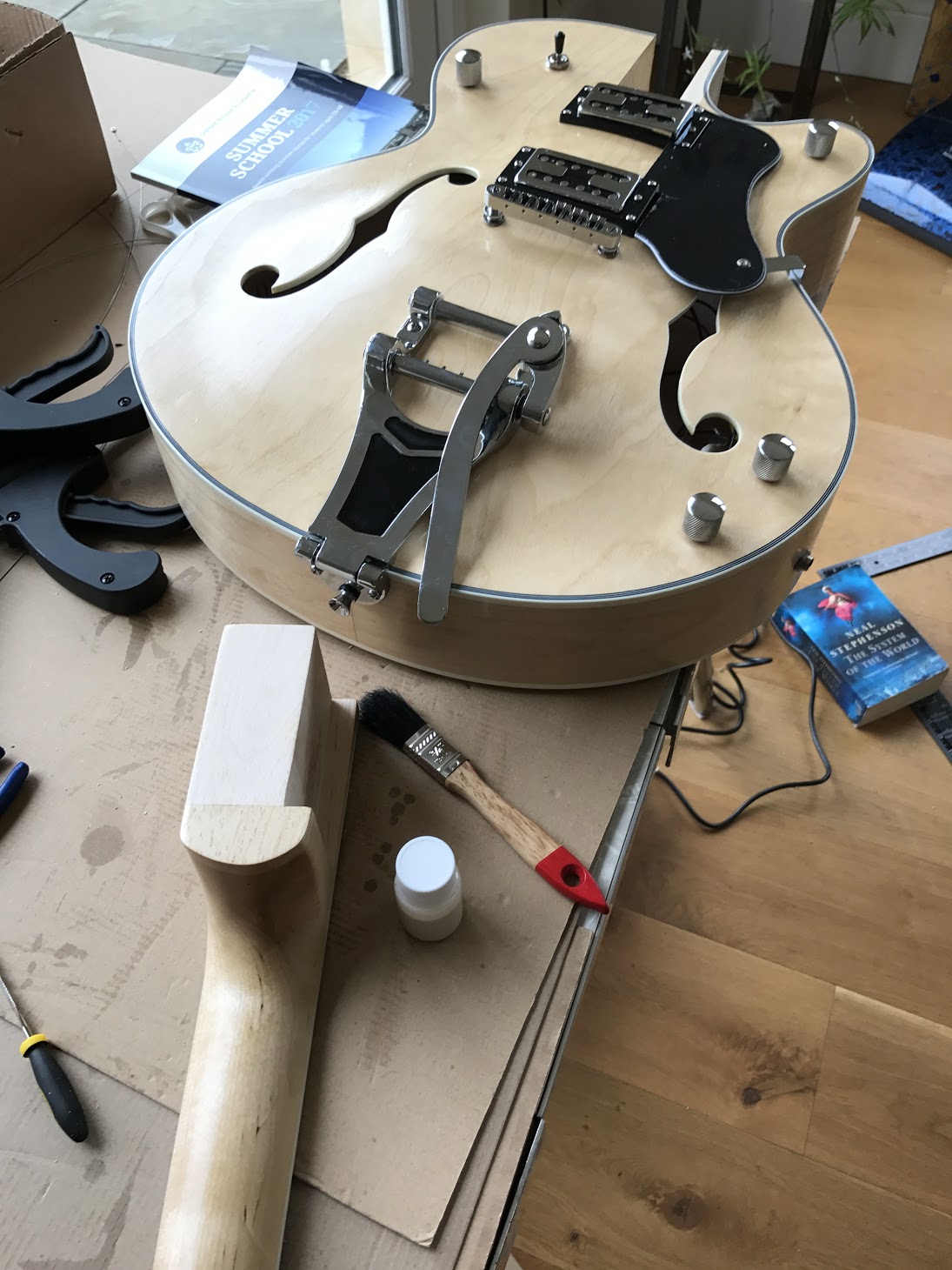

    A flurry of activity today. I was happy with the results of four coats on the body, so I've assembled the whole thing.

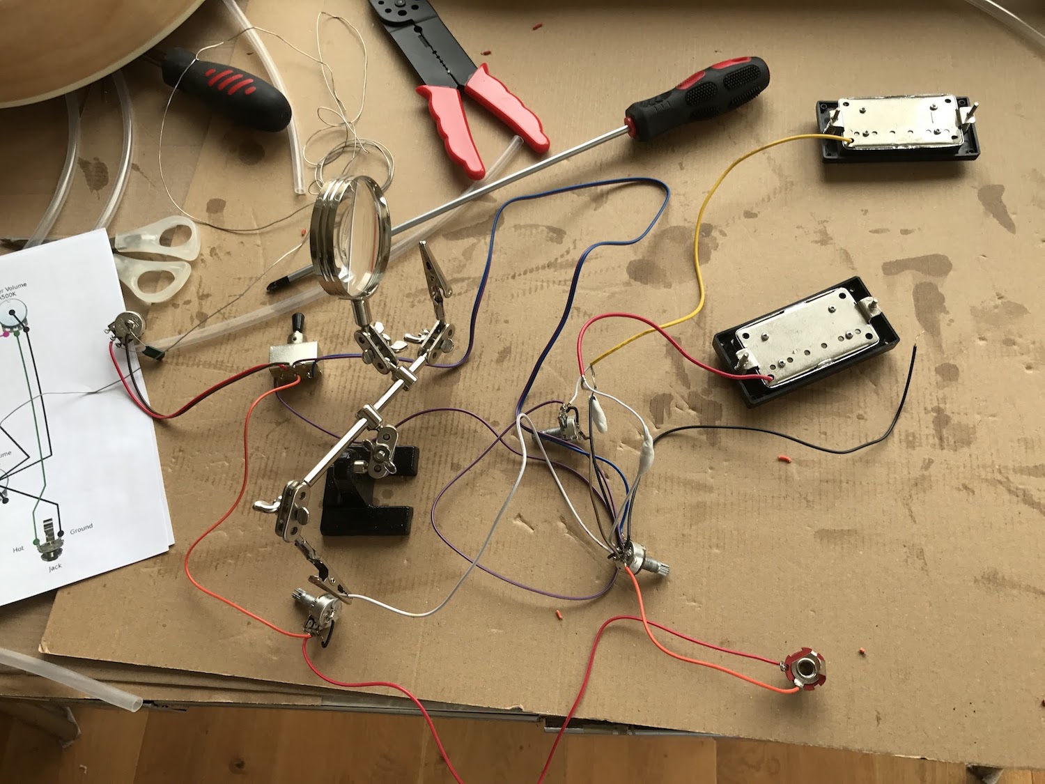

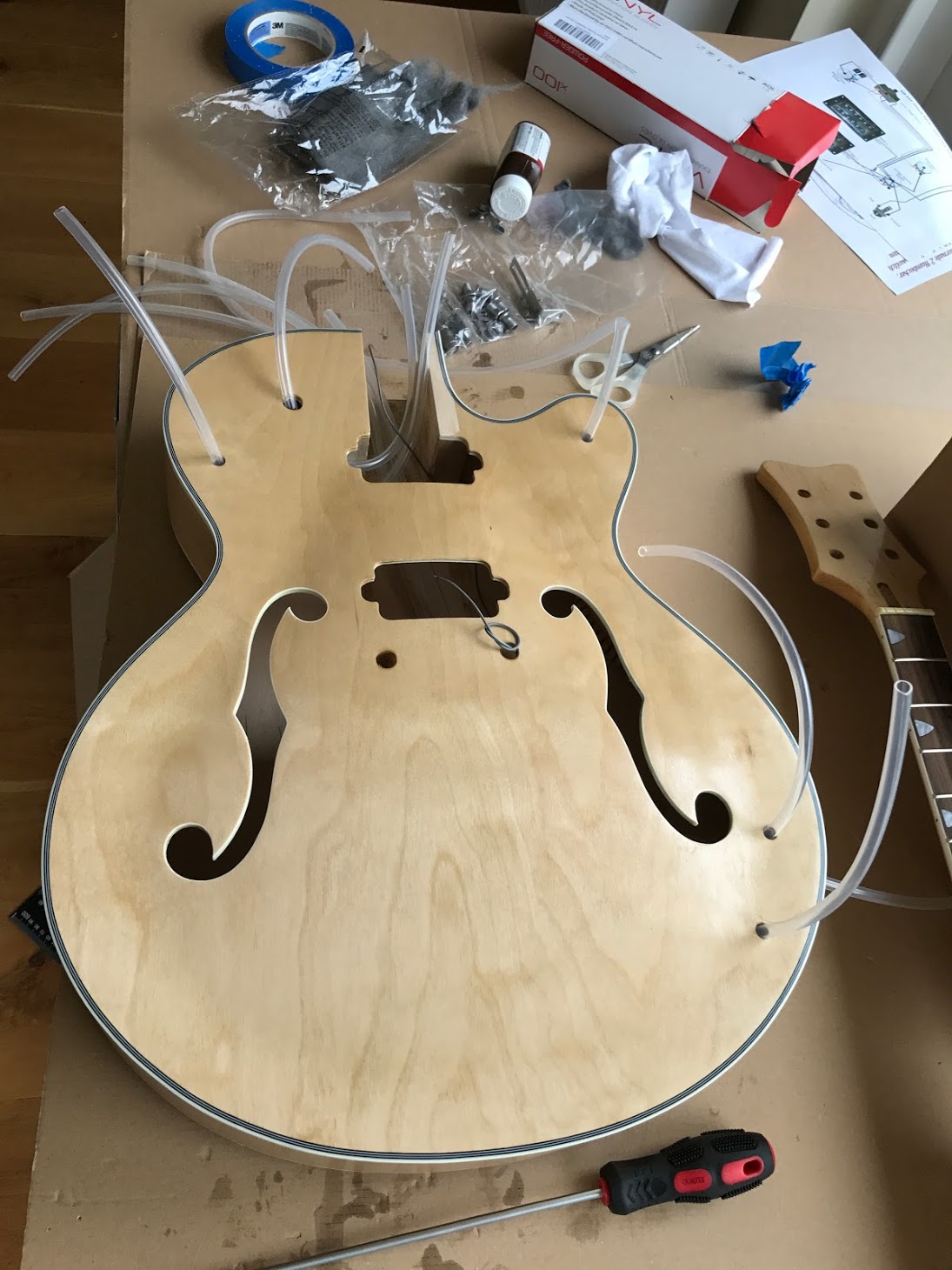

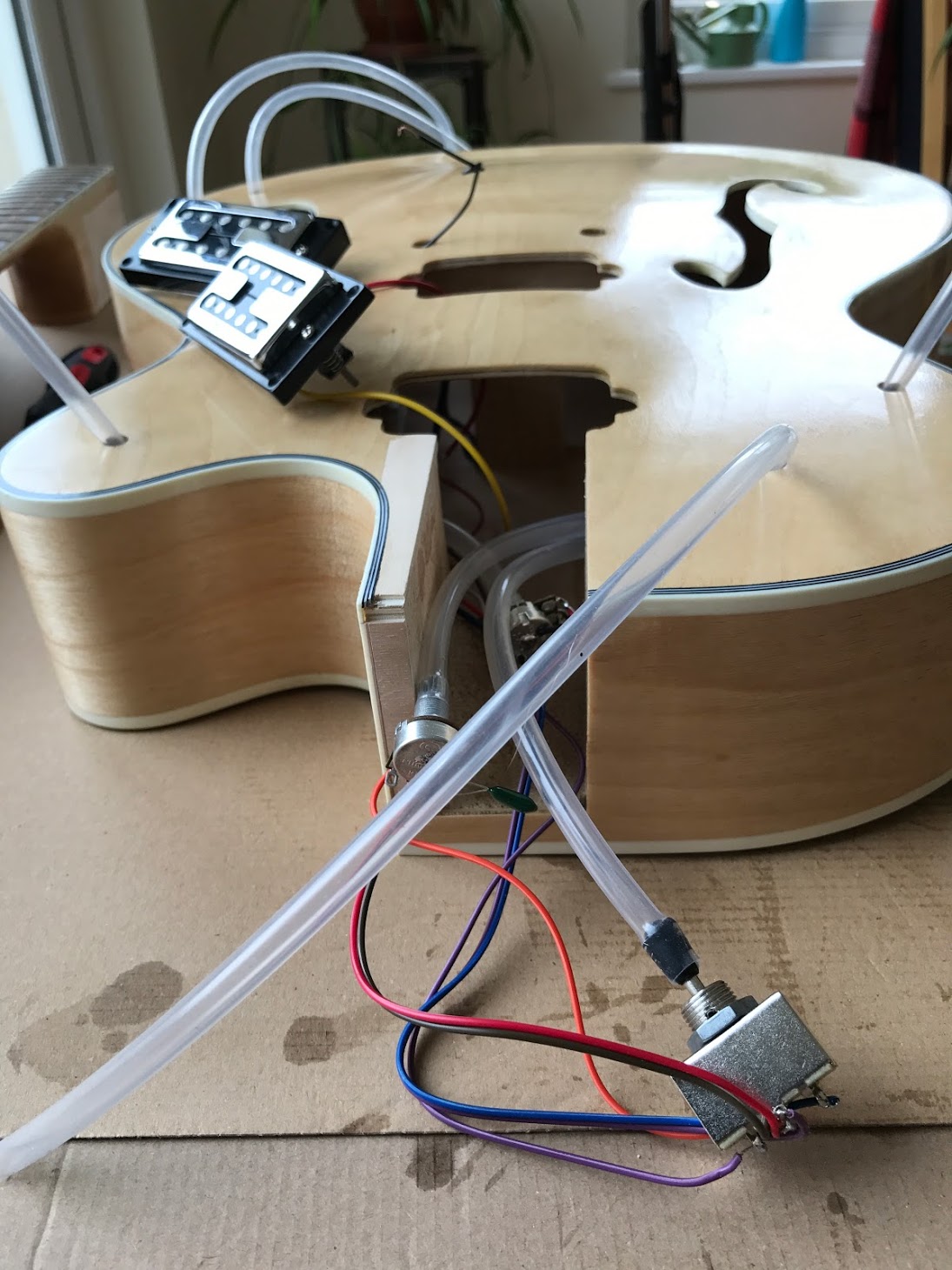

    Preparing the tube approach to installing the loom. A bit like building a ship in a bottle:

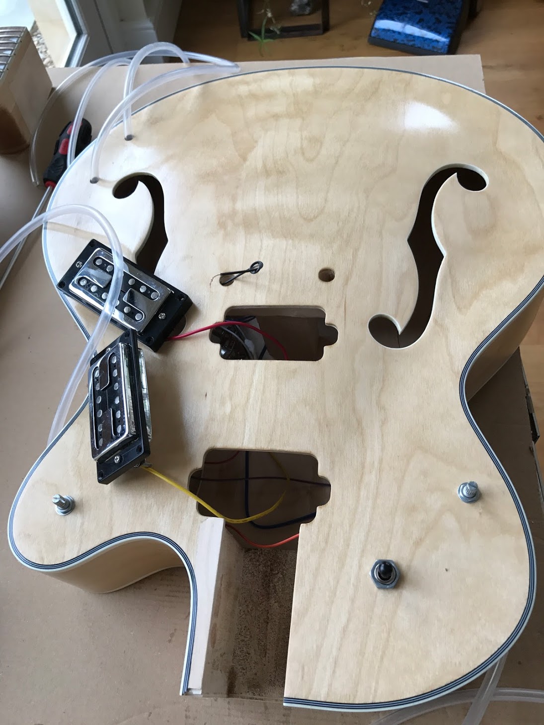

    Half of the loom in place:
    Nothing like pulling a loom through a small hole to show you your weak solder joints. Had to take time to re-solder four wires.
    And starting again -

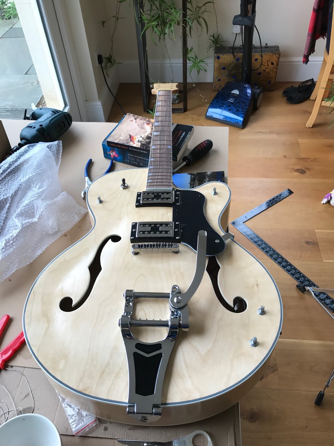

    Success with the 2nd try on the loom, so on to attaching the hardware:

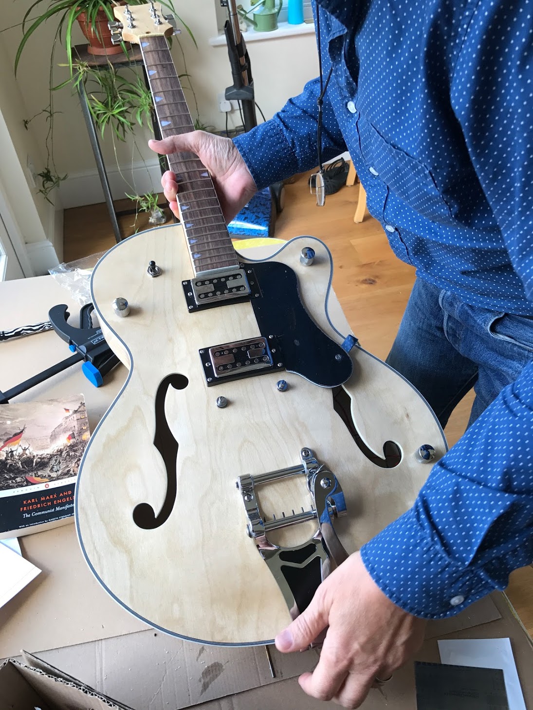

    Hardware attached and ready for the neck:

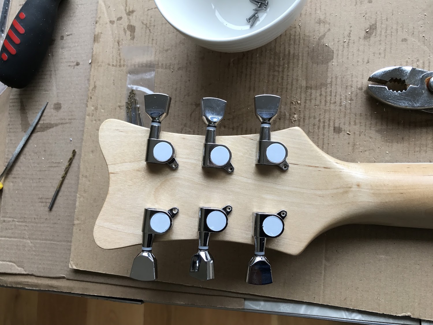

    Attaching the machine heads:

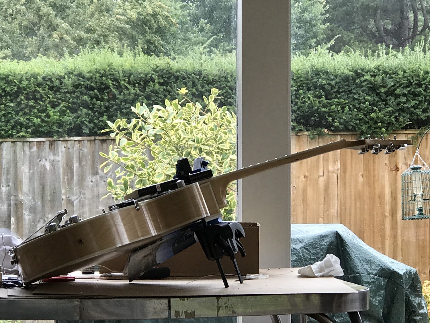

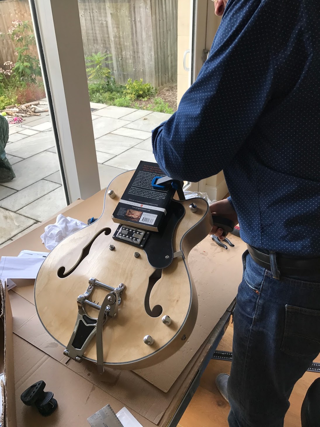

    Gluing the neck (I used the controversial "put glue on both pieces" approach:

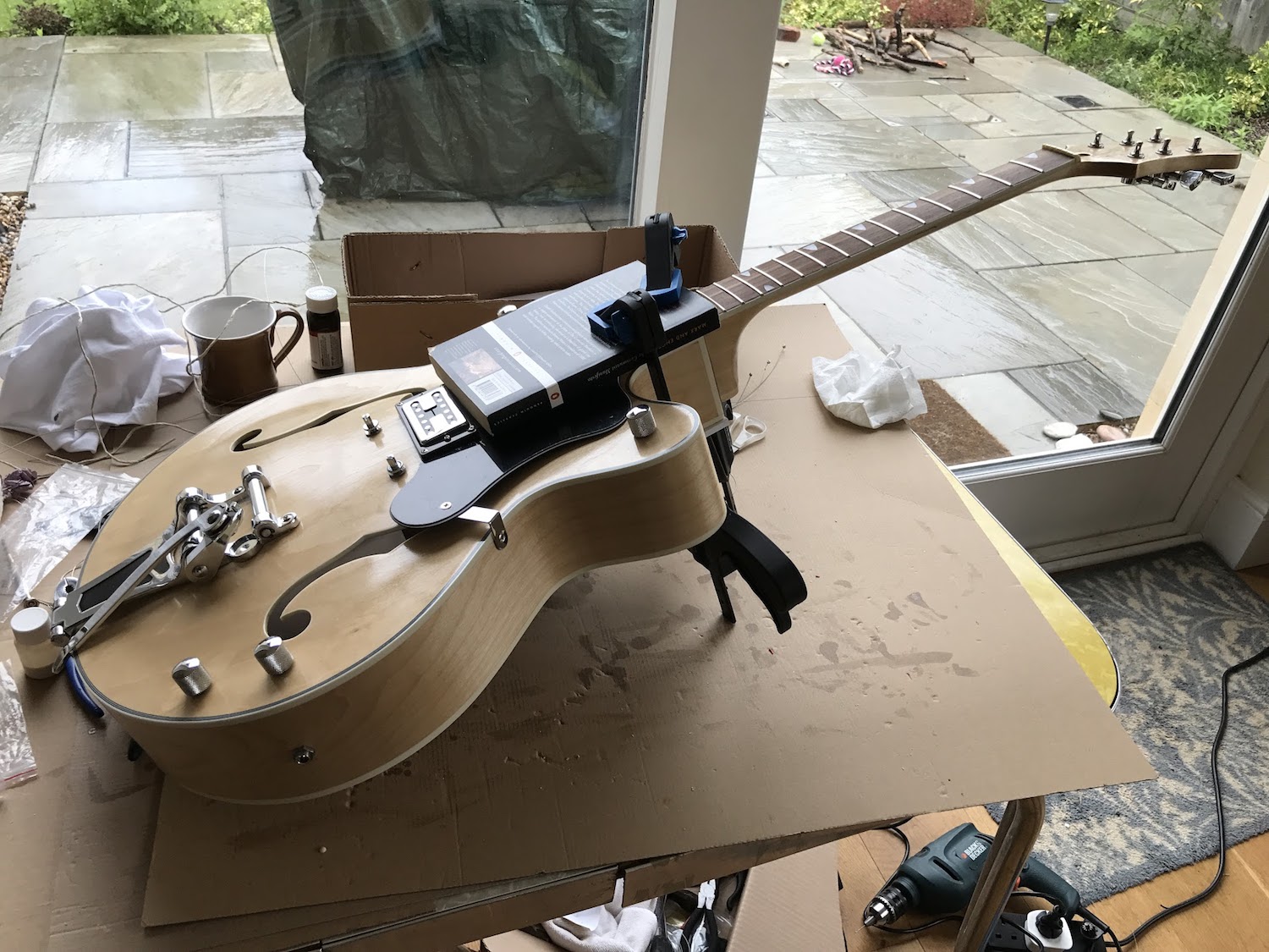

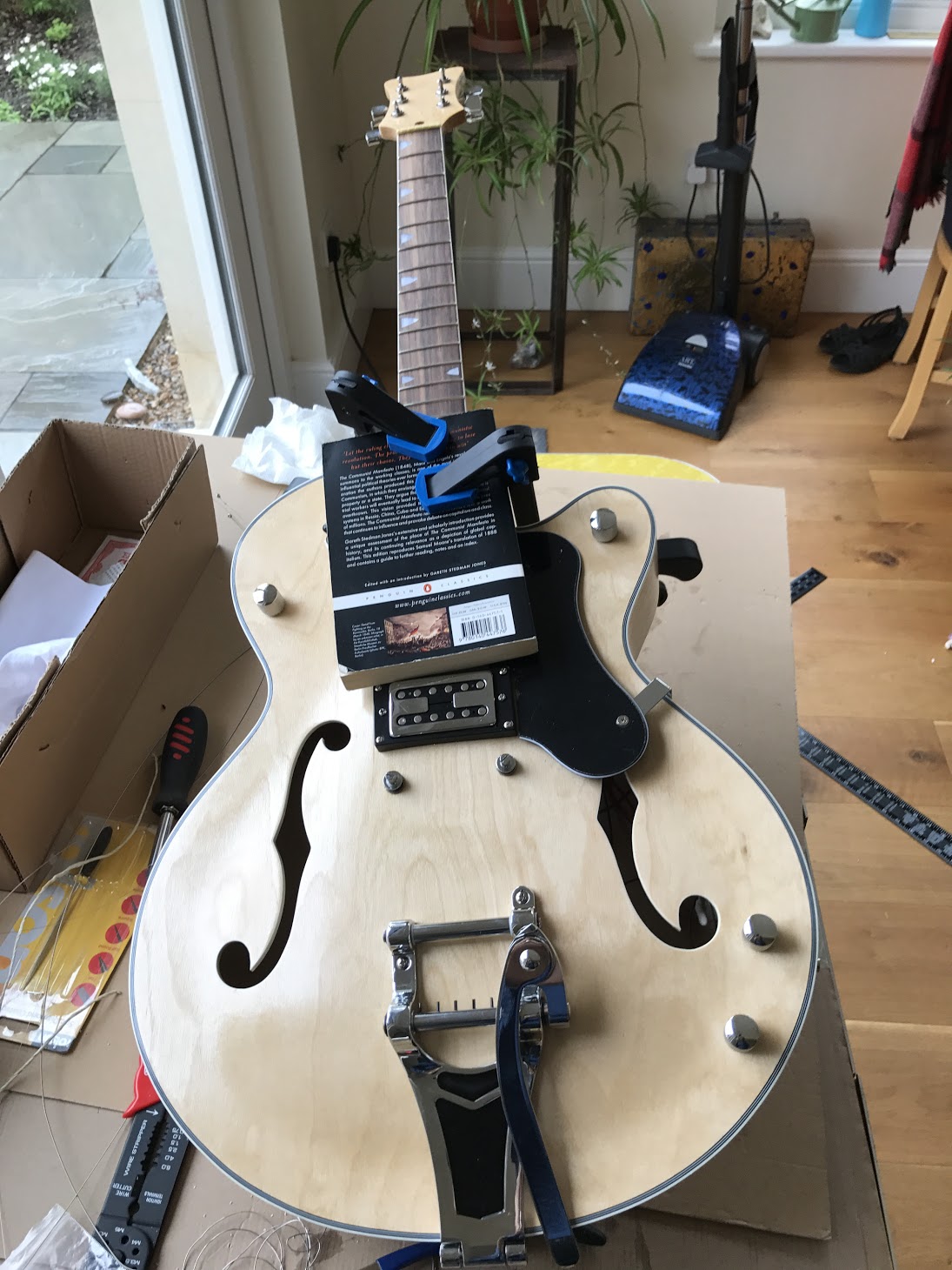

    Glued, clamped, and if the fates are willing, I'll have a playable guitar in 24 hours:

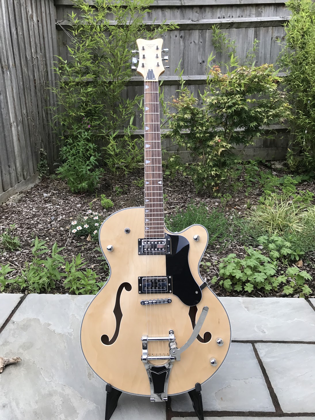

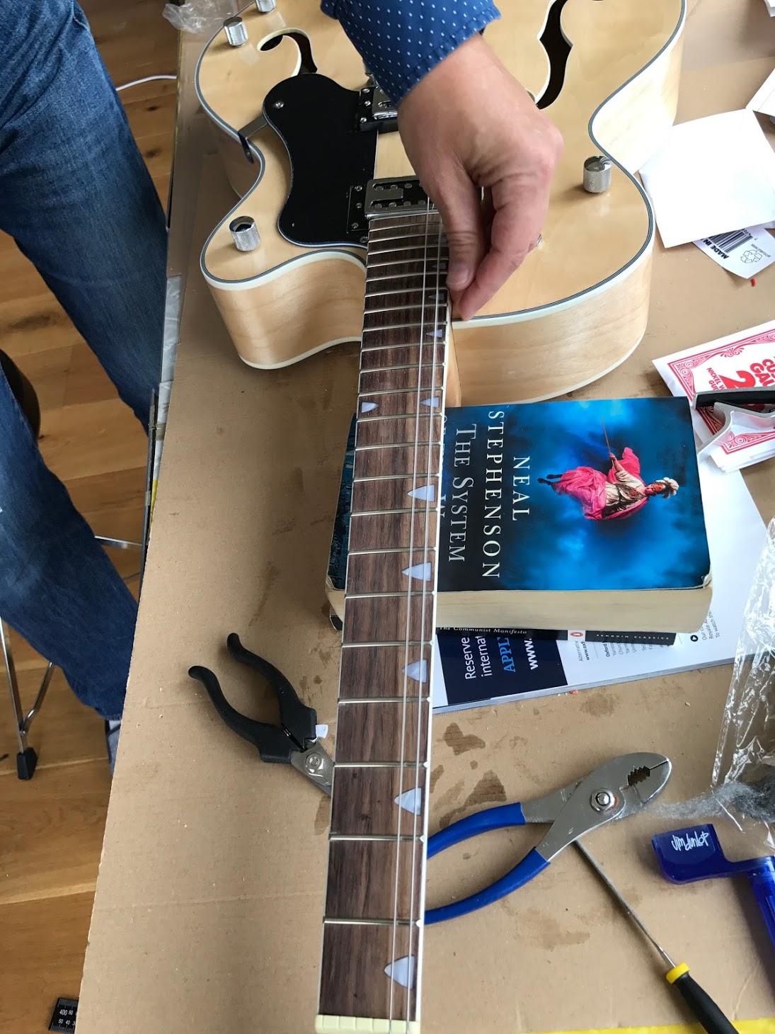

    And it's done! It was pretty easy to intonate, the neck and frets aren't too bad. The action is way too high - it plays more like an acoustic at the moment. I've "flossed" the slots in the nut a bit, but I'm not going to spend too much time on that because I plan to replace it with a bone nut. Does anyone have any recommendations for a source in the UK? Also what type of nut should I be looking for?
    I was pleasantly surprised by the sound of the pickups - they're much better than I expected.
    I'll post a video soundcheck soon - just have to figure out what I want to play.
    Removing the clamps:
    It didn't fall apart!
    Stringing it:

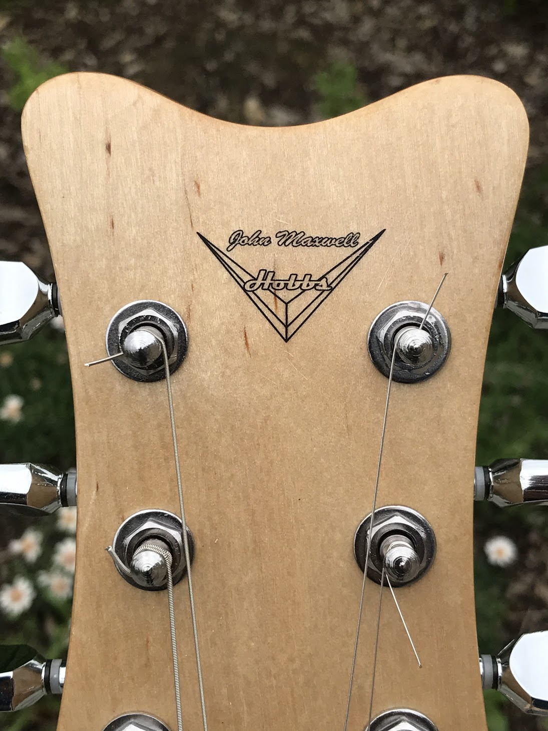

    My logo decal
    The finished guitar:
