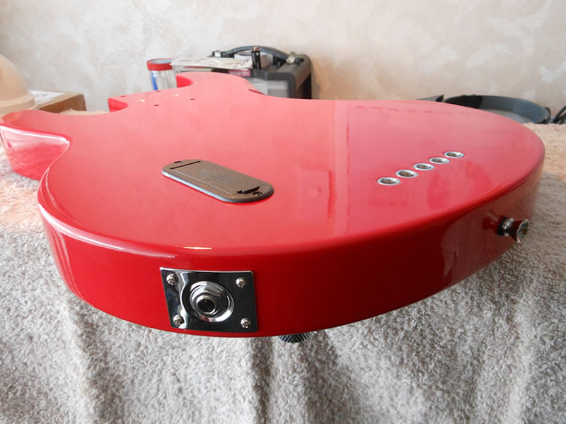

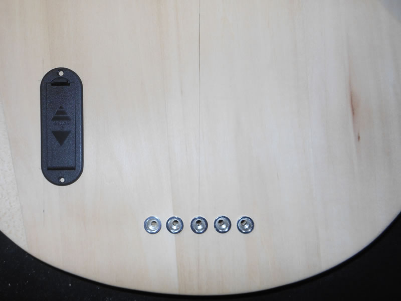

    On the task list today is:
    • Routing the hole for the battery compartment
    • Drilling the hole for the output jack
    • Modifying the PUP compartment so the PUP can be mounted in the optimum position for the MM tone. (And match the position dictated by the replacement Stingray 5 scratch plate)
    As the battery compartment was a deep rout (over 25mm) and needed to be tackled in 5mm increments so not to overload the battery router, I made a little jig that was clamped to the body.

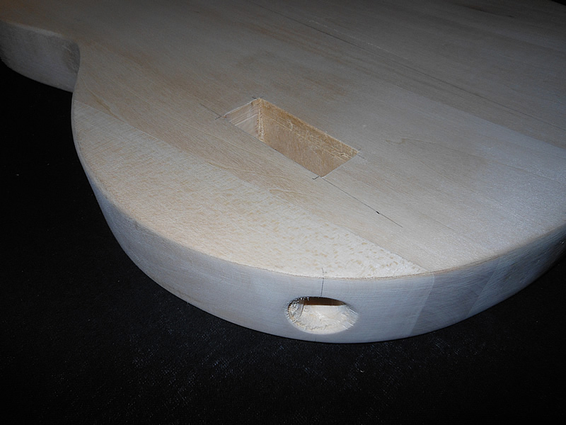

    Next was drilling the hole for the output jack; this was being moved to the edge of the body as the position on the control plate where it would normally be will be occupied by the treble control of the two band EQ.
    I bored a shallow 22mm diam hole (spade bit) first to allow for the convex shape of the mounting plate. Next was the 14mm hole for the body of the switched socket.
ID:	21436   Click image for larger version.
ID:	21437   Click image for larger version.
ID:	21438   Click image for larger version.

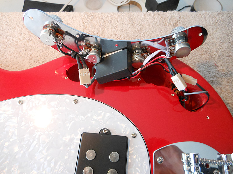

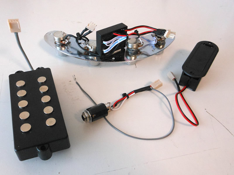

    Day four: electronics, final pre-finishing fit.
    Fitting the preamp in to the control cavity was always going to be tricky, so I decided to take the MM approach and mount everything on the back of the control plate and use high grade connectors to plug everything together. This necessitated a little notching of the original control cavity to fit the preamp block, and cable holes opened up to suit the connector sizes.
    Photo of the control plate shows wiring configuration for individual volume controls for each PUP coil in parallel, however I intend to experiment with a push/pull parallel series switched pot later.
    This is another benefit of the removable “plug n play” control plate; modifications are really easy.
    With all this working, it was time to finish the last of the installation of parts, assemble everything for the final fit and test before commencing the sanding and finishing process.
    First was the drilling of the bridge plate to accommodate the thru body stringing. The 4.5mm holes were transferred through the body on the drill press and then the 9.5mm holes for the ferrules were drilled in from the back. I will use a press to push these in after the painting is complete.
ID:	21609   Click image for larger version.
ID:	21610   Click image for larger version.
ID:	21611   Click image for larger version.
ID:	21612   Click image for larger version.
