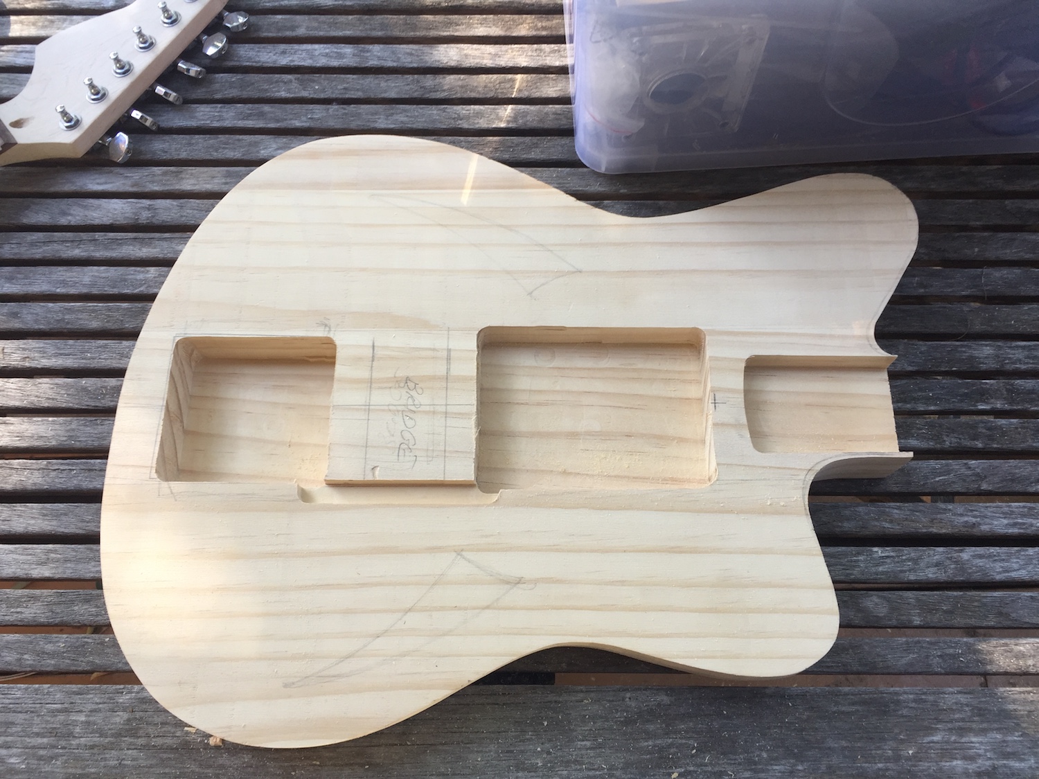

    I'm not quite as silent as FrankenWashie on his build, but I am somewhat obscure about where I'm heading! Initial routing done, might be more to come...

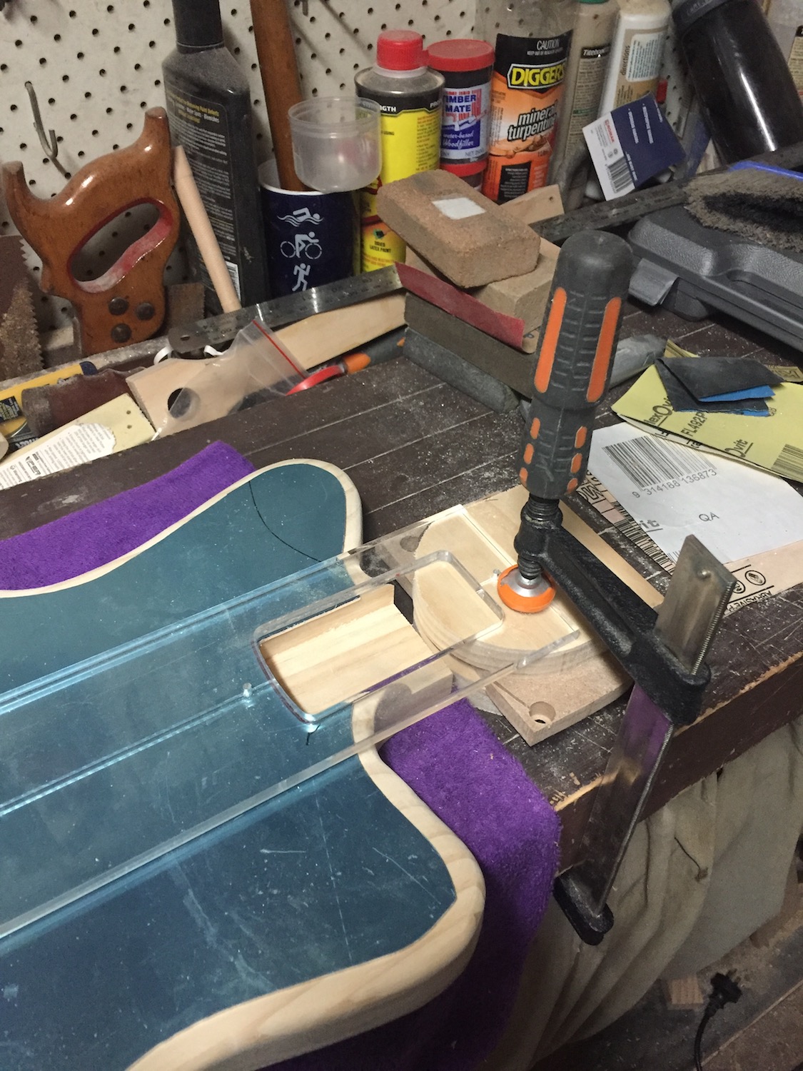

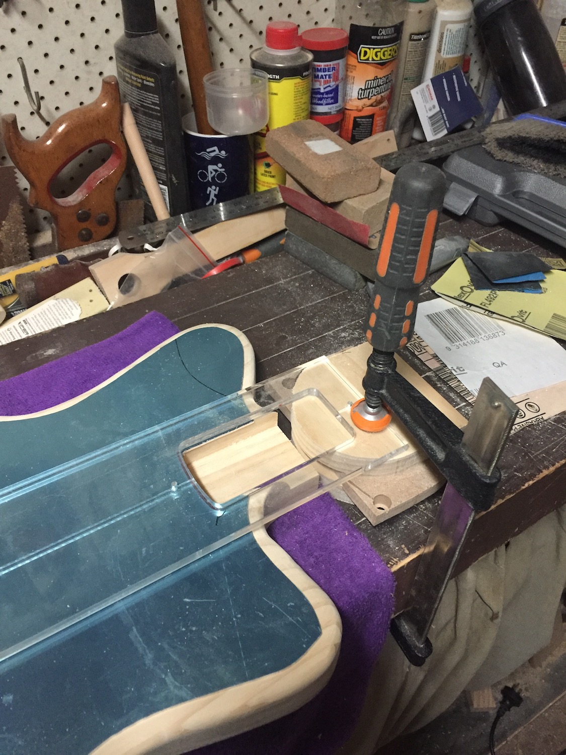

    Of course the neck pocket was going to be an issue and with not as much margin for error I wasn't sure what to do... until coming up with this solution: clamping the neck pocket template about 5mm above the body, eyeballing it to as close as I could for alignment accuracy, then sliding in the pickguard and tracing the inside of the template.
Name:	020817 neck pocket jig.JPG
    And it actually worked quite well. I cut a mm or two inside the lines so there will be some fine tuning in the pocket, and there's also plenty of room to make the overall outline smoother. All in all, quite happy with where it's heading...

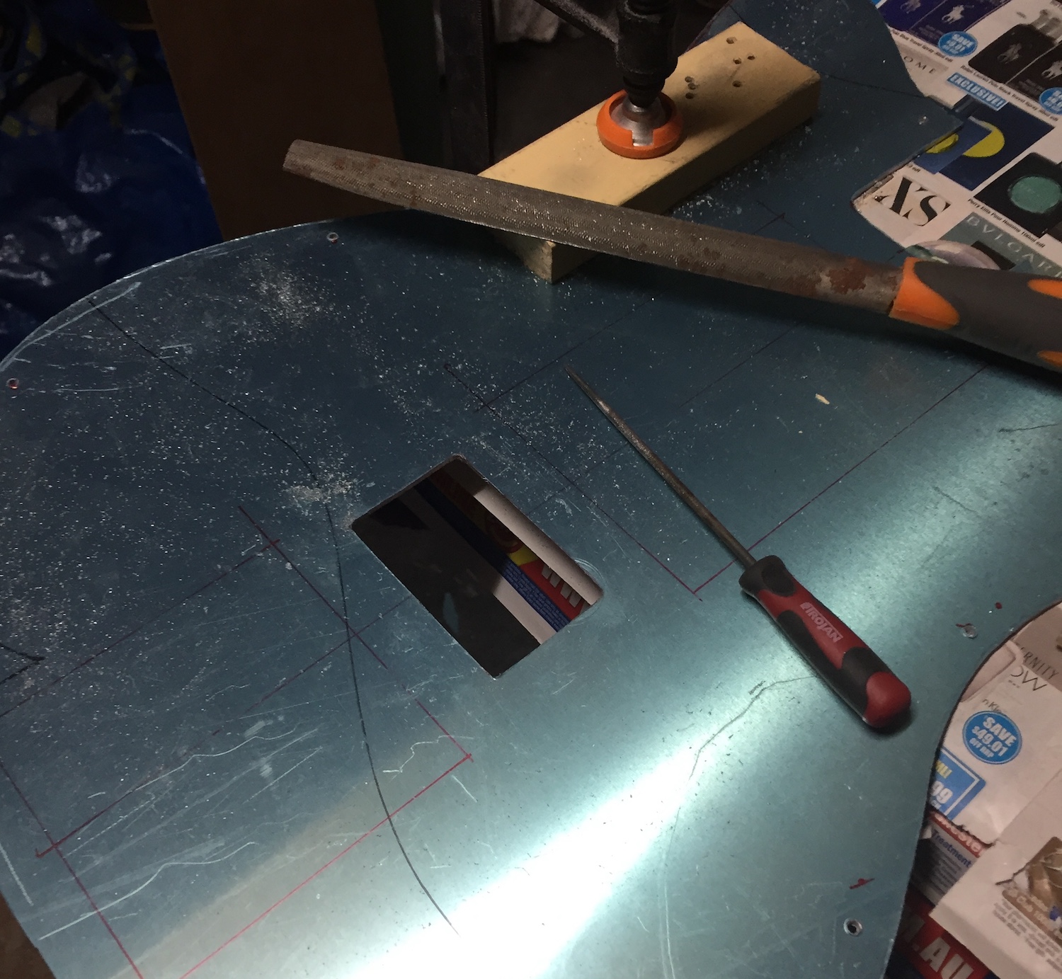

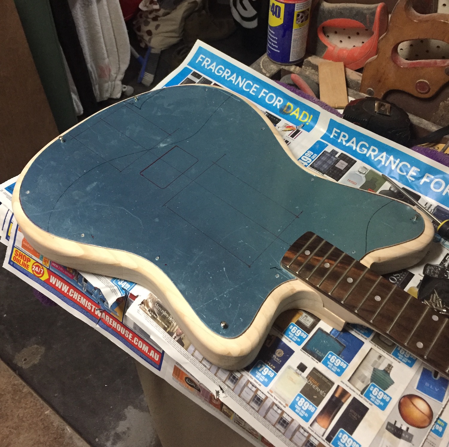

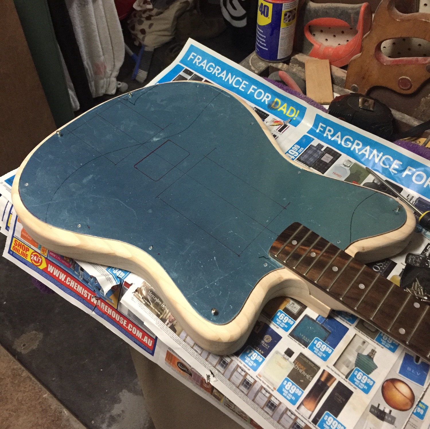

    Some baby steps here as I try to work out what I'm doing. It's a bit back to front, but before finishing the body I decided to mark the bridge location on the scratchplate. This required some fine tuning of the alloy to get it in position, then tacked in place with a couple of the pickguard screws. Next all the measuring (with the neck in place) to establish the location then trace the hardtail bridge.
Name:	240817 Bridge position.JPG
    Then drill a hole in it to get the jigsaw blade in, do a rough cutout, then plenty of work with files and I now have a bridge hole!
Name:	240817 Bridge cutout.JPG
    I "think" the next step will be to do the pickup and control cutouts, and once all that is done I can get back to finishing the body... I may need to fine tune the body routing to accommodate stuff but we'll see.
  10. #20
    good work Chuck. Sometimes you have to work backwards with the pickguard dictating where all the hardware goes, so you got no choice. You cut a nice bridge hole, if I was on the jigsaw it would probably be a pentagon shape with lots of swearing coming out of the workshop haha
    I would do that as you have planned, cut out the pickup and control holes next, then you can work out a routing plan which should be done before you start sanding the body.
