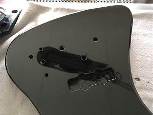

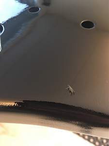

    There were some issues with my finish that I decided to correct. I sprayed over the area that I had worked on and then this happened. Now I have a dead fly stuck in my wet clear and 20 hours of waiting before I can sand it away. At least he went quick.

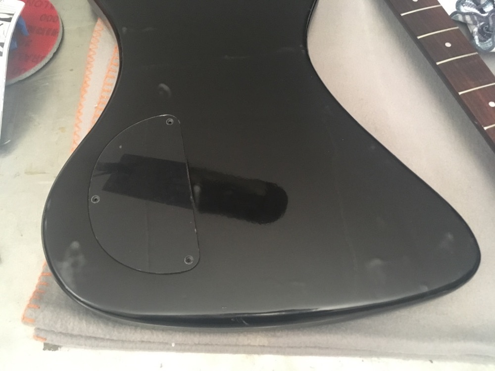

    Thanks for your kind words. The fly will always be a part of this bass. The spot where the fly met its demise is still visible under the new coat. I used a bit of solvent to remove it and some must have remained. In direct spot lighting you can see some bubbles. Life has gotten in the way lately, but I finally had some time this weekend. Went ahead with sanding, buffing and polishing.
    This is the result on the front, I am pretty happy with it and it is as good as my level of skill will get it. For the sanding I used an overpowered random orbital sander with 2000, 3000 and 4000 foam pads. For the buffing and polishing I also used a orbital sander with two different pads and compounds. Not the best idea as the sander has a way too high RPM, but it is what I had. The buffing compound suggested 800 RPM, the sander works at 12,000 RPM (unloaded). Up close in direct lighting you can see lots of small circular cuts. I call it Pre-Relicing™.

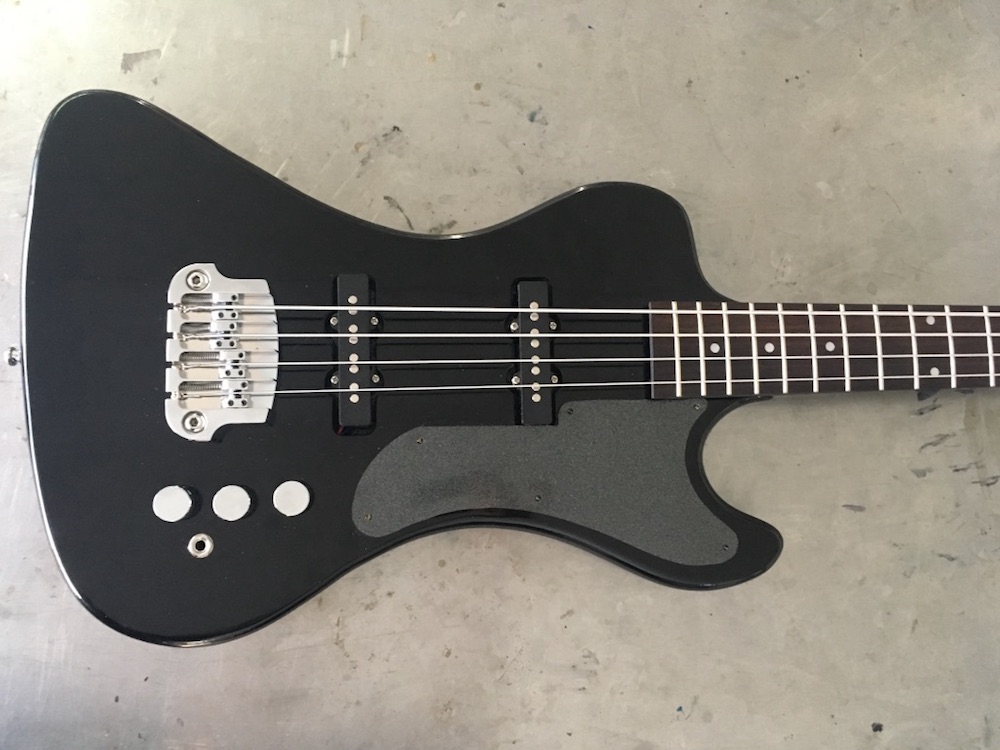

    And there we are. Making a pickguard shaped like the original proved to be way beyond me. But hey, it sparkles and that is good enough for me. Maybe I'll try again someday.
    There is some selective noise and hum here and there, not sure if it is faulty soldering or lack of proper shielding.
    As far as playability goes, it is mostly good. I am still getting my head around this whole setup and adjusting thing.
