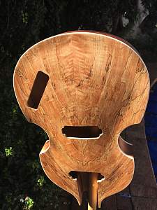

    No not going with the traditional Hofner look . My thinking is as follows: go with a silver/metal and wood look -so ditch and replace all plastic bits with wood or metal. Sides and back stain dark / mahogany / rosewood / dark oak - this to contrast the binding. The top a very very light stain. But possibly then will wait until I've done the sides and then make the decision on whether to apply stain to the top.
    Finally got the neck fitting and aligned correctly and ready to move to the next step.

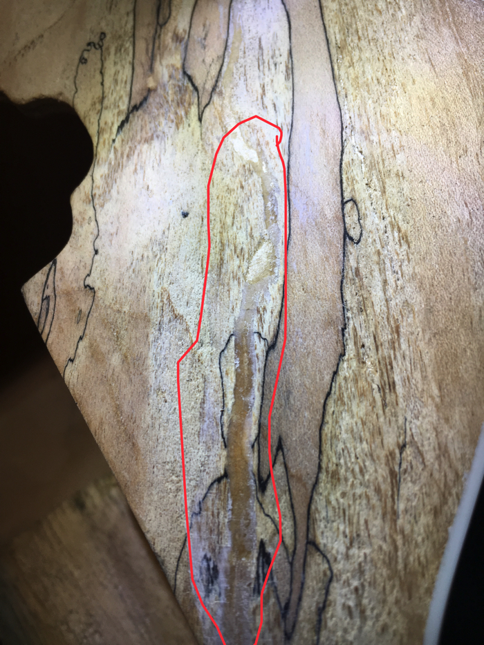

    So in the process of checking for glue spots I found this: Click image for larger version.
ID:	20902 It appears that a crack in the veneer is filled with CA glue, this is the largest, there are one or two other much smaller ones. Removing it is not an option without micro surgery, awesome skill and magical fillers. I assume the very light stain I was going to apply is not going to take on these spots? Also wondering how it will look with the application of the tru oil and if the oil will form a protective layer over it?
  6. #15
    Hi Michael, Tru Oil should do a good job of blending if not hiding that glue or filler section shown in previous photo. It will also make that spalted top come to life.
    Just a heads up with Basswood and dark stains.....if you have sanded past 180, it probably won't take much colour, particularly on end grain and you may need to sand it back with 120 to open things up a bit. Check out a recent build on a thinline Tele with Bondi Blue to see what I am talking about - I think it is Robbo's and shows evidence of overpolished timber and lack of stain penetration. Sometimes the basswood is so shiny straight out of the box that not much more work needs to be done except on edges to knock off the machine marks from where the body has been cut from the original blank.

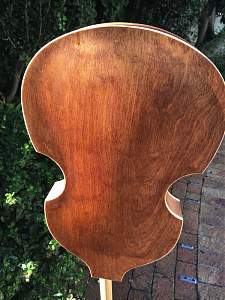

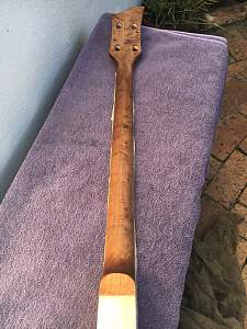

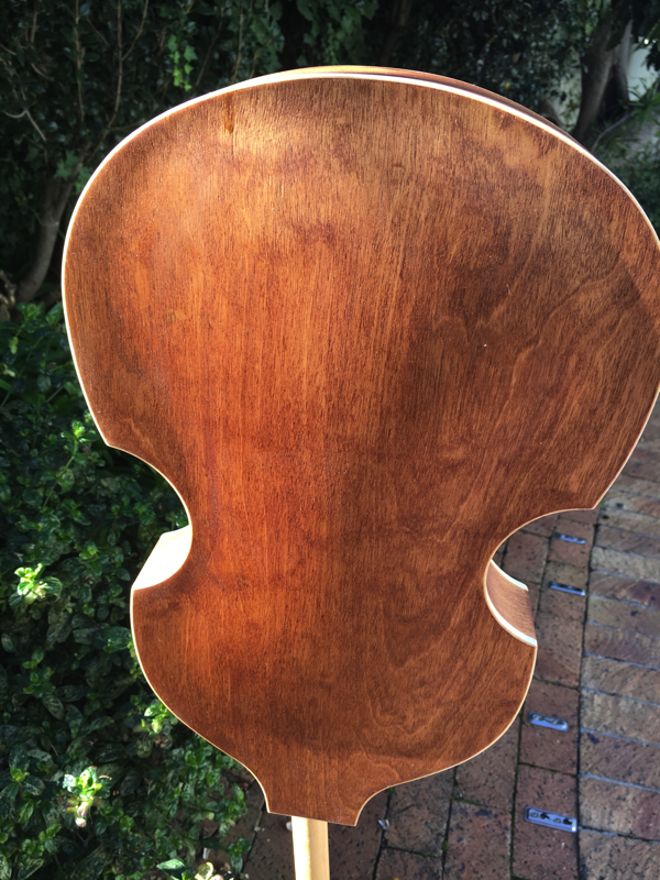

    Progress
    Stained, neck, sides and back. 2 coats of tru oil so far.
    2 coats of shellac to front. Waiting 24 hours at least before starting with tru oil.
    There have a number of lessons learnt already. Mainly around going slow, and rechecking... (even though I think I am being meticulous) taped up the binding which took forever and still got lots of bleed from the spirit based stain. among a list of stain mistakes, scratches missed etc etc.
    Planning to coat with oil twice a day with oil until the layers build up. Light wipe with 400 grit every couple of layers. Will see how I go as layers progress.
    Also now beginning to work on making pick up surrounds, truss rod cover and control cover from pieces of walnut I managed to scrounge.
    Onward and upward.Click image for larger version.
