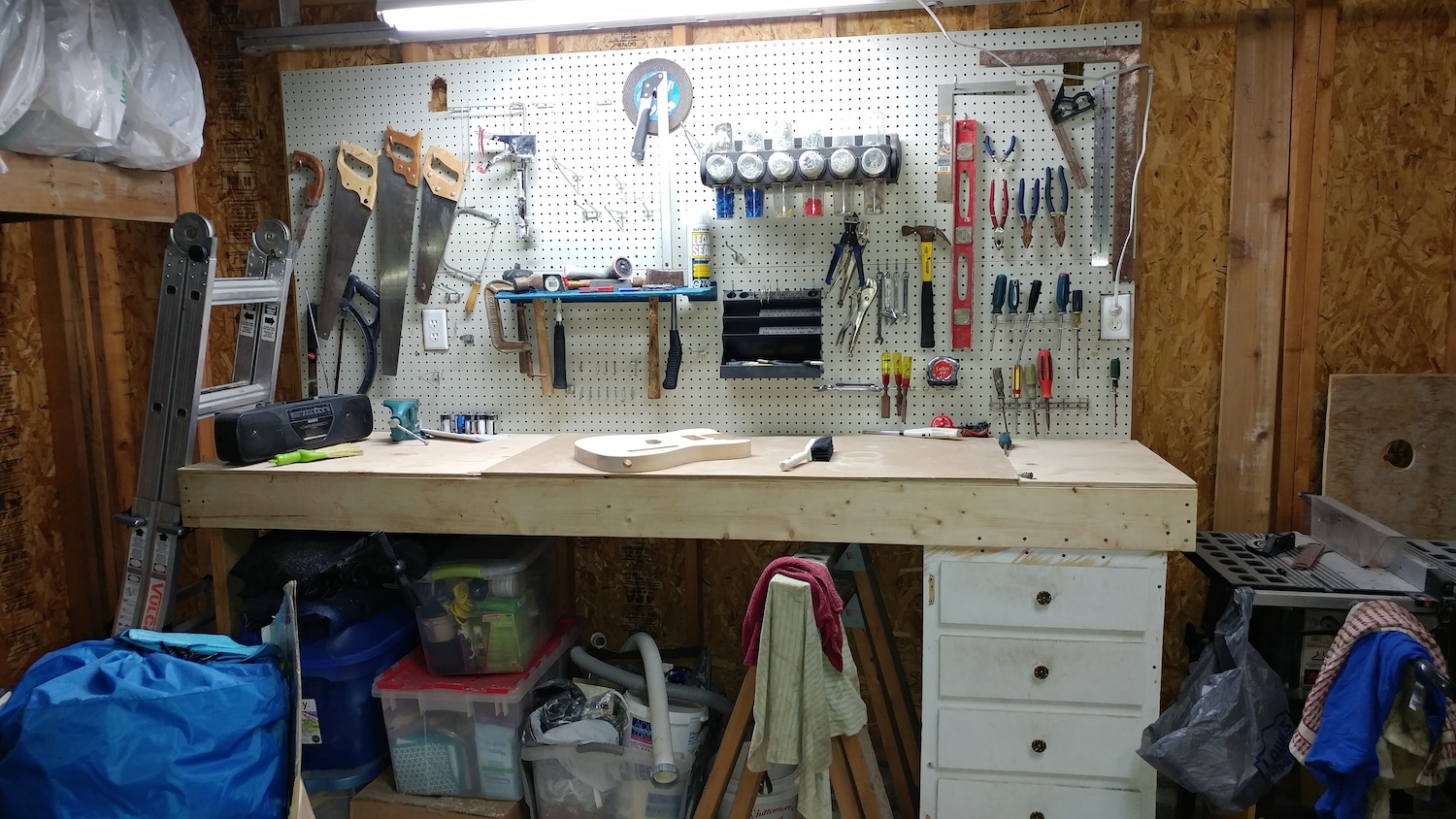

    okay...pics of the bench....Click image for larger version.
ID:	20675 and Tele Click image for larger version.
    Keep in mind, I'm no carpenter. This is a pretty simple bench. I do plan on installing a vice somehow to hold the neck and body while I work. The drawers were re-purposed from an old kitchen cabinet, and I already had the peg board. I've installed 2 new outlets on either side of the bench, and the work light above.

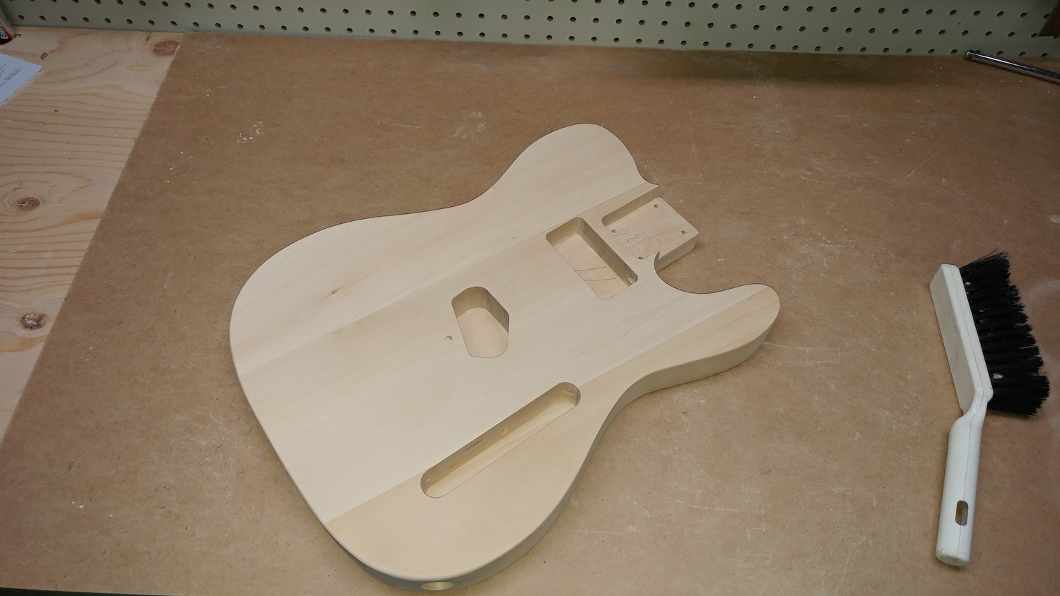

    So my question is, how do I know when I've finished sanding? I do have a small amount of experience with wood, and the surface feels uniform, and quite smooth to the touch. I've given a couple of passes with an orbital sander with 120 grit, 3 passes with 220, and hand sanded with 400. Then went back to 220 because the edges of the top and back felt a bit rougher than the rest. Tonight, I'll give it another pass of 220 with the orbital, and then hand sand with the 400 again.

    Ah Sanding.
    If you are already at 220, i'd hold fire and wipe down with some Gum turpentine as this will highlight any wonky bits (Spindle sander marks, glue globs etc).
    I tend to sand manually (masochistic tendencies) using a length of timber that is flat, as wide or slightly wider than the body, with self stick paper adhered to it. For flat faced bodies like TL, ST, and SV style guitars even though it can feel uniform and flat, you might find once colour or finish goes on, it ain't as flat as you first thought. Better to iron that out before filling or colour goes on.
    once you gone over the whole body and you are satisfied that all your glue marks, sanding scrapes and other greeblies are sorted, move up the grades stopping once you've reached the finish level appropriate to what you're going to do e.g.:
    - Stains, stop at 220 or 240 grit else you may have issues getting good colour penetration.
    - Paint, after filling stop at about 600 grit and start your primer/undercoating.
    Please note, that this is just what I do, based on having read through a lot of other threads, and having taken advice from others who have executed some fantastic finishes. (i'm looking at you @Phrozin, @WazKelly, @WOkkaboy, @Dedman, @ZeroMick, @Andy40, @FredA & Others). I encourage you to pull up and read through as many threads as you can, as there is a plethora of advice out there in the builds, tips, techniques and tricks that folk won't remember but can really help.
    Hope this has assisted. Cheers,
    EDIT: Oh and that is a fantastic workspace. Nice Job!
