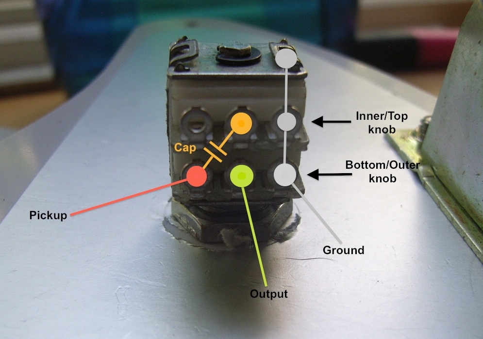

    Ok so have decided on a concentric pot for a bit more control over the sound, via advice from Weirdy, so now I just need a diagram to put it together. 1 last time Scott, I promise

    Set up so the volume is the outer knob, and tone is the inner:

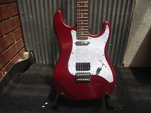

    So after what seems ages, am finally done, for nowClick image for larger version.
    Still needs a toggle switch. Many thanks to Weirdy for his wiring help

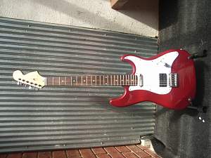

    A couple more shotsClick image for larger version.
