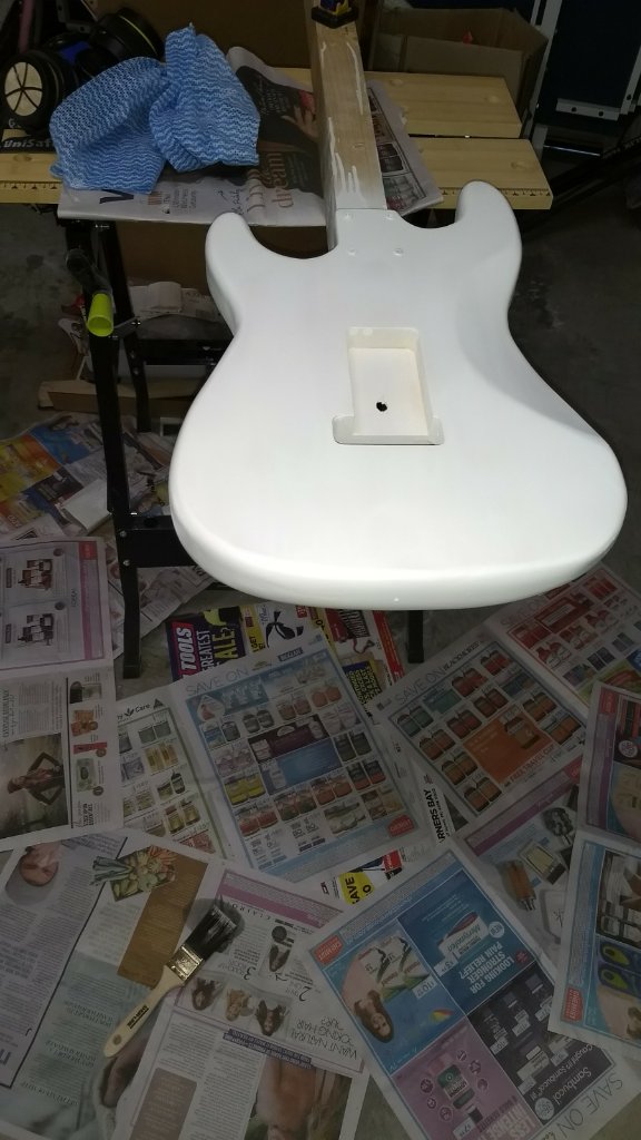

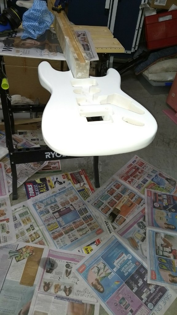

    Well. yesterday I purchased some primer. Here are the results.

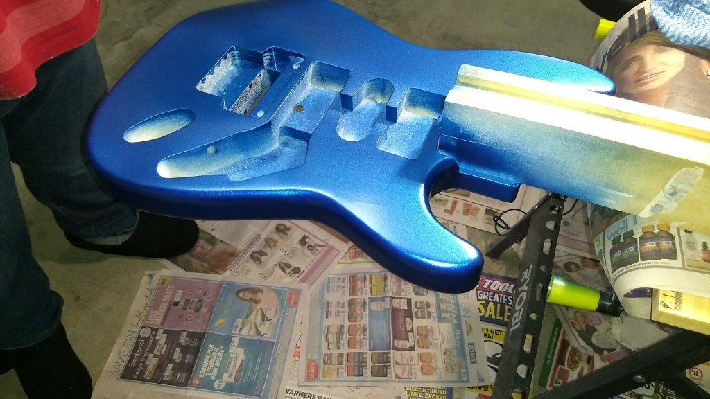

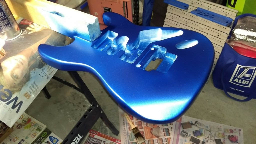

    Here are the results of the 1st coat.

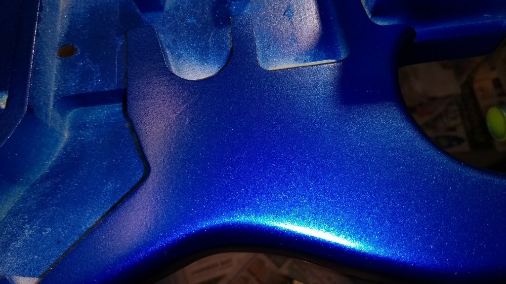

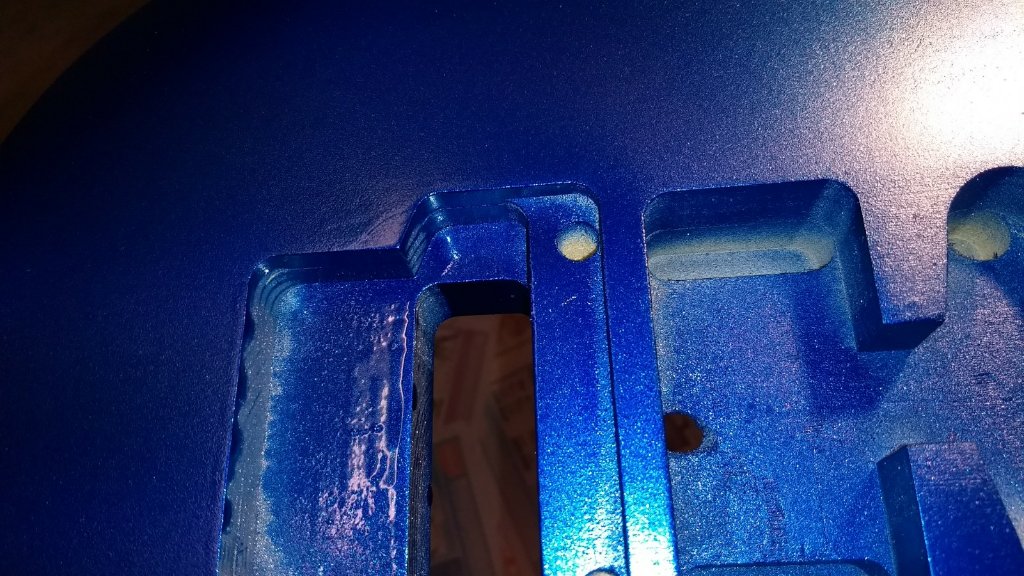

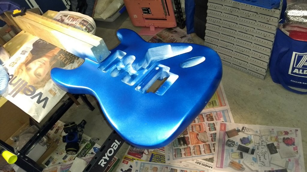

    After a 2nd coat, I noticed a few imperfections. Back to sanding tomorrow.
    Any recommendations on a Gloss Finish?

    Nice colour mate.
    Never done a solid spray so no first hand experience comments from me however it looks like a few more primer-sanding-primer stages may have been required before rushing in to do 1st coat of colour.
    Cheers, Waz
  6. #16
    Nice colour mate.
    Cheers, Waz
    I'd guess it would depend on the surface before the primer and the results after it.

    Quote Originally Posted by Hbg View Post
    I was looking at this one from Dulux
    H,the colour is looking amazing. the process is 2 or 3 primers, lotsa rubbing, 2nd coat, recheck for imperfections, lotsa rubbing, another primer, lots rubbing down, 2nd coat again, then if ok build up coats, light sanding between. When an all over uniform coat has been achieved, at least 4 or 5 top coats of clear, then final buffing. Yes that 2k dulux gloss is the go, JUST TEST IT ON A SAMPLE FIRST...

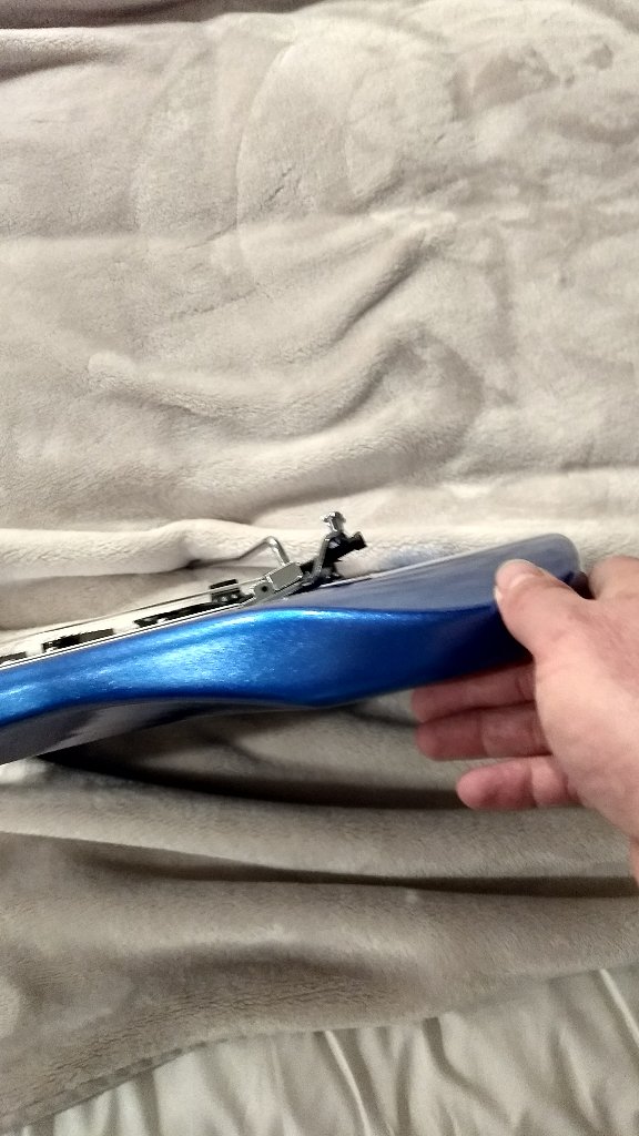

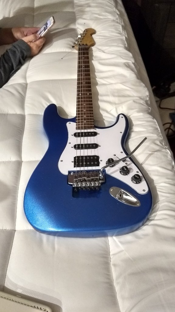

    Well, I finished assembling today. The 2 Pack came up really well. Only downer was a scratch that occurred when I was putting the Floyd Rose posts in. I put a dab of paint on there, but unfortunately the scratch plate wouldn't fully cover it. There is no hum at all, unlike some cheap guitars I have had in the past.
    I spent a few hours trying to get the action right, but still needs work.
    I need to adjust the input, as the lead is very rad to get in and out. I just need two small spanners.
    I will also order some Dingowax for my Fretboard, as I prefer the smoothness like the Maple on my Ibanez.

    Looking great.
    I'd give the guitar a few days to settle down first under tension. It's going to take a little while to reach equilibrium. First thing to do in any set-up is adjust the amount of neck bow, and until the neck's had a little while to find it's happy spot, it's really not worth doing that. And even that adjustment should be done slowly, no more than 1/4 turn at a time, and again, give it time to settle between adjustments (OK, if there's a lot of adjustment to make I'd go quite quickly but once you're in the right ballpark, then slowly does it).
  10. #20
    thats a great job. the blue looks amazing
