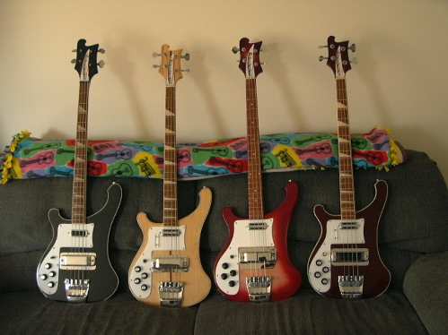

    It's the standard Rick LH bass neck arrangement. Here's a pic of four LH ricks
Name:	LH 4001s.jpg
    So it seems that Rickenbacker never bothered to build a dedicated LH neck for any of their basses, but simply used a RH neck and fitted a different nut and truss rod cover.
Name:	LH 4001s.jpg

    I've noticed that Ric does that for the LH basses, but it would still be cool if they did it the other way around, like a RH with a LH neck.

    who knows King Casey there may be a reason why Paul had a right handed neck on a lefty body. I noticed the did reverse the Rickenbacker engraving on the truss rod cover the correct orientation
    I read somewhere that Ric had never made a LH bass before Paul so they took a RH body, flipped it backwards, routed everything and put on the neck and turned that into a LH.
