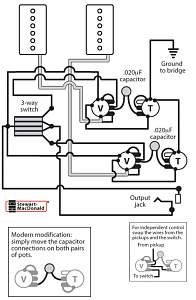

    Wiring question here:
    This is the diagram I'm using for the P90's. I want to try vintage style with independent controls in the middle position.
    Question is: Will this work using the main diagram and the smaller diagram in the bottom right corner? Not sure about the earth leads either.
    Suggestions, confirmations or outright laughter appreciated.

    It will work fine. You'll get a slightly different response to the way the volume turns down compared to the non-independent way, but at least you can have keep the selector switch in the middle and have one pickup turned off and still get a sound.
    Ground wires are a bit odd on the diagram (they are the ones shown connected to the back of the pots and three ground wires are shown connected to the ground tag on the selector switch). But they seem to be designed for as ES-330/335 style arrangement (rather than a Les Paul) where the controls and output jack are all in close proximity and you want to hide the wires from showing in the lower F-hole.
    However they do create a ground ring arrangement, which I'd always try and avoid. If it were me, I'd drop out one of the ground links - either between the backs of the two tone pots, or one of the links from the selector switch to a volume pot back. Whilst it's a very small circuit and probably won't make much difference, it's simply good noise reduction practice.
    Also, don't forget to shield the cavities as P-90s love picking up hum. I want to do a 330 style like this and will be looking for some metal covered pickups for extra noise reduction. A friend had a 1966 ES-330 with the metal covers, and he hardly gets any hum as a result.

    Thanks Simon for the response. Hope you are feeling better too mate BTW.
    I thought the earth circuits looked a bit odd too. I'm no electrician but my time as an automotive mechanic told me something wasn't kosher. My thought was to drop that tone connection too as it would disconnect the neck and bridge circuits, thus avoiding any 'cross contamination'. I've set up a template with some longer PUP wires to try it all first, so I think that will be the first test.
    I'm thinking that it doesn't matter where the bridge earth connects either, as on the actual kit, it's easier to connect to the switch earth. It's a shorter path and avoids the 'f holes'.
    I ordered the copper tape tonight. I'm shielding everything nowadays.
