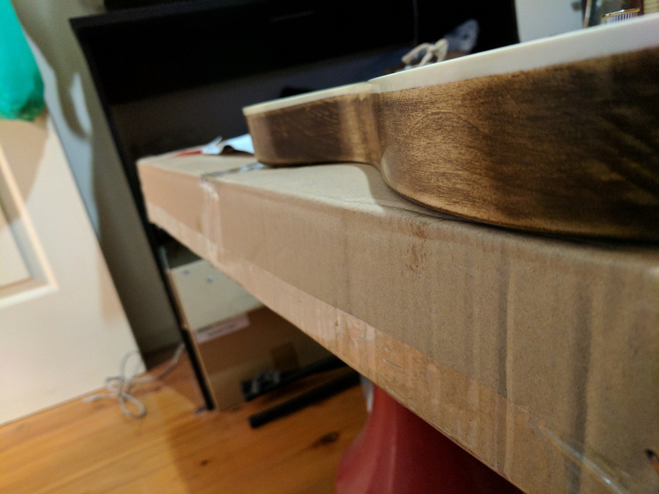

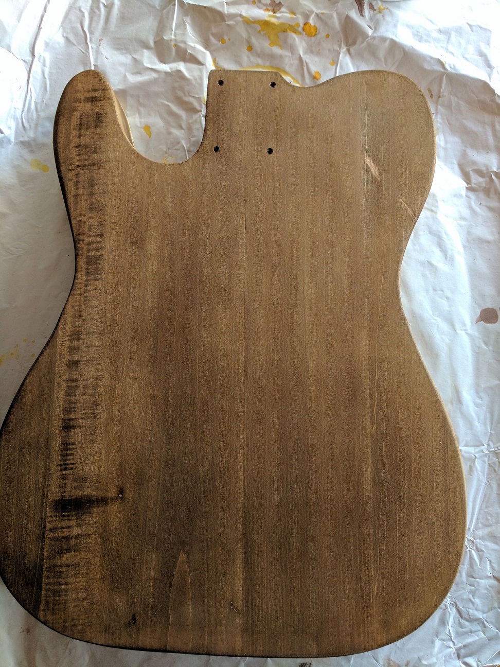

    Managed to get quite a lot done this week.

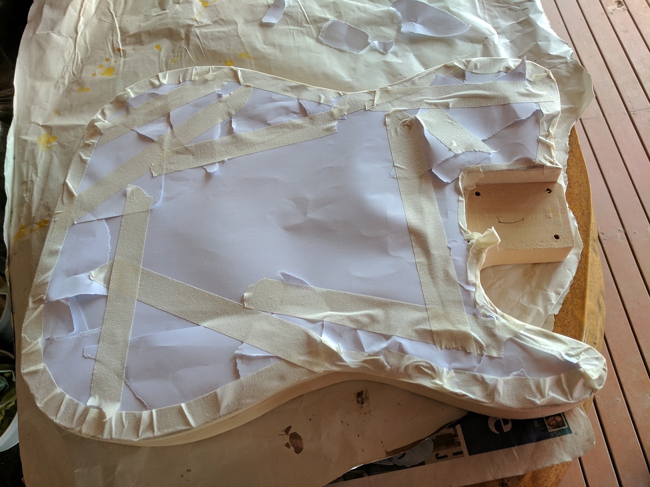

    Masking the binding and the front to get the back stained

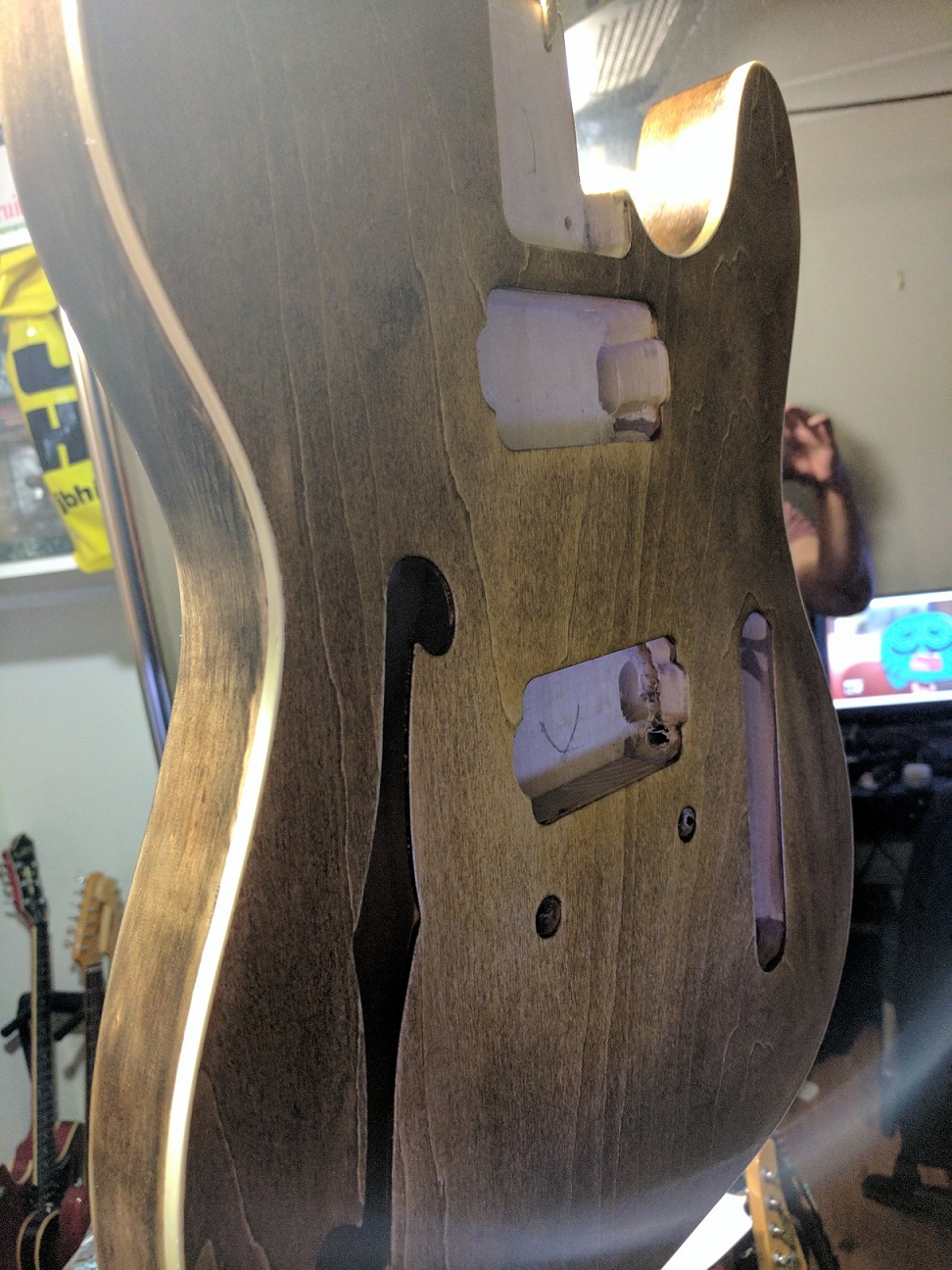

    Here it is after the stain

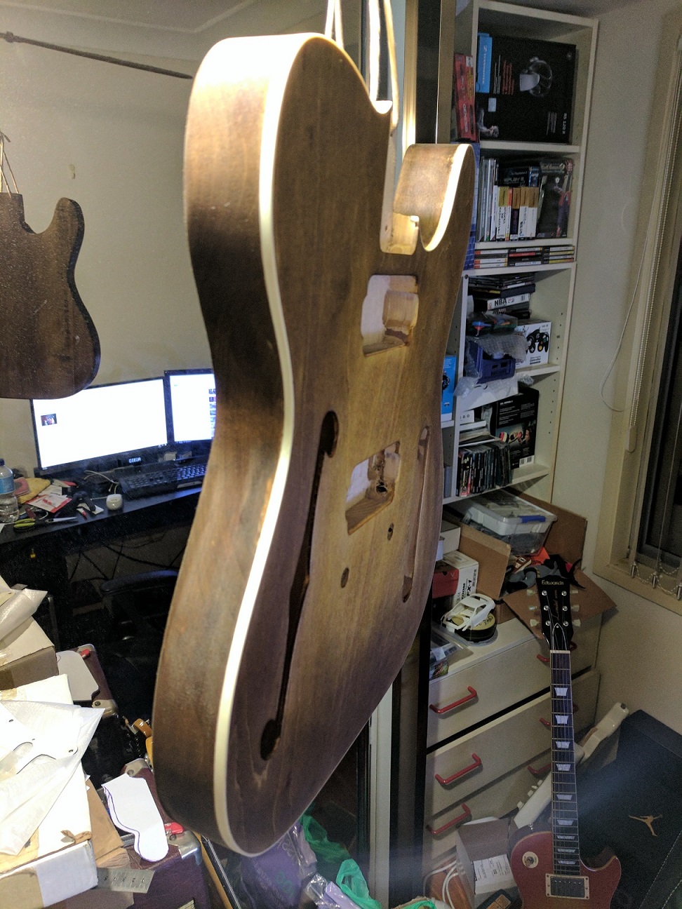

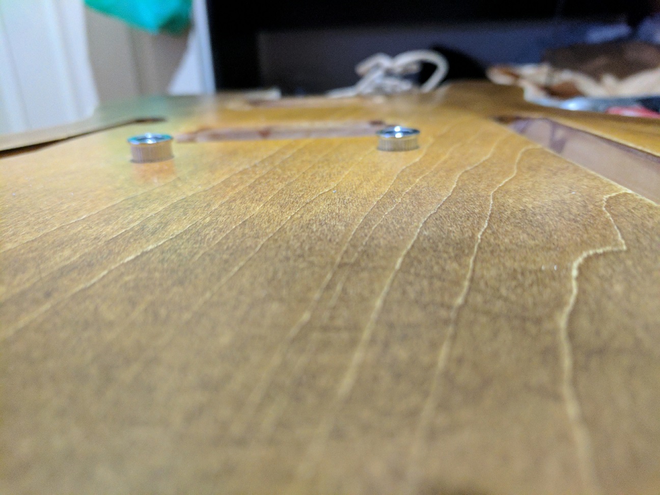

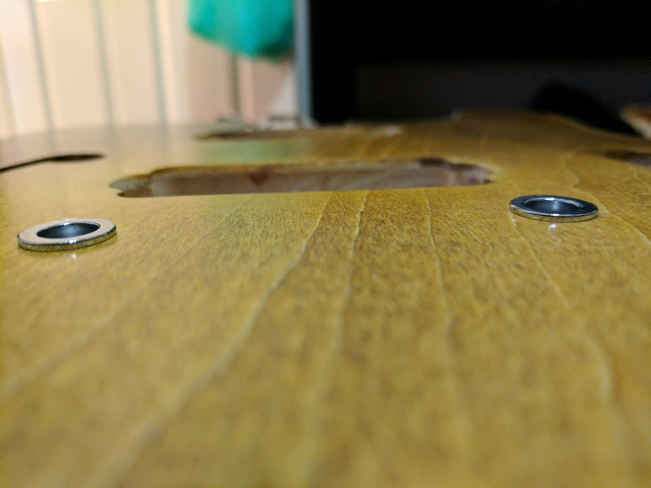

    I have decided to go with Tru oil and matte finish
    Here it is after the initial coat

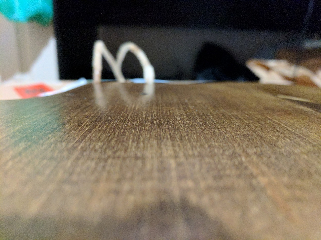

    After the initial coat, I applied another one, sanded with 400, applied 2 more, sanded with 800, applied 2 more then sanded with 1200.
ID:	20217Click image for larger version.
    Getting very shiny!
    After the 1200, I applied another 2 coats, then used 0000 steel wool to get rid of the shiny spots.

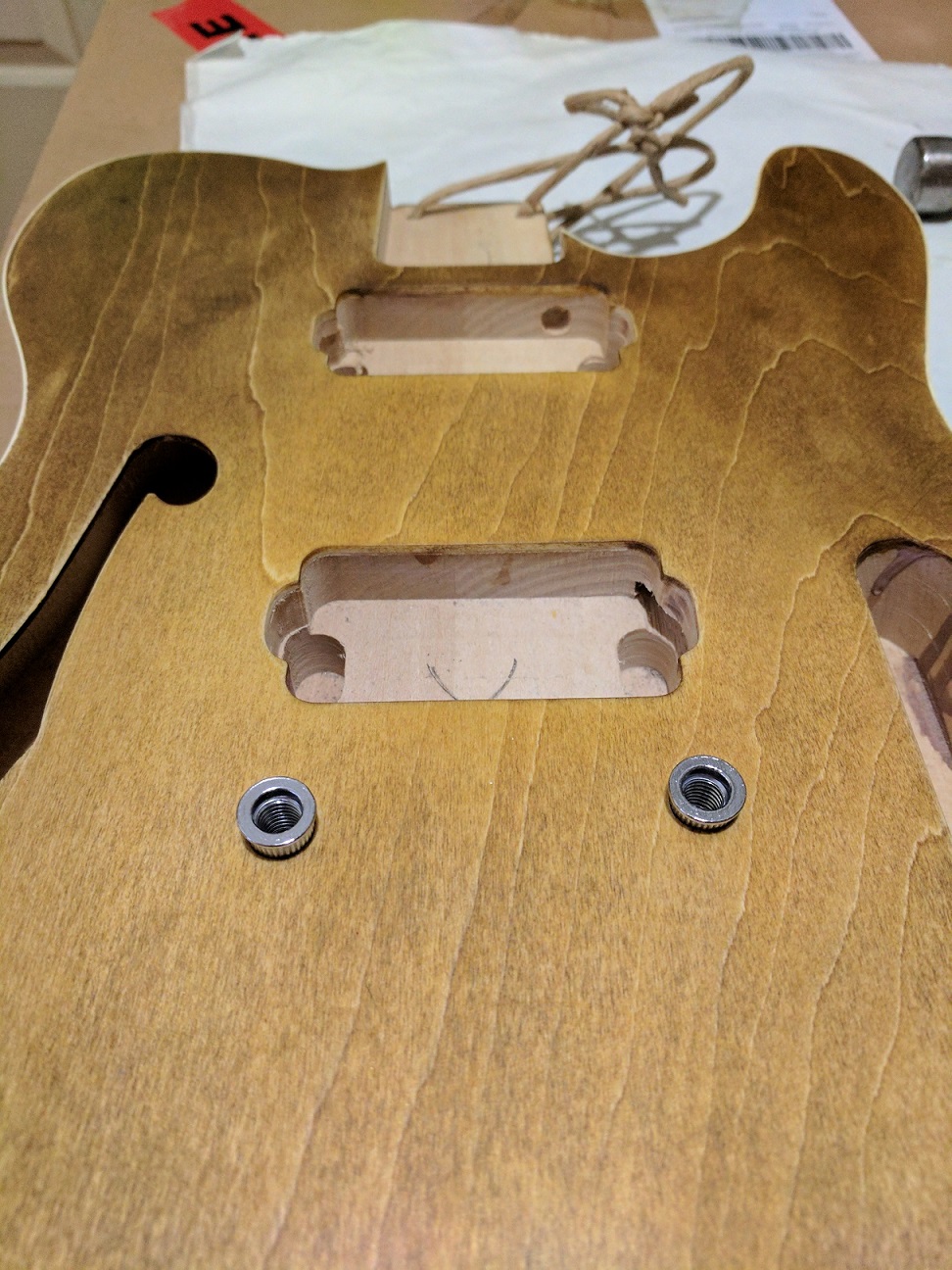

    Here it is with the studs half way installed, and the matte look
    Using a hammer and cloth between it and the guitar to push the studs in the rest of the way

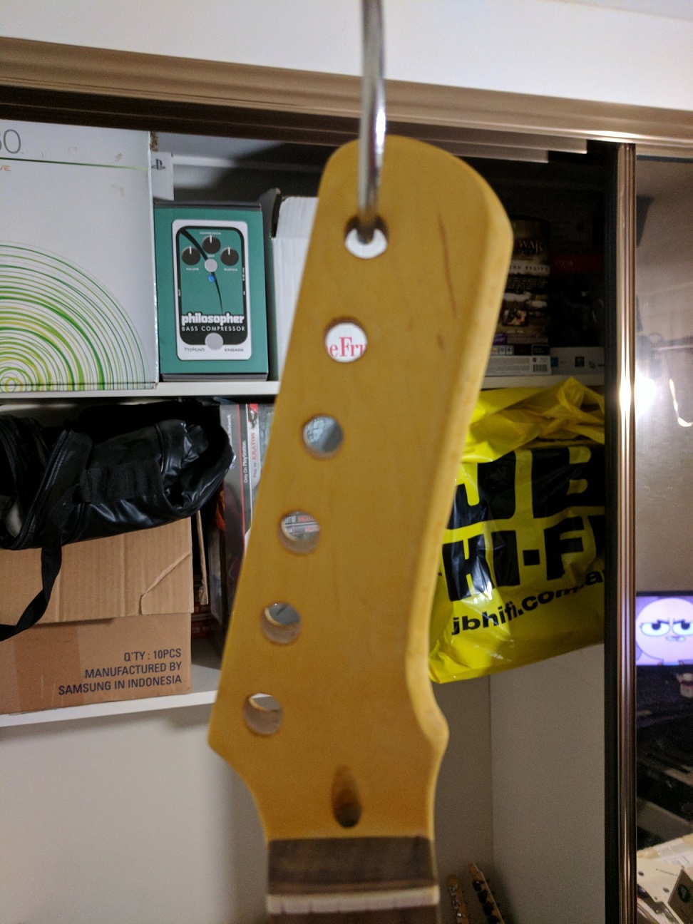

    More work on the neck, along with an amber stain

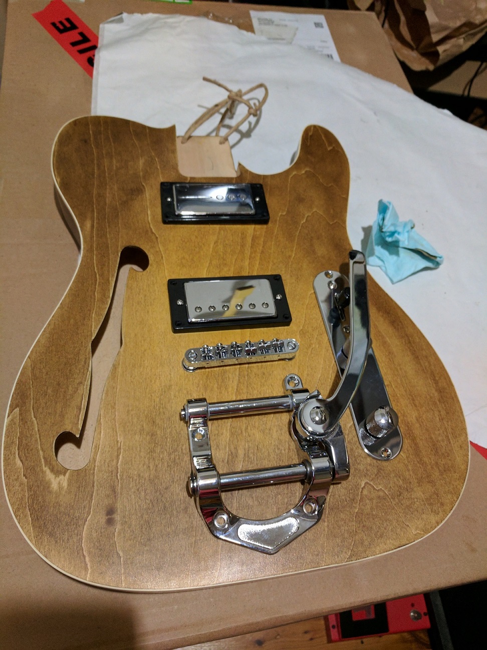

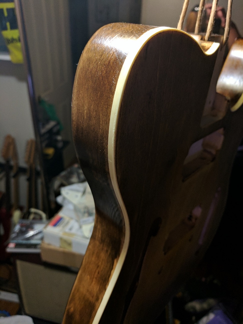

    Ended up having the front edge rounded off.
    Here's the body to give me an idea of what it will look like
    Not using the pickups that came with the kit.
    The neck has a Railhammer Gnarly 90, and the bridge is from my Hagstrom Viking.
