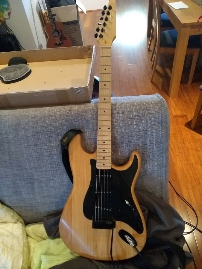

    Attachment 19757

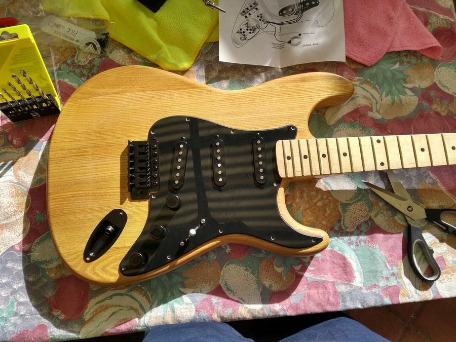

    Before fixing the pick guard i shielded the cavity with te rest of the copper tape. I could probably have done with maybe 15 extra cm of tape!
    Attachment 19758

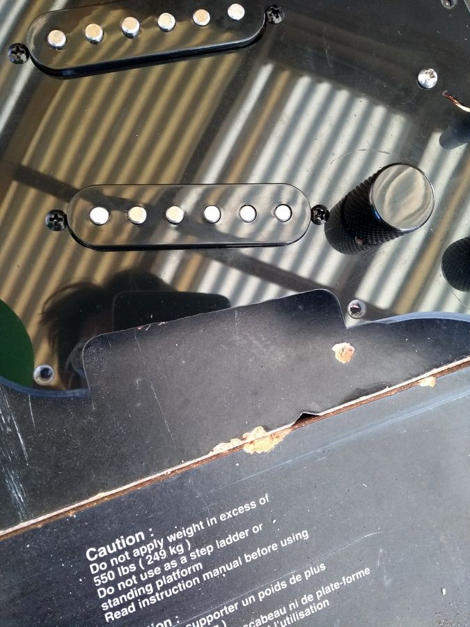

    Naturally not everything went smoothly. Even after checking the spacing when I came to fit the pick guard the bridge was oh so slightly too close to the neck and it wouldn't fit. I sanded down the bridge cutout with a dremel enough for the trem to work and not risk catching on anything.
    Attachment 19759
    Attachment 19760
    I used a ruler to align the tuners before fixing them and even though the holes look in line the tuners are slightly off.
    Then on went the strings, messed around alot with the trem claw tention to get this set right (so i ever so slightly pull up) and thats about it!
    Attachment 19761
    I may try and take a few better photos of it!
    At the moment my problem is the thing will not stay in tune in any shape or form. you only have to look at it and it goes off. I give the trem a light press and everything goes sharp. I think it might be the nut, although i got a bone replacement and have given it a drop of lube. Any ideas?!
