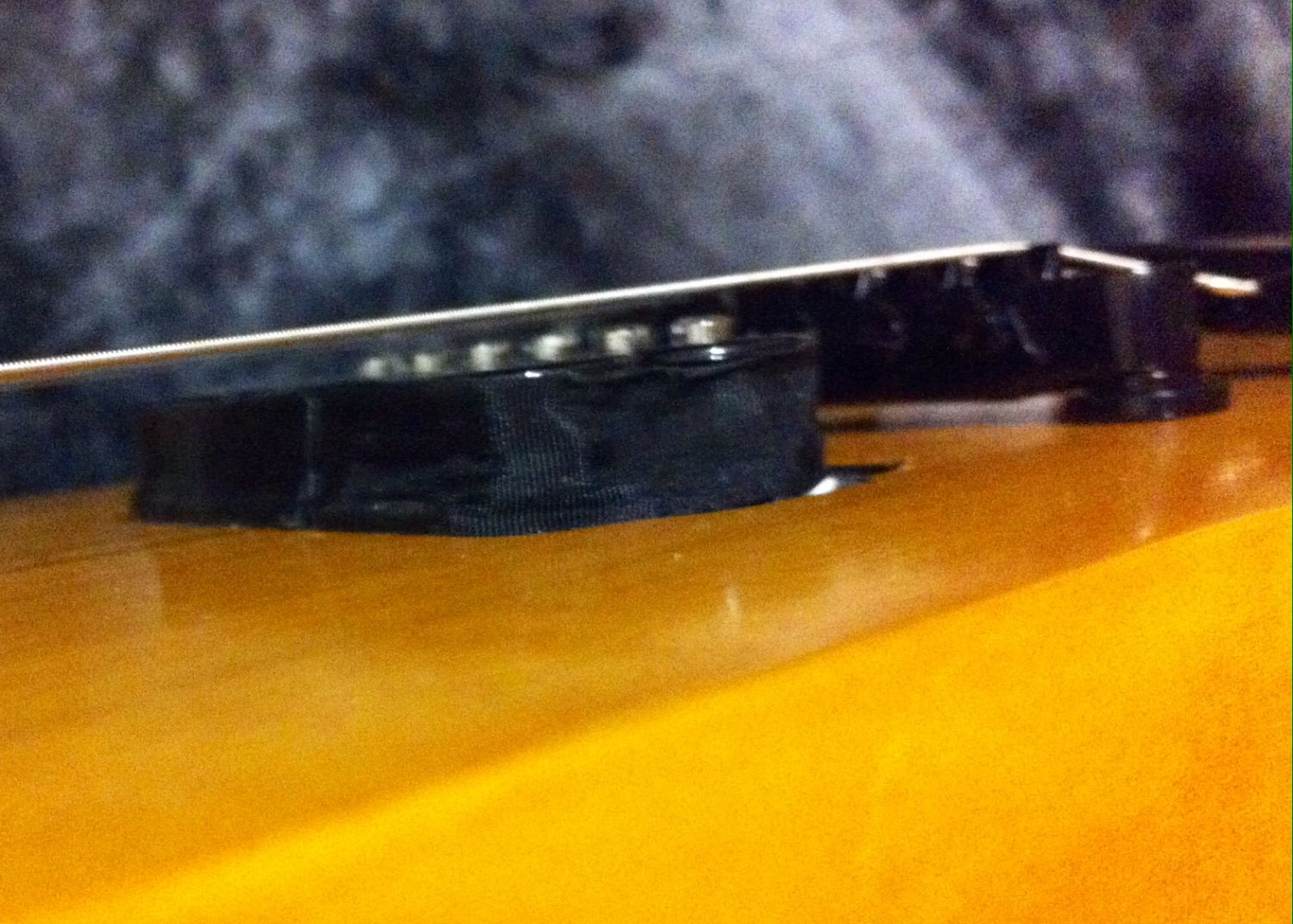

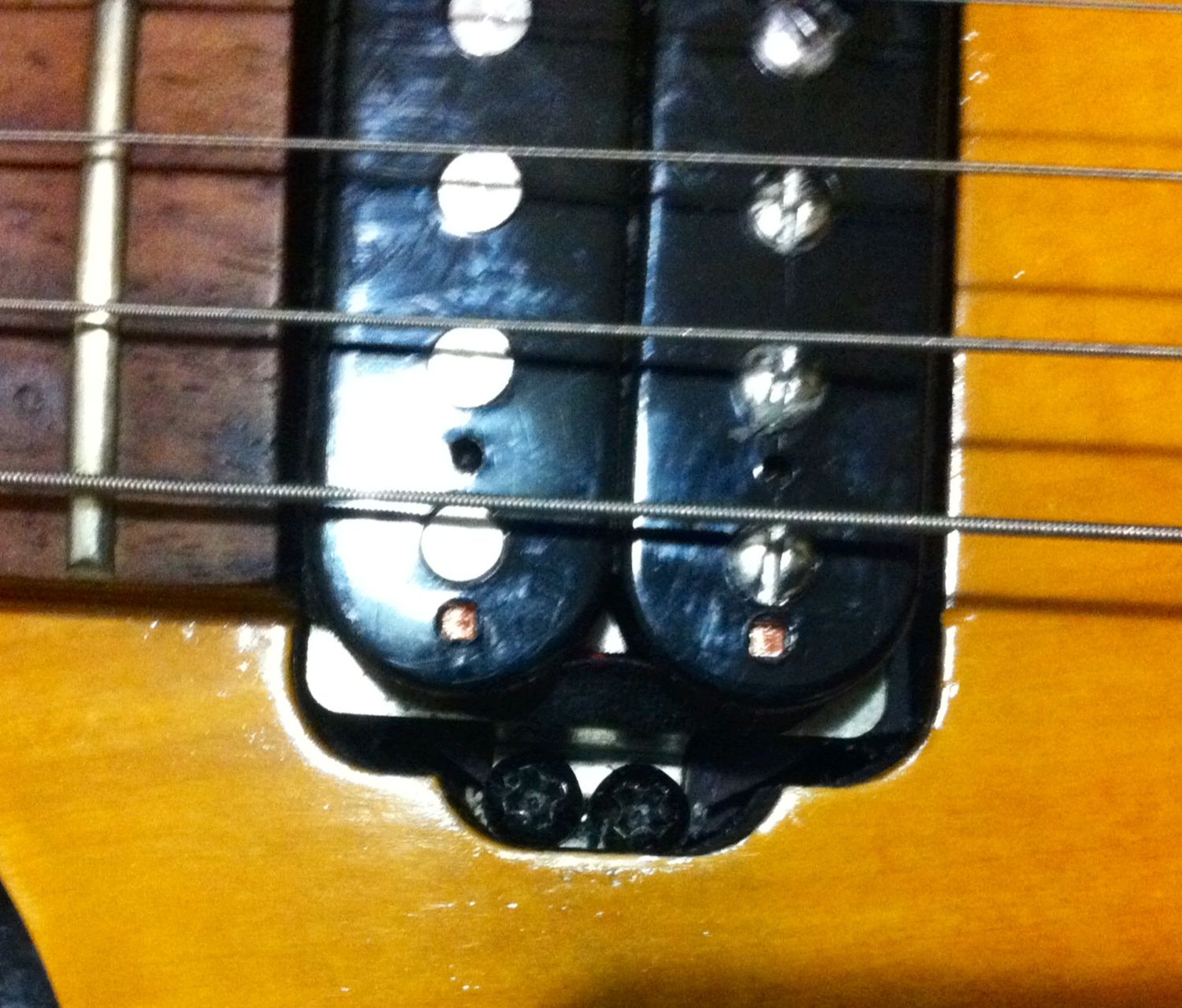

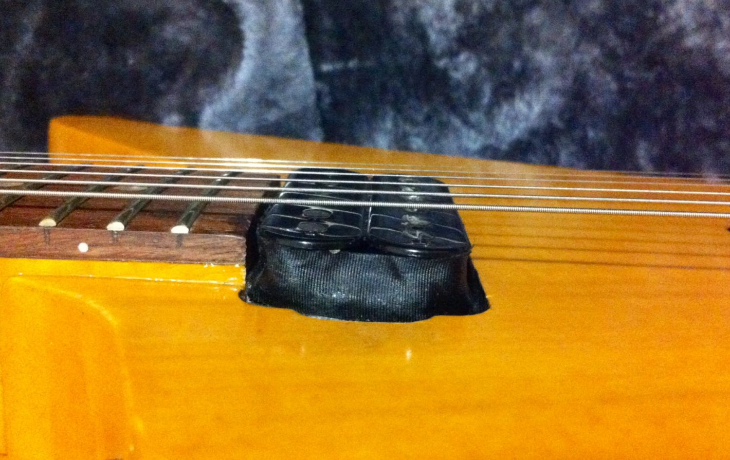

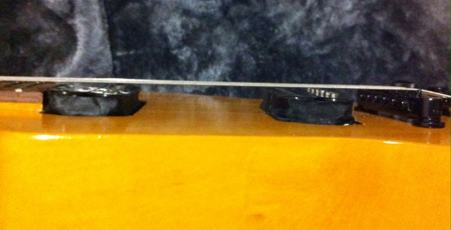

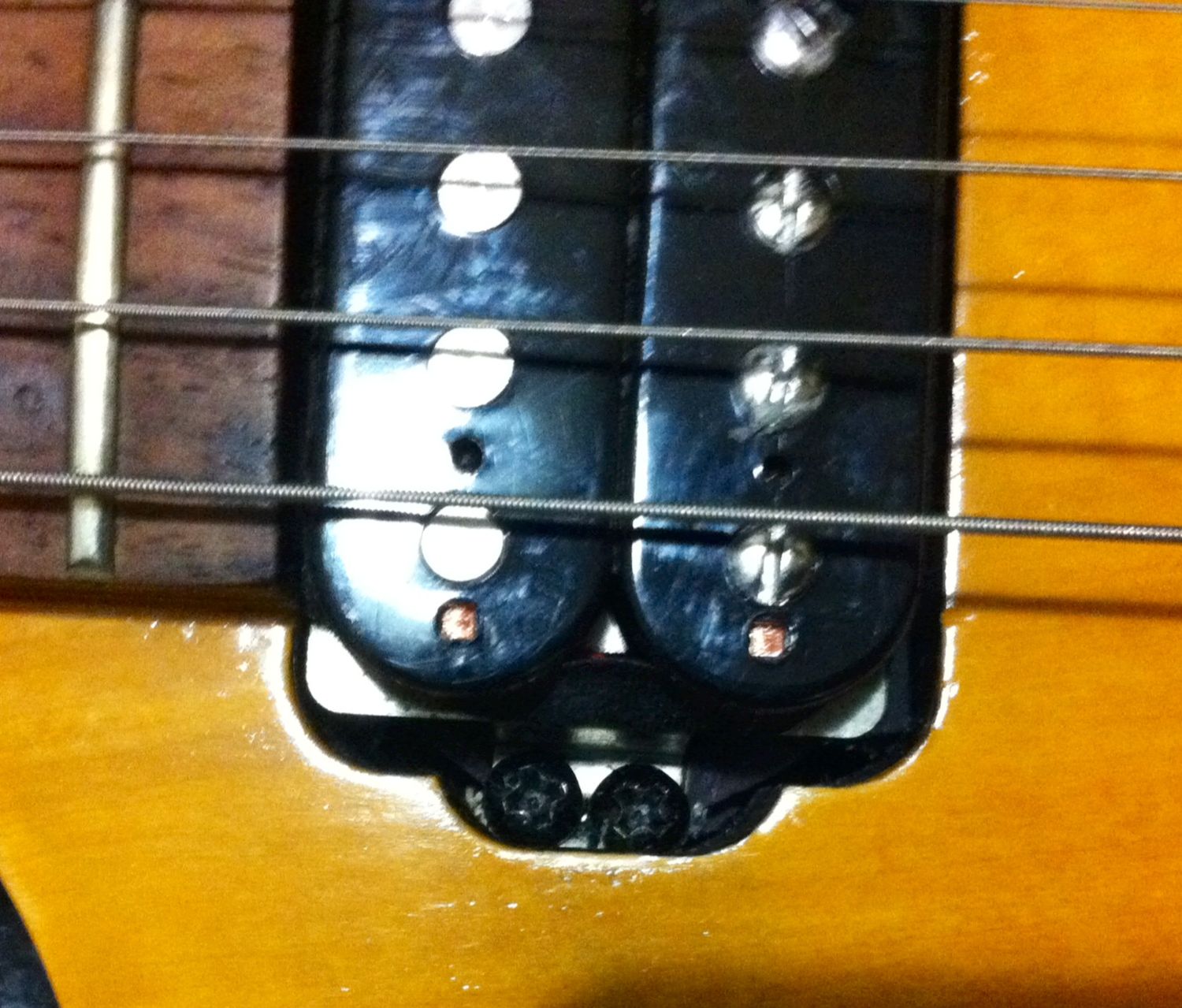

    Hi Frankie, on my 2 latest P90 guitars I direct mounted the pu's to the body. Like Simon says, you just need to work out your preferred distance between strings and poles. I guess if you are a fiddler and always looking for something to adjust or someway to improve your guitar that's not the way to go.
    I pretty much know what I like in a guitar setup and will probably not deviate from that too much so I thought that direct mounting might help tone a bit. But (queue Schultz's voice) "I know nothing".
    Judging string height on an unfinished build is the challenge as I had to re-do mine on the EX-1 a couple of times as originally (as in that photo) they were set too low and deep into the body and when amped up were lacking the serious grunt they were supposed to have. Raising them about 5mm made the world of difference.

    Just took these shots 10 mins ago to show what it looks like now. Hope this helps in some way?
