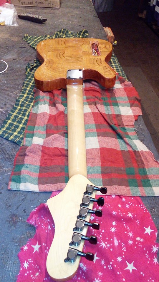

    Hey Andy just saw this thread. The neck heel shape of left and right hand necks should be the same shape.
    I made the mistake of the pine end grain tele had a reverse headstock but had right hand tuners for it. No big deal but the eagle eyed people would pick out the tuners were upside down haha
    I think if you emailed Ads and asked for a reverse headstock he should be able to interchange on a ST-1 kit if he has left hand necks in stock but maybe you are saying they are out of stock till August and the ones he has may be in left handed kits
