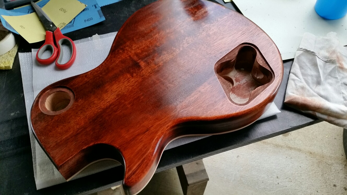

    Photos as promised.
    #1 First coat of Birchwood-Casey sealer/filler after sanding back with 400 & 600.
    #2 One hour after second coat of BC sealer/filler applied ...
    Considering a third coat
    Neck looks very similar to the body...
    A few coats of BC Tru-oil to go on next.... then a coat or two of BC wax...
