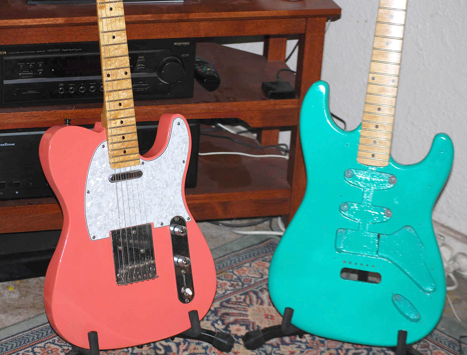

    probably 4 LS's DB, surely I have earnt my points to build axes and drink beer ?
    O.K. but I'll have a shandy thanks.
    edit: tried to link from previous upload but no dice.
    cheers, Mark.Click image for larger version.

    Sure, I found out that Ironlak 'Frezzeta' doesn't go well with Feast Watson Wipe-on Poly.
    It dried but there was some areas of blistering and the whole thing peeled off like sunburnt skin.
    Took advice from the youtube 'Brad Angove's' view on using the same brand clear.
    Re-sprayed it with Ironlak clear acrylic and it's a winner.
    Feast Watson stuck to the Molotow quite O.K. though.
    cheers, Mark.
    Always a pain when mixing products - choosing the same brands for under coats/ sealers, top coat and clears is always the best way to go if possible - at least they stick to each other
