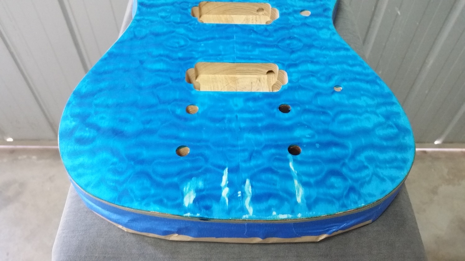

    Hey Ads, maybe ask if they can cut a thicker veneer (or ask their veneer supplier) would be better than gluing 2 thin veneers together, plus would be more time consuming for the factory you would have to glue one veneer at a time and make sure the centre line is lined up. If they are about 0.6mm thick now I think a 1-1.2mm thick veneer would be ideal and save alot of sand throughs and glue seepage
    Most sand through-issues seem to be as a result of glue spots, though a few seem to be from trying to remove scratches in the veneer. Gluing a second veneer on top of the first would still give the same problem with glue seepage through the wood. And as you said Adam, any sand-through of the first layer will expose a different veneer pattern.
    Is it a cost or technical issue that stops them wanting to use a thicker veneer? Have they tried other glues that are less likely to seep through the wood?

    I agree with Wokkaboy and Simon. I'd prefer a thiker veneer over two layers of thin veneer.
    Besides the extra cost and time of applying two thin layers I think the overall quality of the veneer wil be less. And veneer is softer than the mahogony so the top could be damaged more easily.
    Other glue could also be a solution.
    Seems the problem isn't the glue spots themselves, but the wearing through veneer to remove them.
    If the veneer were thicker, then removing glue spots wouldn't be such a show-stopper.

    Yes, we have asked them for the past 4 years for a thicker veneer and it just doesn't seem possible... for them.
    I guess it's their supplier who is refusing to come to the party.
    We'll keep pushing them though.
    This photo evidence will help our case.
    Adam
  7. #17
    This one on an IB-7 from a little time ago

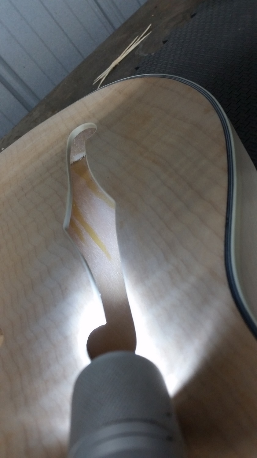

    And for a little variety some excess glue from binding running down the inside back on a FS-1, some on the outside but seems to have cleaned up with Goof-off. (Used the torch to make it easier to see in pics)
Name:	glue inside.jpg

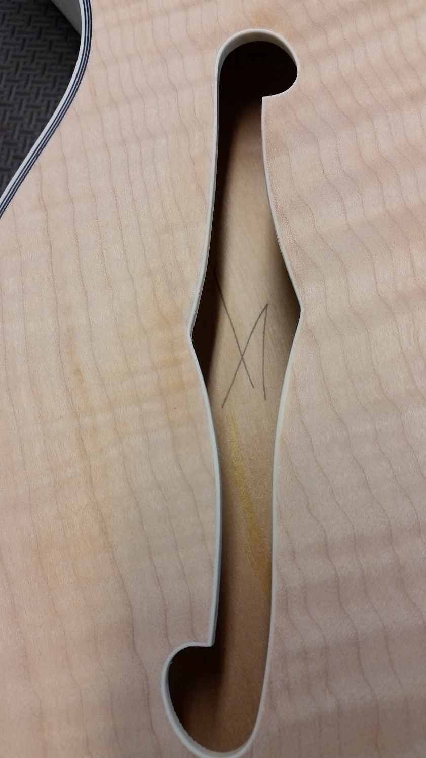

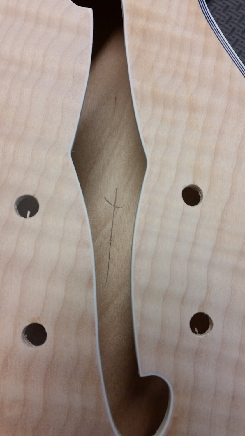

    Someone was so proud they decided to sign their work, through both f-holes.
