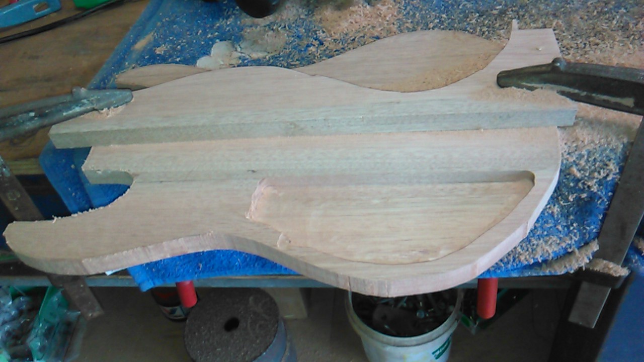

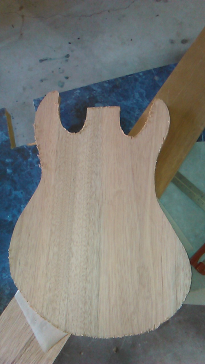

    today we progressed a fair bit from where we were before. I was messing around with the template for close to half an hour nutil I got something that I liked a bit more than the old one.

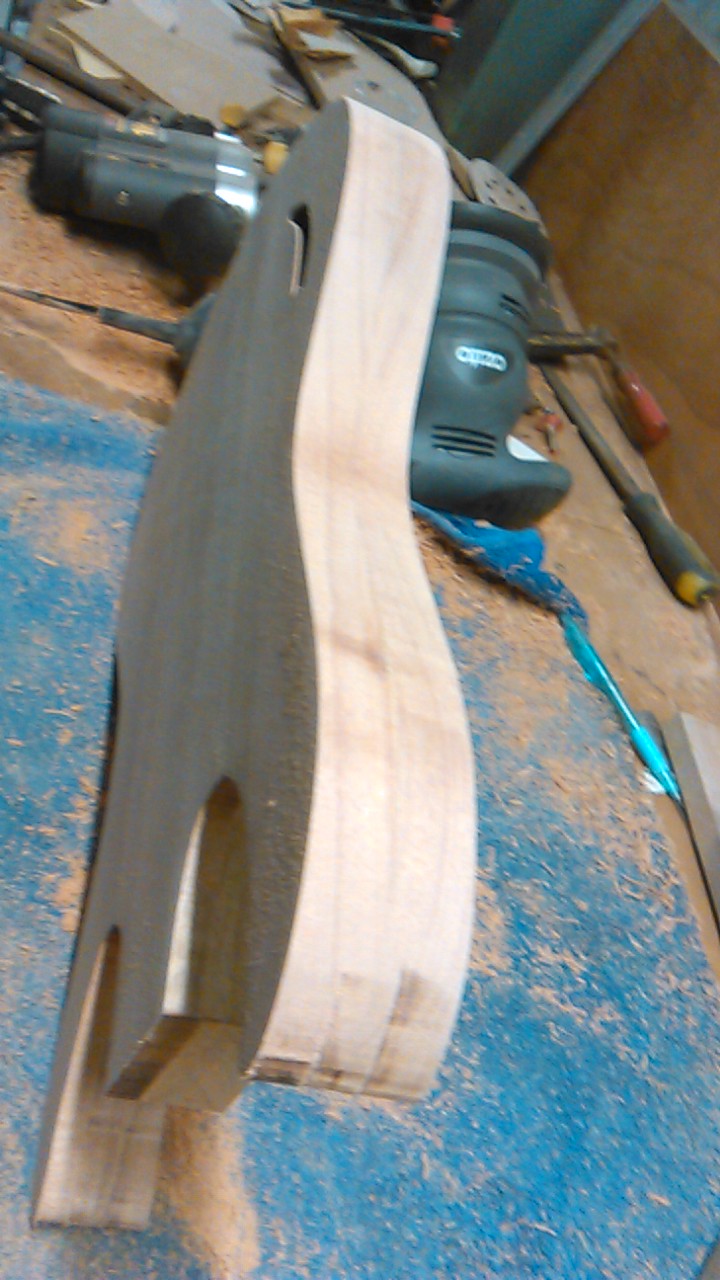

    then we routed out the cavity for the semi hollow body part for both the top and bottom.

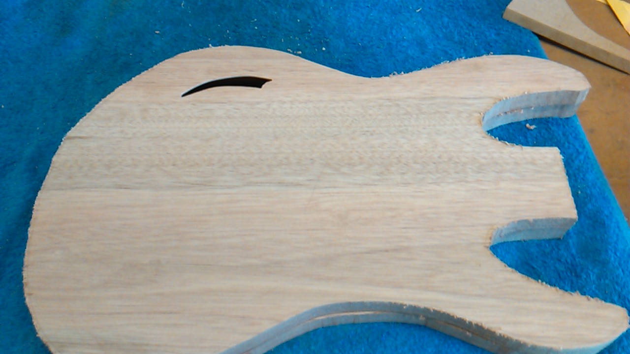

    and then we made the sound holey bit that hollow bodies have.

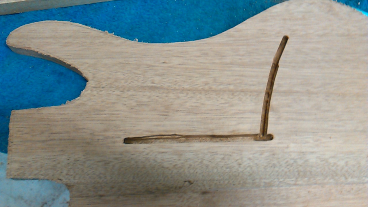

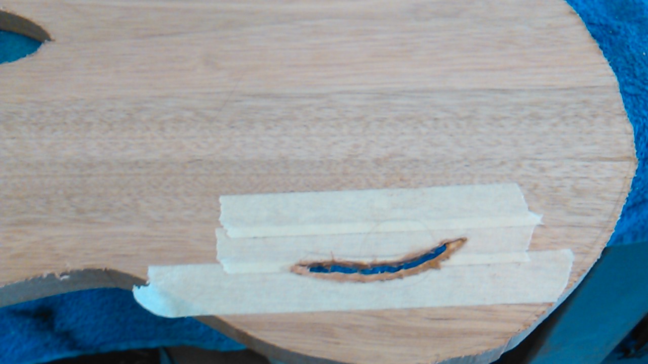

    and then we routed a line for the pickups' wires to go to the control cavity.

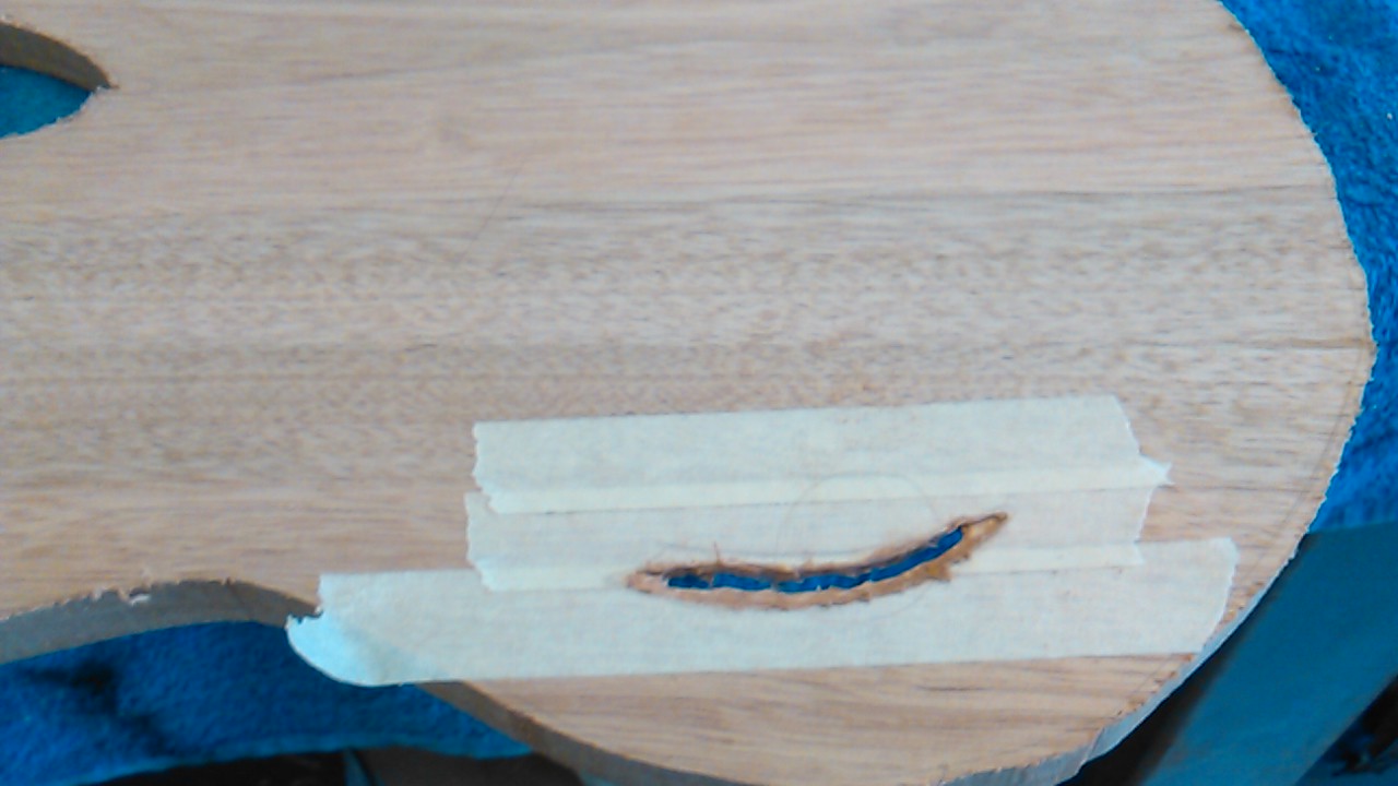

    and then we glued both the top and bottom together.
    when everything is routed out and ready to go I am intending on using a cherry red stain or one similar to that with a black grain pop as well as binding on the top. i'm hoping that there will be enough room for a bigsby style tremolo with a roller bridge. for pickups I am going to use GFS Dream 90's for the neck and bridge pickup with a gold foil single in the middle, also GFS. and for the neck I am going to have a maple fretboard strat style neck with locking tuners.

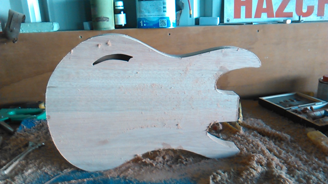

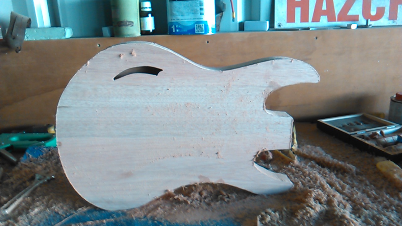

    yesterday we took the guitar out of the clamps and it looked a bit like a guitar.
    then we routed it down to the template and started to sand down the sides so that all the little imperfections were gone.
