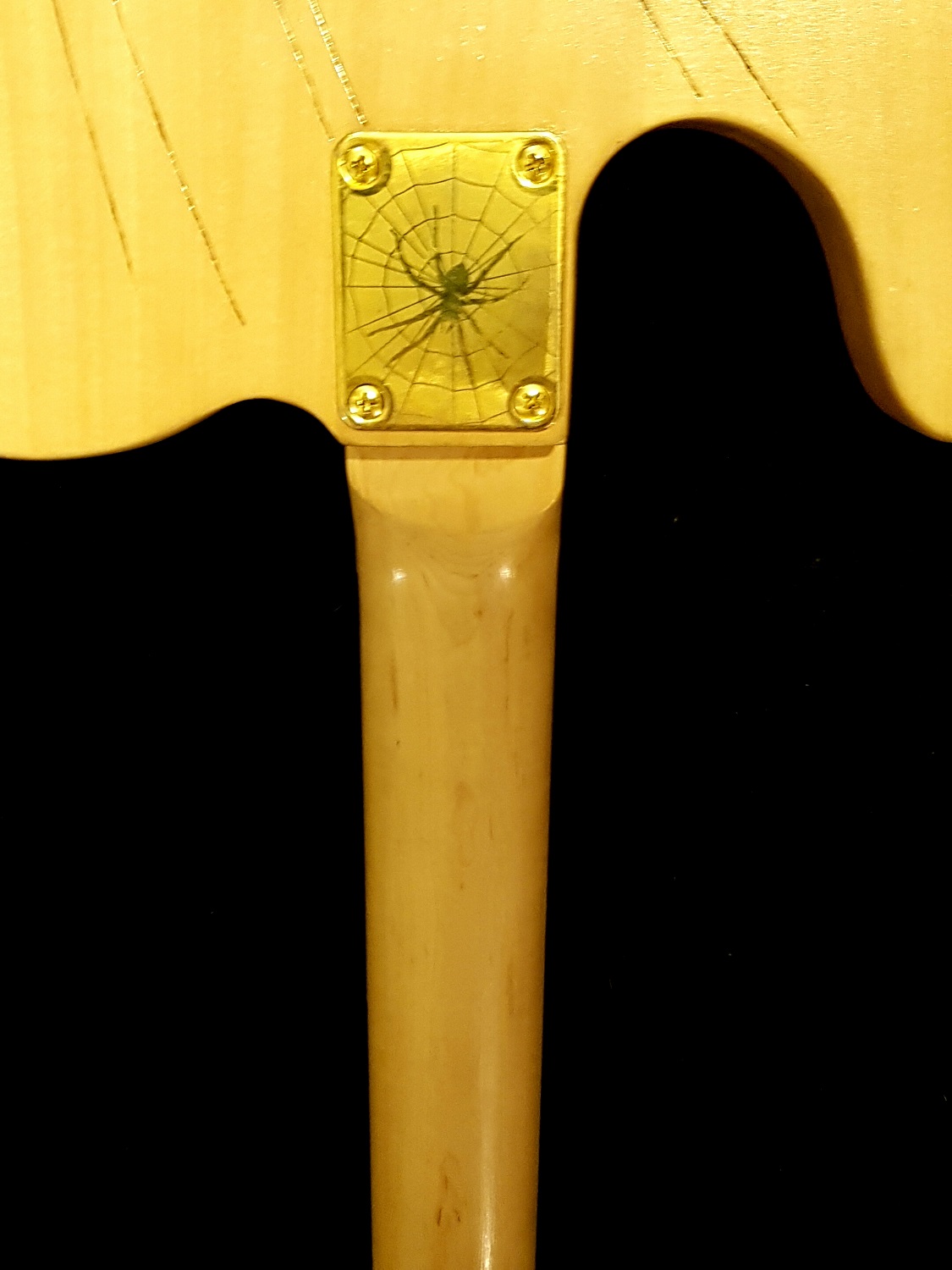

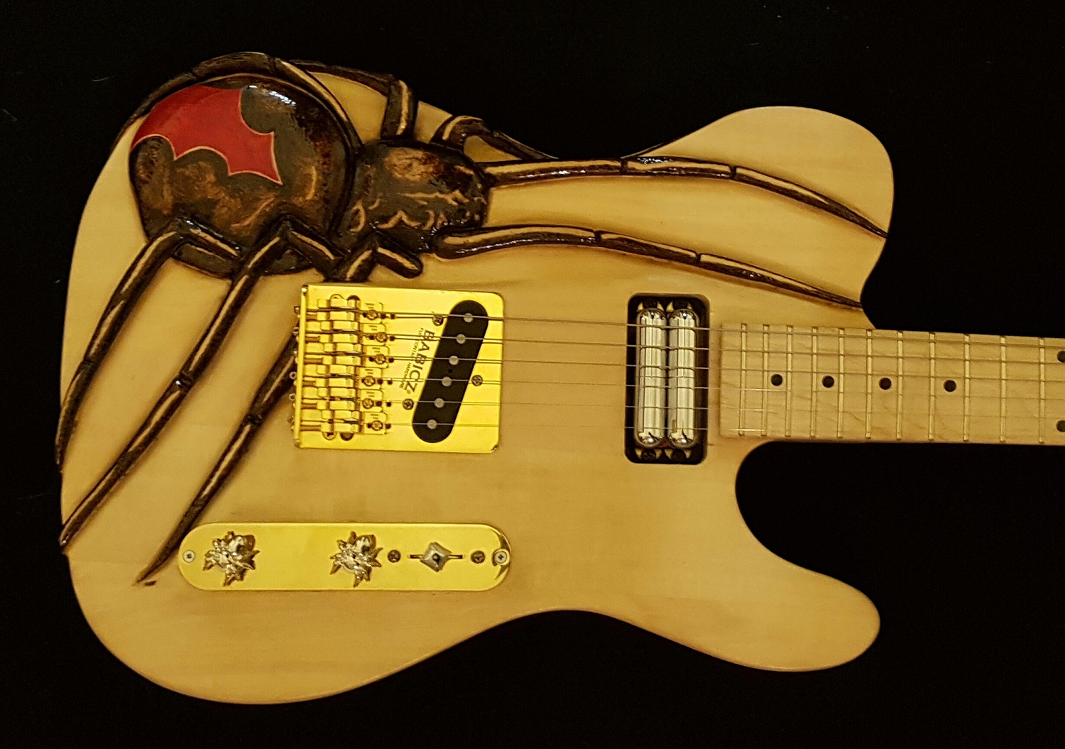

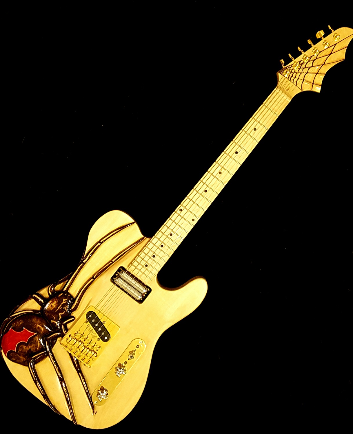

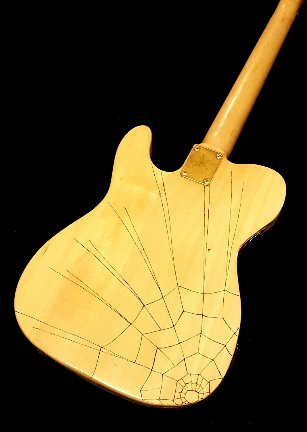

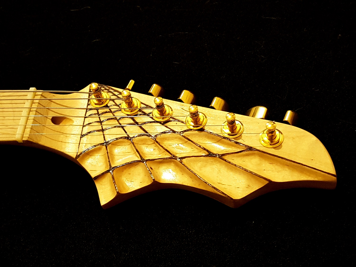

    This is my first guitar. TL-1 Kit, Hand carved 3D Redback Spider and carved headstock with Pyrography finish and web on the back.
    Schaller tuners, Camel bone nut, Lipstick humbucker in neck position, Babicz full contact bridge and Tone rider single coil pickup, Spider neck plate from Texas, Stirling silver spider knobs from Canada and Guitar sauce vintage wiring kit.
    I think thats everything, hope the pictures came up ok.
    I finished the spider and the headstock in clear Gloss with the rest of the guitar is natural timber in Satin to help make the big girl stand out.

    Well, that is a 'scary' axe! But a well-done job!
  10. #17
    Babicz Bridge and the Pups man, props to you. love the redback man, looks killer
  11. #18
    Great job Gee-Gal. How long did it take to do the carving?
  12. #19
    Thanks everyone, the carve itself took about a week but I spent hours upon hours of sanding before burning it.

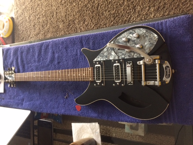

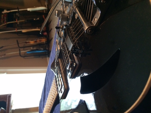

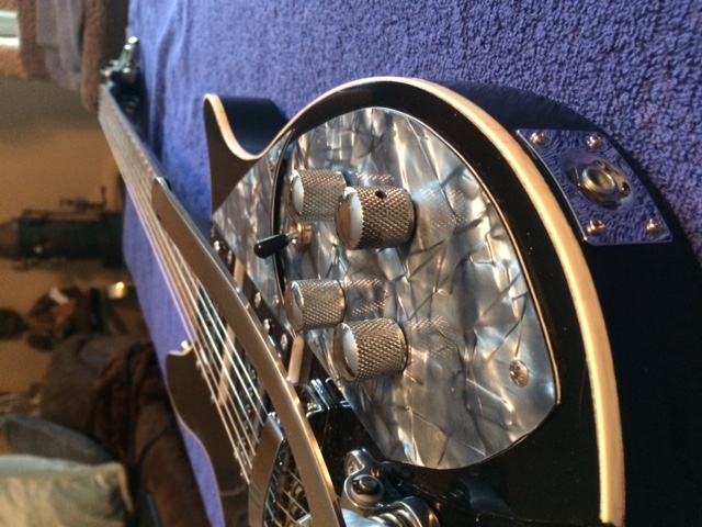

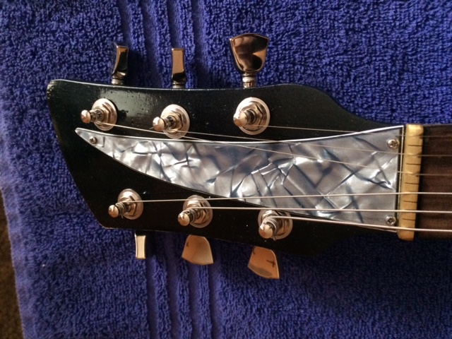

    Here is my offering for May
    Here is my rc1i posted the other day. Internet trouble prevented it from happening yesterday. The headstock shows the offset tuners. I installed Grover tuners. Rickenbacker high gain pickups and bridge. Bigsby tailpiece, axemasters compensated nut. The paint is automotive chrysler brilliant pearl. It has a lot of sparkle under good light. Several coats of clear on top of that. Camera just doesnt seem to pick it up. Custom made black perloid pick guard. Tbe pickups had to be recessed in the body cavity. They are a very tall pickup. Still retained the height adjustment. Thanks for looking and the support.
