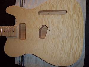

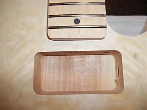

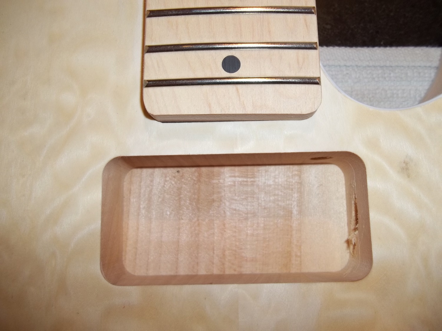

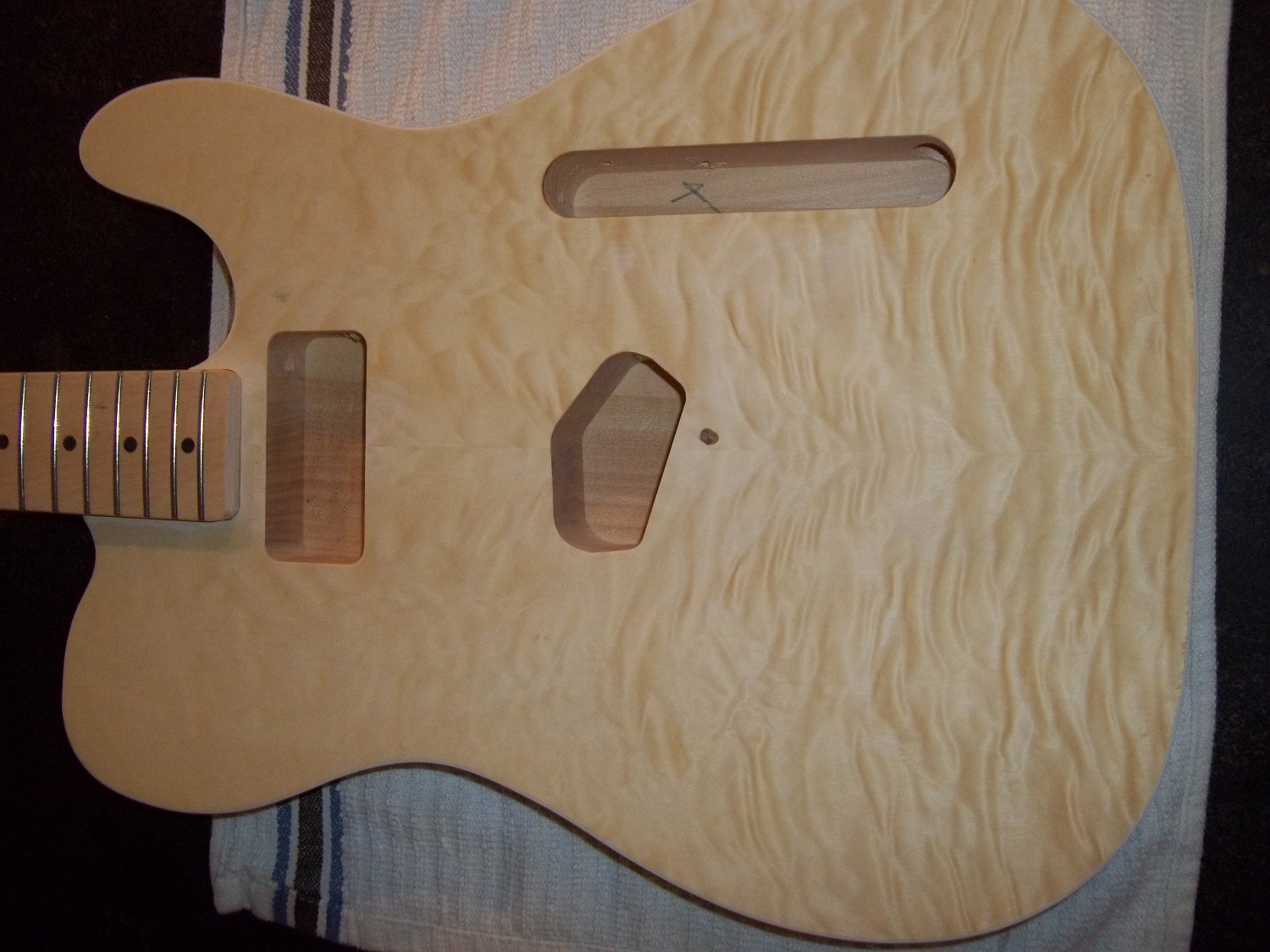

    Yeah sorry having trouble get them to upload.. I have to get the picture in a smaller format and I am technically challenged but good with tools.
Name:	front drying.jpg
ID:	18487. another picture

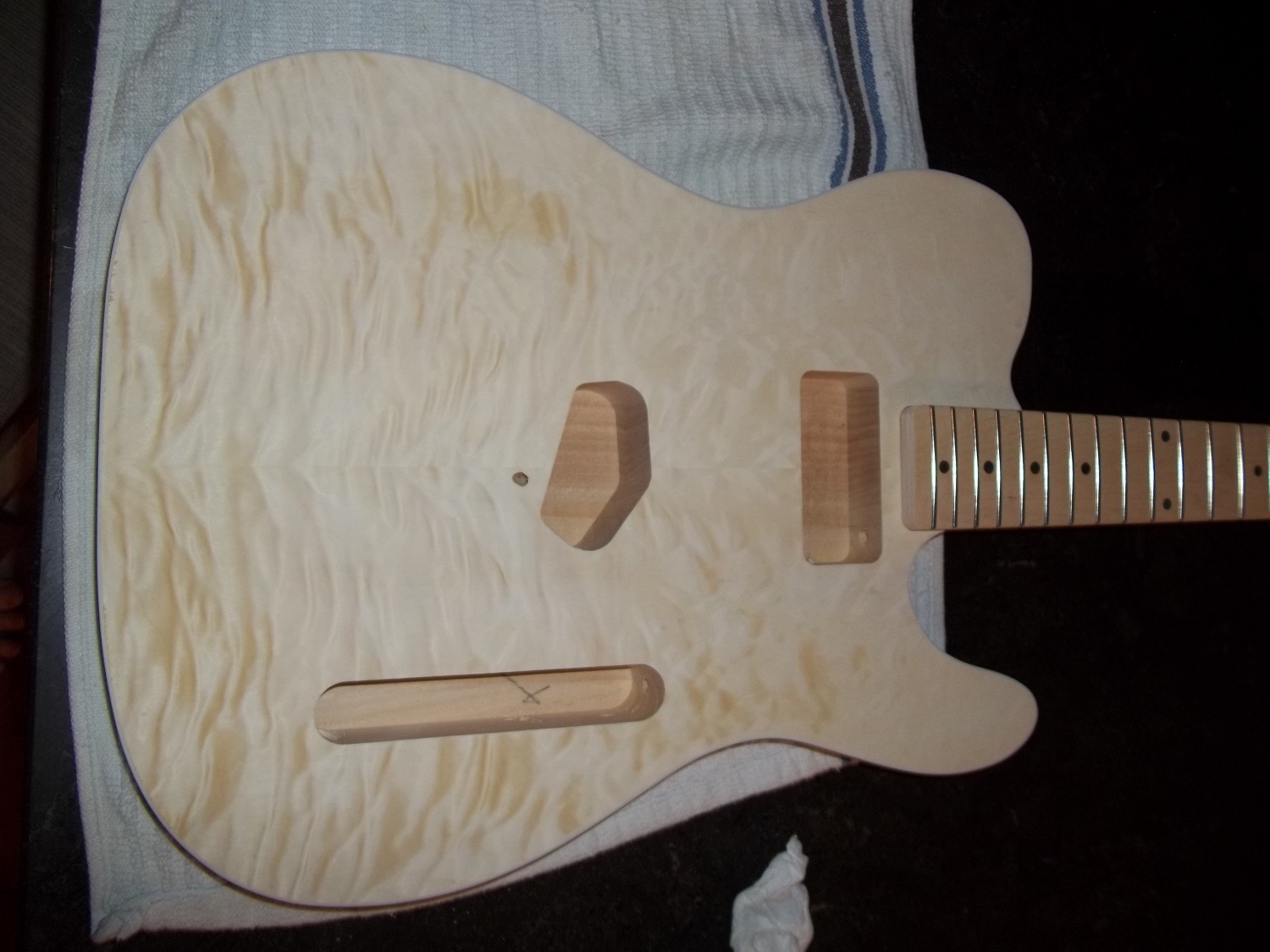

    Here are a few pics that I have been able to resize to fit but I can't get any of the close up picks to resize and keep enough clarity to see the issues. But nonetheless it does have a great quilt pattern which should pop good using ILR's method of staining.

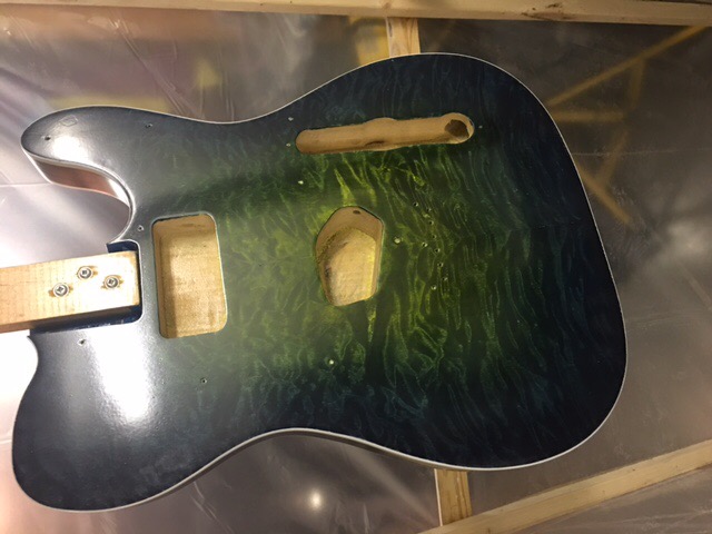

    Member ILRGuitars's Avatar
    385

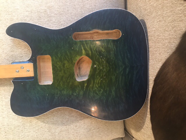

    Kick has a nice method of staining on his LP-1Q. He has done the colour first then the black. I use a spirit based stain for the black and a water based stain for the colour. Try a few different ways on scrap to see what suits best for the result you want. Can't wait to see it.

    Quote Originally Posted by ILRGuitars View Post
    The reason I done this was purely because of the thin veneer. Normally its done by doing some coats in black and sand that down. You can do this when you have a thick layer of quilt. You can even use a sandingmachine. But when the veneer is only 0.7 mm thick you can not sand the black of because you probably end up sanding through the veneer.
    So I started with the color (red in my build) and then slowly added black to the red mix to get the dark in. And I used full black for the burst effect.

    I have wiped down the whole body 2 times with damp cloth and only found 2 very small blue spots. Should I use turps or naphtha to make spots show up better or is the water fine. I don't want to miss any.
  10. #20

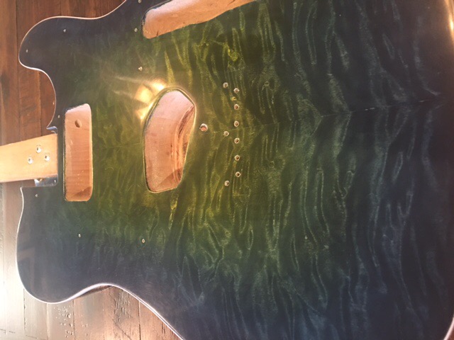

    Quote Originally Posted by Drummerdude View Post
Name:	guitar front close.jpg
ID:	18485Click image for larger version.
Name:	neck pocket.jpg
    Now that is some EPIC quilting right there. This is going to look hot!
