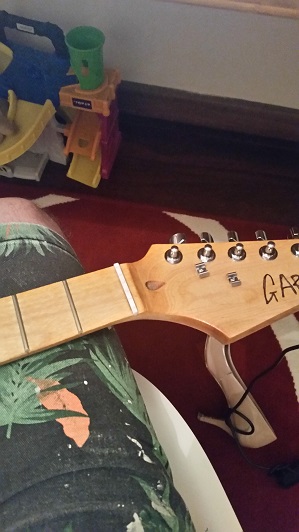

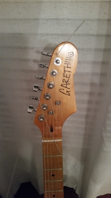

    My next thing is the neck. I've done my stain coat and then finishing coat on it. When I did it, I stained and finished the fretboard as well, as I hadn't read the bit about people taping this up and not doing these things to it. I've got some Dingotone wax now (presumably to use on the fretboard). What should I do now with the neck?
    Here's what it looks like, and no sweat if I have to take the tuning pegs, string trees etc out again:

    Hey Gorath,
    Sorry I have't got to reply on this for a while. I don't get a lot of time to post these days.
    I would take the DT off the fretboard using a Stanley knife blade, then smooth out with some 1200 grit, then Dingo wax the fretboard. To Dingowax, I dig out a little bit and ply it in my fingers till it gets a bit soft and warm, then apply to a rag, then apply thinly to the fret board, then rub excess off with a rag and buff to shine.
    Good luck

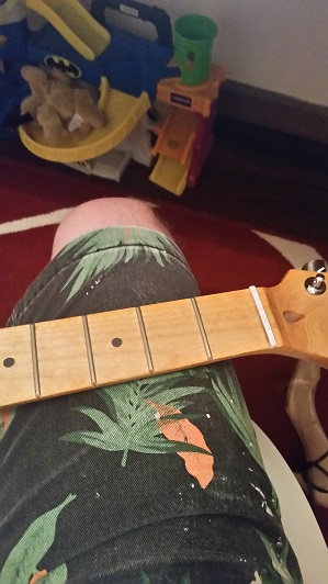

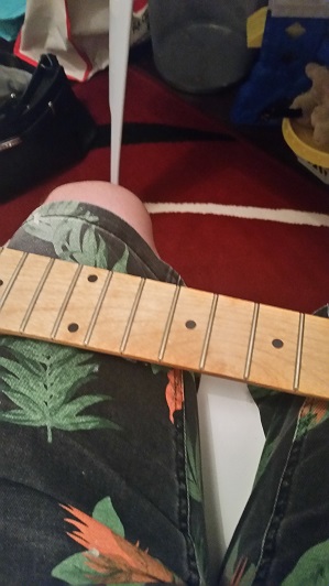

    Thanks Andy, I'll give that a go on the fretboard.
    What should I do with the rest of the neck? Polish/buff?

    2,801
    Quote Originally Posted by Gorath View Post
    P.S. hope you enjoy my Hawaiian theme board shorts.
    Don't all guitarists wear cargo shorts with a Hawaiian theme
    welcome and cool Tele. Yep, polish and buff the rest, looks good.
    The DT wont hurt the fret board, it's just that it will show wear as you play it. Maple necked fenders have their lacquered, so no big deal
