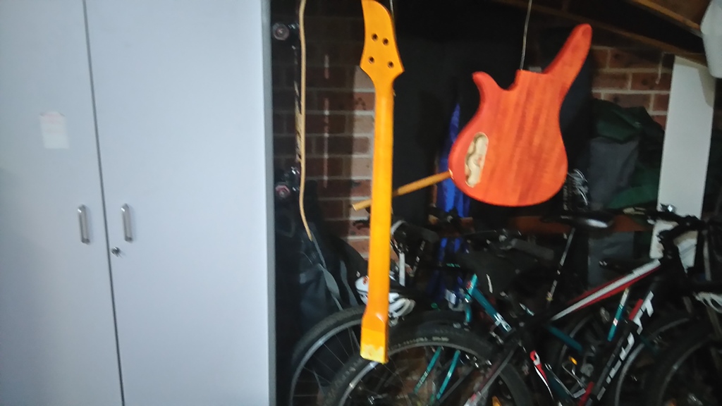

    So did another coat of bushfire sunrise on the body and a cot of 5:1 mission beach to bush-fire on the neck. i think it's looking pretty much exactly like what i had picture (maybe a bit deeper on the body but this will be accomplished by the intensifying coat).
    Pics aren't great quality but show more or less the color.Click image for larger version.

    So on Saturday I put the first coast of intensifying and I think it's just about where i want it. Any tips for finishing (especially regarding the neck)?
    Pics to follow
    Hey SWAM, looking good. If you are happy with the depth of colour, let the last coat fully cure, give it a light rub with super fine steel wool and start your final coats.

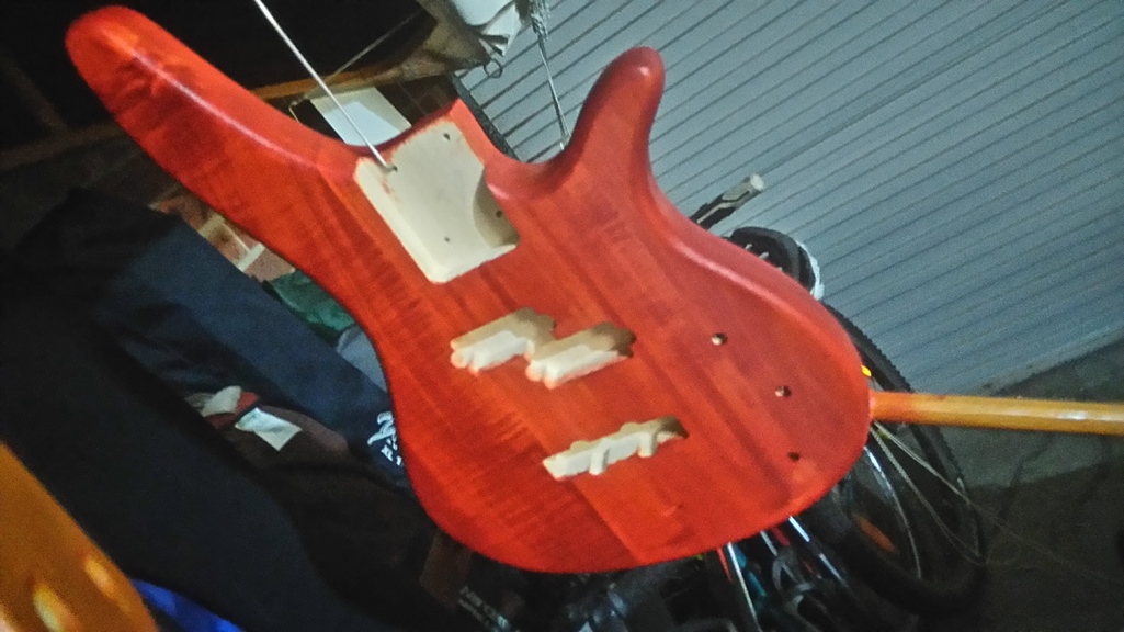

    Thanks Wokka for the quick respond, I didn't even have time to get the pictures. Anyway I'm very Happy with this depth. Is there anything i should be concerned with as far as weather goes? it's been raining here in Wollongong, does this matter? Well here's a pic as promised. Bush-fire sunrise 2 coats stain 1 coat intensifying for reference

    Jan 2017
    Wollongong area NSW
    23
    Actually looks a bit darker in person
  6. #16
    looking good Segway. If the humidity is over about 60% then wait for it to drop, otherwise the DT won't cure very well. DB recommends you allow at least 3 days curing between coats and if it's cooler weather add an extra day or two. You may find that the DT gets a bit darker as it cures
  7. #17
    Looks really good, colour looks great

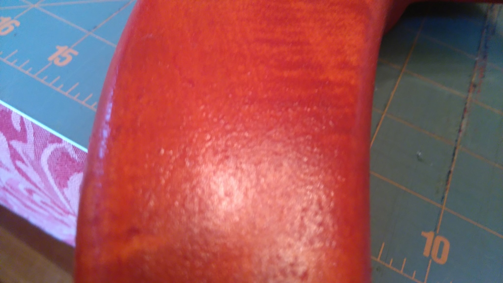

    So today I was going to start with the final coat on the body and noticed some small bumps and particles in the finish (see photo). any recommendations on what I should do? thanks in advance.
  9. #19
    I'd do some careful wet sanding with say 1500 grit paper. Light strokes as you want to level it, not break through the finish.
