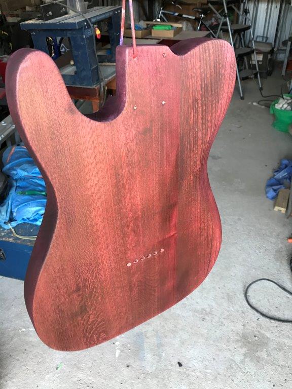

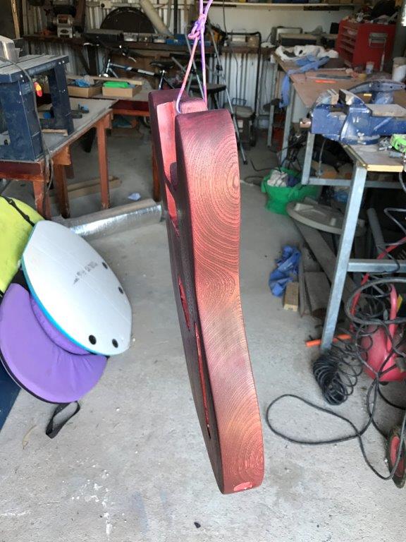

    I decided to sand back the veneer and see what was lurking underneath, surprisingly there wasn't too many nasties, just a couple of character adding imperfections. After a lot of sanding over the last week and many tiral and errors (on scrap timber) this is what I have ended up with, the stain is still a bit damp in these pics.

    That really strong grain pattern at the top bouts sort of seems out of key with the rest of it which matches a lot better. In saying that it does impart some character, and i really like that red, is that a DT Stain?

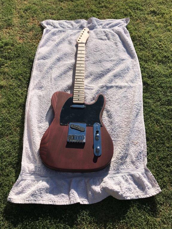

    Tonight I couldn't help but sit the hardware against the body and see what it looks like. Very happy with how its looking thus far. The photos tonight didn't pick up the colour very well, but it is a very deep burgundy which looks great but I don't think I want it to go much darker. My original plan was to have a high gloss finish but seeing this as it is now I'm thinking more of an oil type finish, just to seal it and enhance the colour a bit, maybe a true oil or something similar. Will this make the finish much darker?? Any other suggestions?
    Also really like the contrast with the lighter neck and fret board, was thinking possibly the same oil on this. Does the fret board require any special treatment other than a good oil? Also I assume it will golden up a little even with a clear oil?
    It certainly does stand out as the grain is bigger and runs the opposite way to the rest of the body, but I don't mind it. The stain was a Feast and Watson mahogany.
  8. #18
    Nice save Cobba. Lovin the look with the hardware. Very cool
  9. #19
    looking great Cobba, worked out fine sanding the veneer off, at least its ash timber underneath - no one will ever know
  10. #20
    Satin wipe on poly might work better that Tru Oil as it tends to gloss up.
    Everyone has different ideas and opinions on what to do with maple fret boards and almost anything works from lemon oil to wax to lacquered type finishes and all up to what look and feel you are chasing.
    Like the contrast in those shots and looking good.
