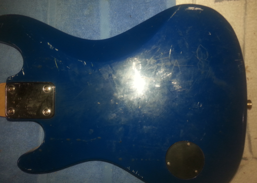

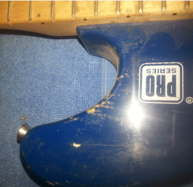

    I'd like some advice on the below pics. You can see there are scratches all over the body. Someone thought it was a good idea to graffiti it with a sharp instrument in it's past life haha. So yeah I'm open to suggestions on what to do? Sand it all off and start again or try to repair?

    Depends on how much work you want to do.
    It may be enough to get it making sound and then setup the action, whole lot more work refinishing too. All depends on how much time & effort you are willing to put in and whether cosmetics are ok enough if it sounds and plays ok?

    Thanks waz yeah cool im thinking i should get it working and maybe later if there is an intetest i could customise it for my mates kid.
