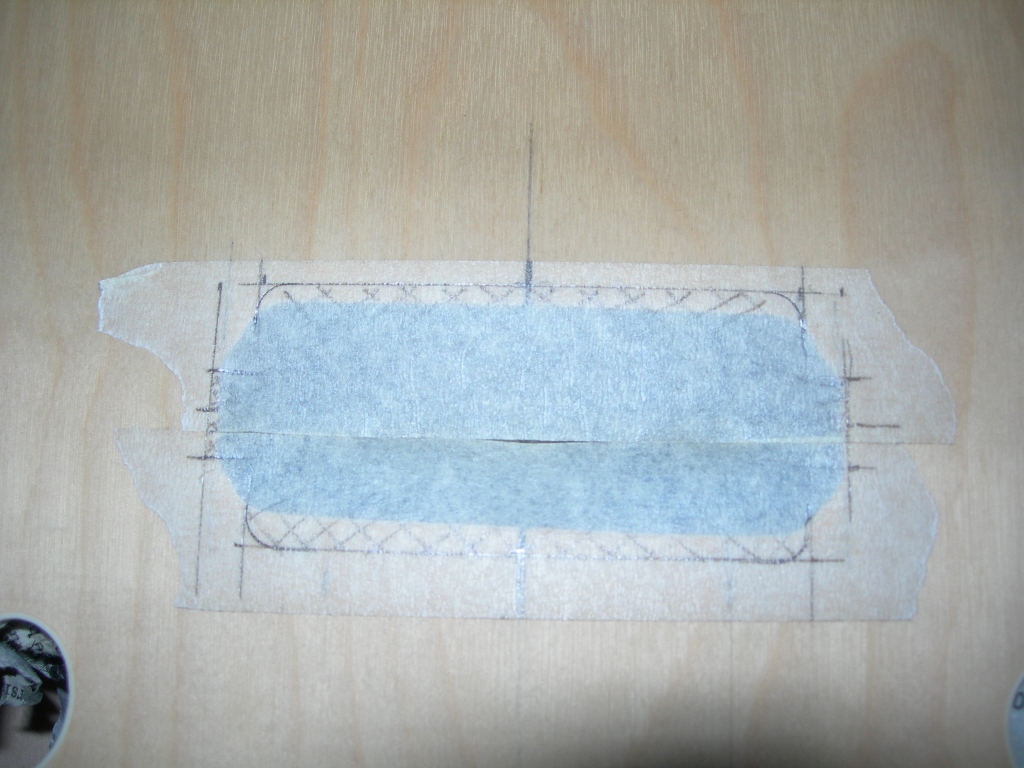

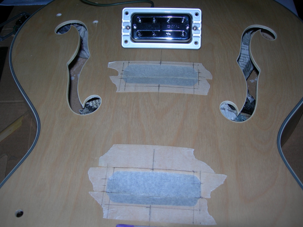

    Now that the neck is fixed in place, everything now needs to line up with the neck. This will stop strings drifting off towards the edge of the fretboard. A check with straight edges shows the neck is aligned spot on with the join in the sides at the end of the body. Careful measuring and a sharp pencil re-establishes a centre line to locate the pickups. The original holes are too small for the Thunder'Tron pickups and are also slightly off centre. Masking tape gives a clear surface that shows the pencil lines. How to now cut out the holes?Click image for larger version.

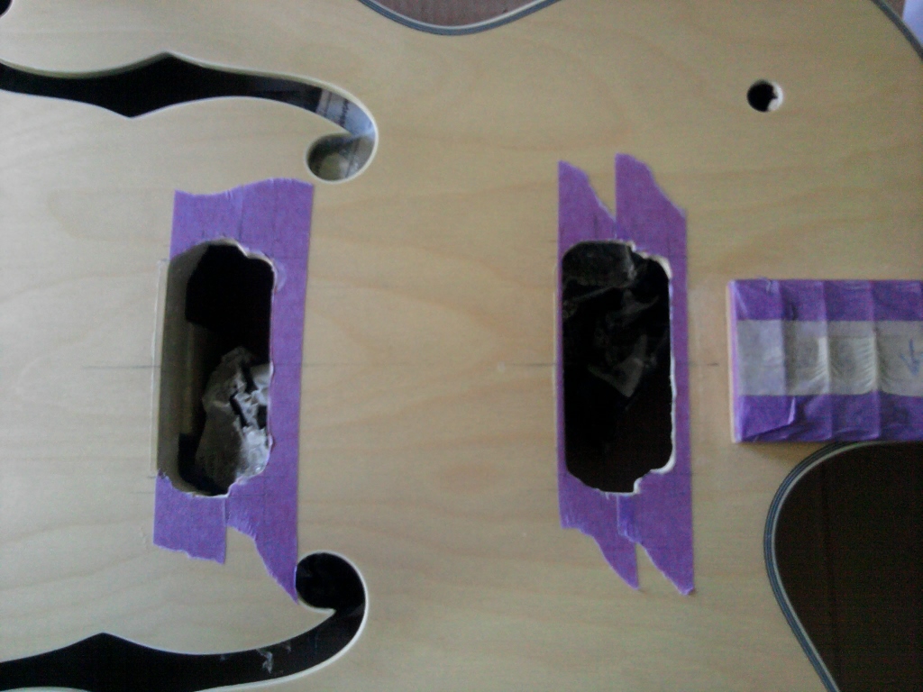

    I cut out the mask with a scalpel to find the bridge pickup would not have room because of the internal bridge post. At this stage I also decided to move the neck pickup closer to the neck rather than centred over the original hole. Removed tape and re-applied then remarked pickup cut out locations. Used purple tape for greater contrast against the timber.

    Used a dremel with small sanding drum. Worked reasonably well. The pickup cavities are now done. Thank goodness the pickup surrounding rings will cover up the asymmetrical blobby looking cavities.

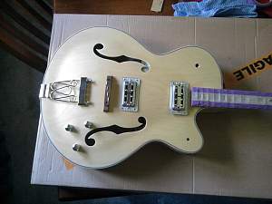

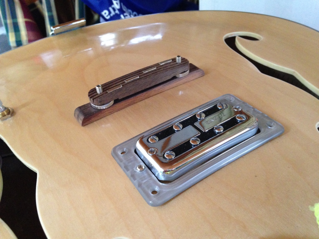

    It's a lot cooler today, 34C. The batteries in the camera are recharged. Shown here are the pup slots still masked and cut to shape. Click image for larger version.
Name:	Photo0462[1] (768x1024).jpg

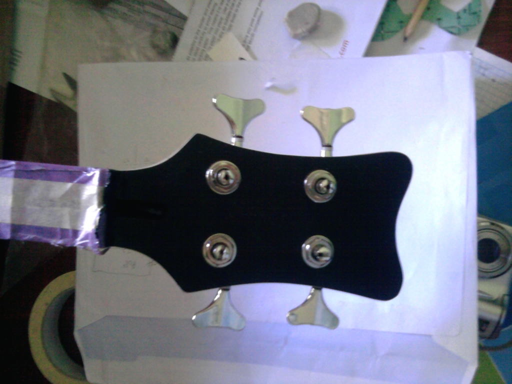

ID:	17209 A mock up of the pups and knobs in position ( I dropped one inside the body. ) and a shot of the headstock with tuning machines. Not a lot of room left for the decal.Click image for larger version.
Name:	Photo0463[1] (768x1024).jpg
ID:	17210Click image for larger version.
Name:	Photo0464[1] (768x1024).jpg
