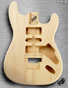

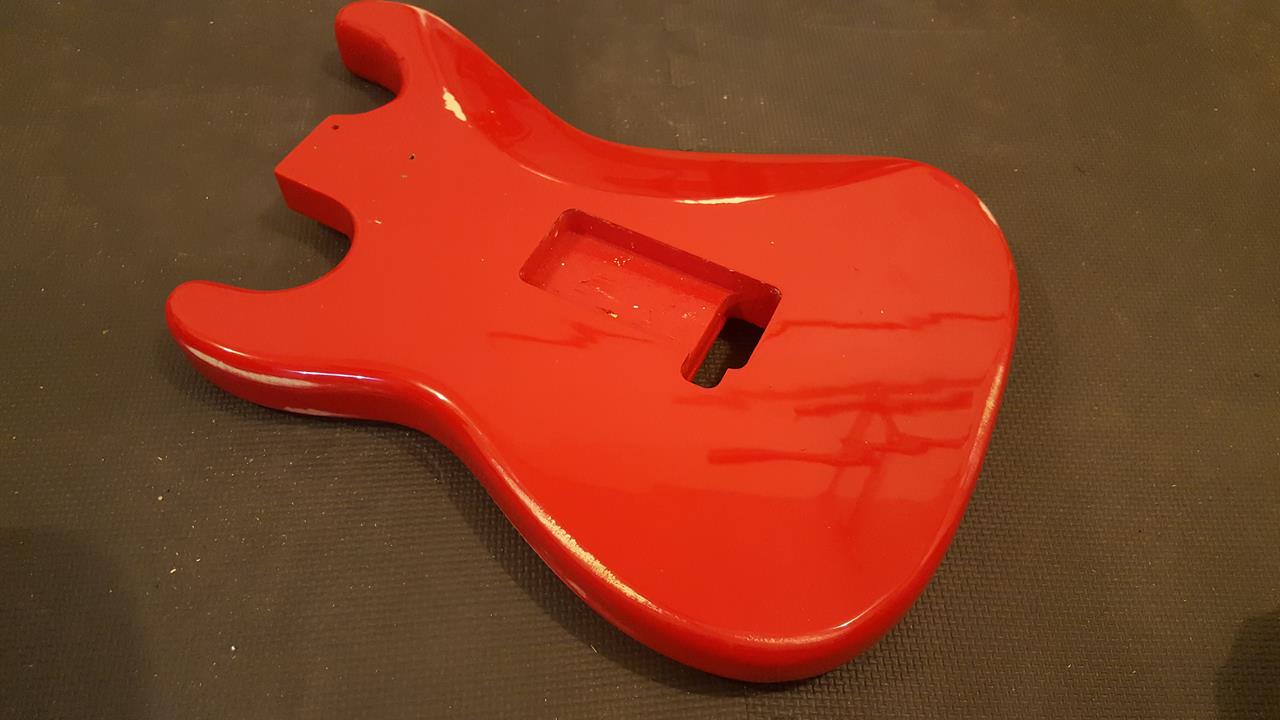

    Onto the body... So as I mentioned earlier I thought I was ordering a traditional strat body, but was sent one with Floyd Rose routing.

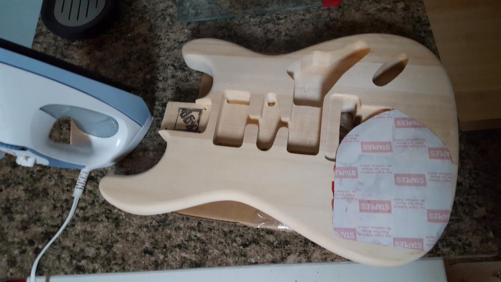

    I did some searching around to try and figure out a way to add DIY graphics to the body and came across a few options (not to say that they are the only ones, I'd love to hear more for future):
    1. mod podge image transfer medium
    2. iron-on t-shirt paper
    3. waterslide decals
    4. stickers

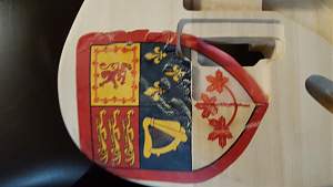

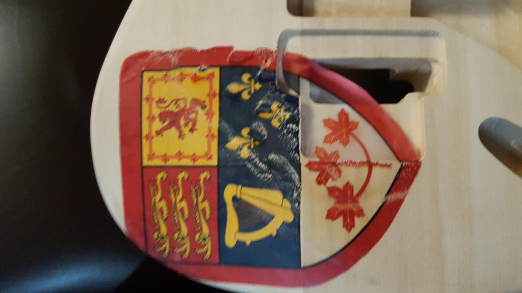

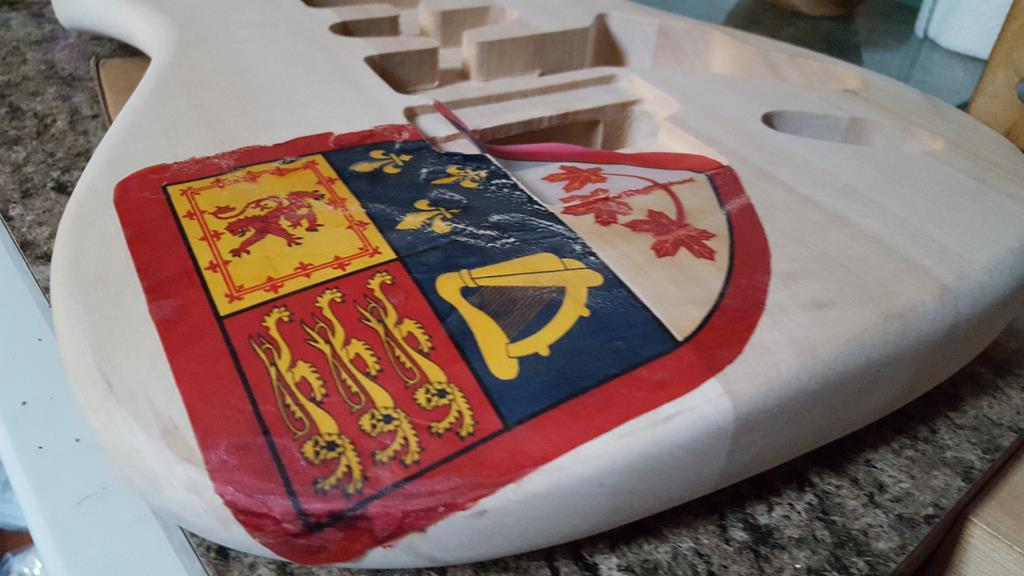

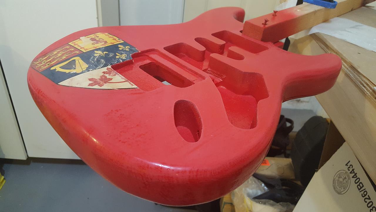

    I actually did get the mod podge, but ended up deciding to go with the iron-on transfers. Dealing with the body contours was a bit tricky, and didn't come out perfectly. This aided in my decision to try and relic the body a bit to give a more consistent look. I also wanted to apply the graphic prior to painting the rest of the body so that the white areas would have more wood grain and because I was unsure how the iron-on would adhere to paint.
    In the end I am happy with the result. Now I just have to make sure to not botch the transition from graphic to paint.

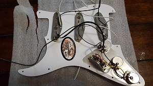

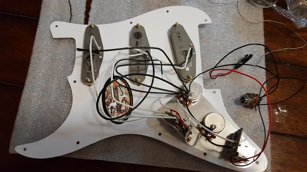

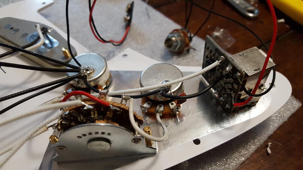

    Time for an overdue update. Sadly no one is willing to pay me to build guitar kits yet so my real job impedes progress. Anyways I thought it was time to wire the pickguard (or scratchplate for my UK friends). I started by throwing my pickups and a pre-wired strat electronics into the pickguard, but had some little modifications to make. I decided to add in the Guitarfetish mid-boost circuit to see how well it could replicate the Clapton signature strat tones.
    This was my starting point.
    And this was where I ended up with the mid-boost.
    Hopefully if this long and dreary Canadian winter ends I can get back to putting a final coat of paint on the body so I can put it all together. I guess it's just more motivation to set up an indoor paint booth.

    I would say that it will be beneficial to you to screen your cavities and the underside of the scratchplate. There's a lot of cables in there to pick-up noise, plus you've got a boost circuit which will amplify any noise picked up. You may also find it beneficial to twist the pickup leads around one another and tape them together. This is how Fender used to do it to minimise noise. e.g.
    I'd also look at reducing the lengths of any cables that can be shortened. Obviously make sure first that the wiring can be routed through the path in the body. But the more wire there is, the more noise that can be picked up.
