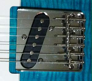

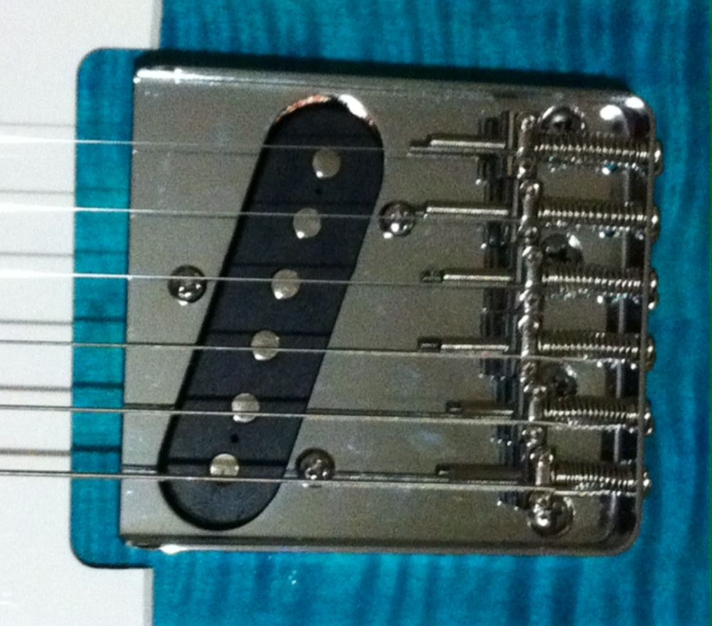

    Cheers guys for the offers of a bridge.
    @ Ponch, I have a similar one that I tried on the Blue Tele and not too keen to attempt string through as that looks the best way for that style to work. Tried to use it rear loaded and the string angles were all wrong and played havoc with intonation.
    @ Dave, I now 2 x PBG 3 saddle style Bridges and was almost going to have another attempt but ordered another 6 saddle one from Real Parts this afternoon which has sides folded up like an old ash tray design. Here it is on Bluey...

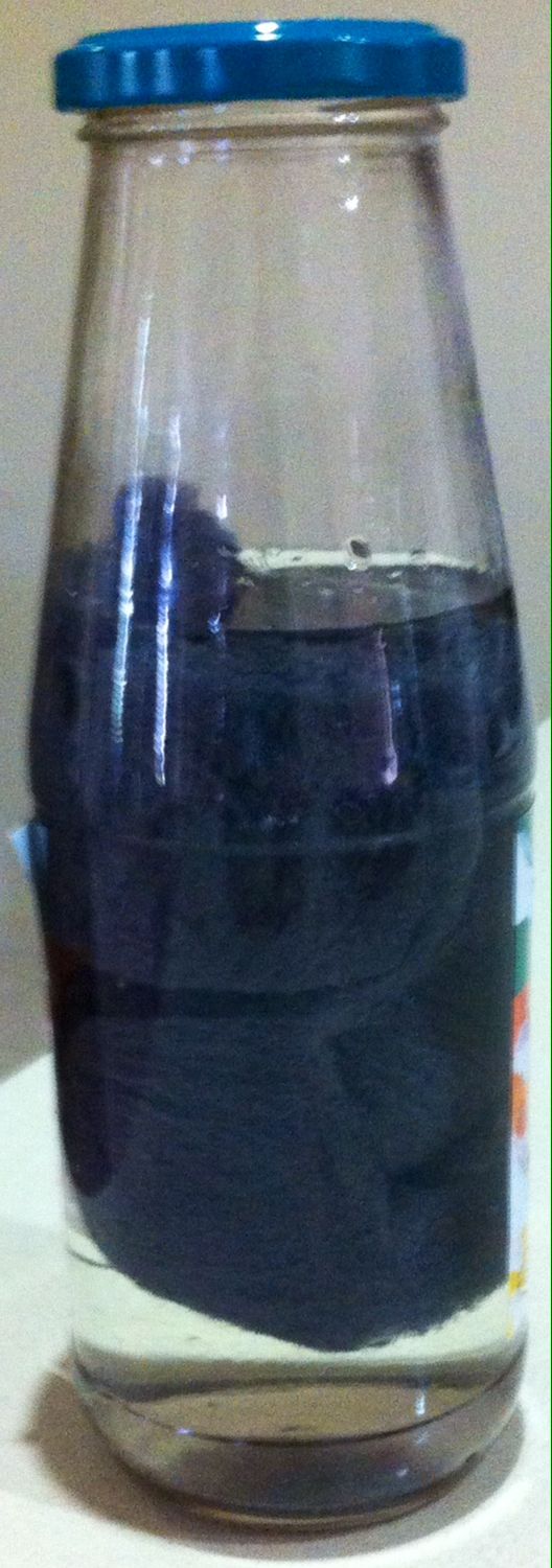

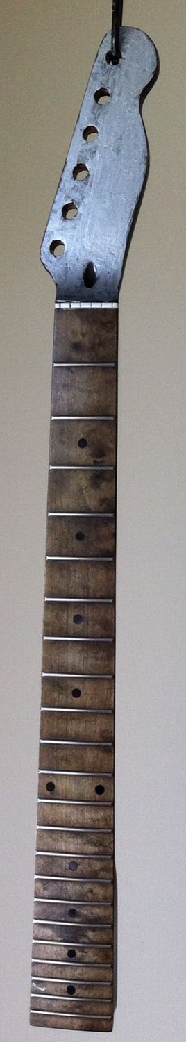

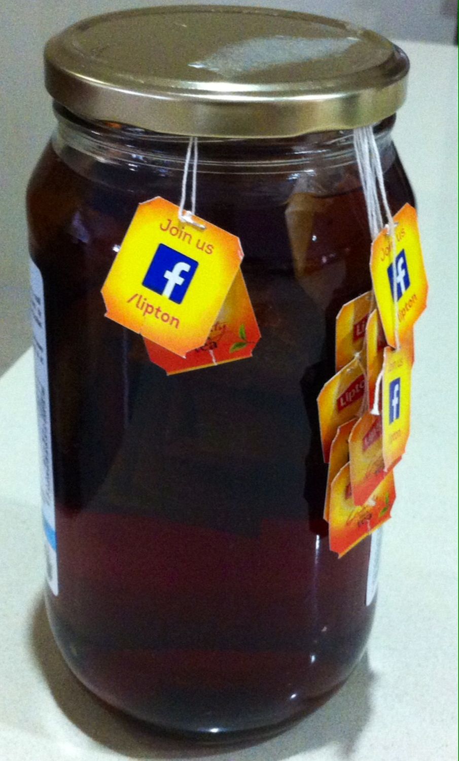

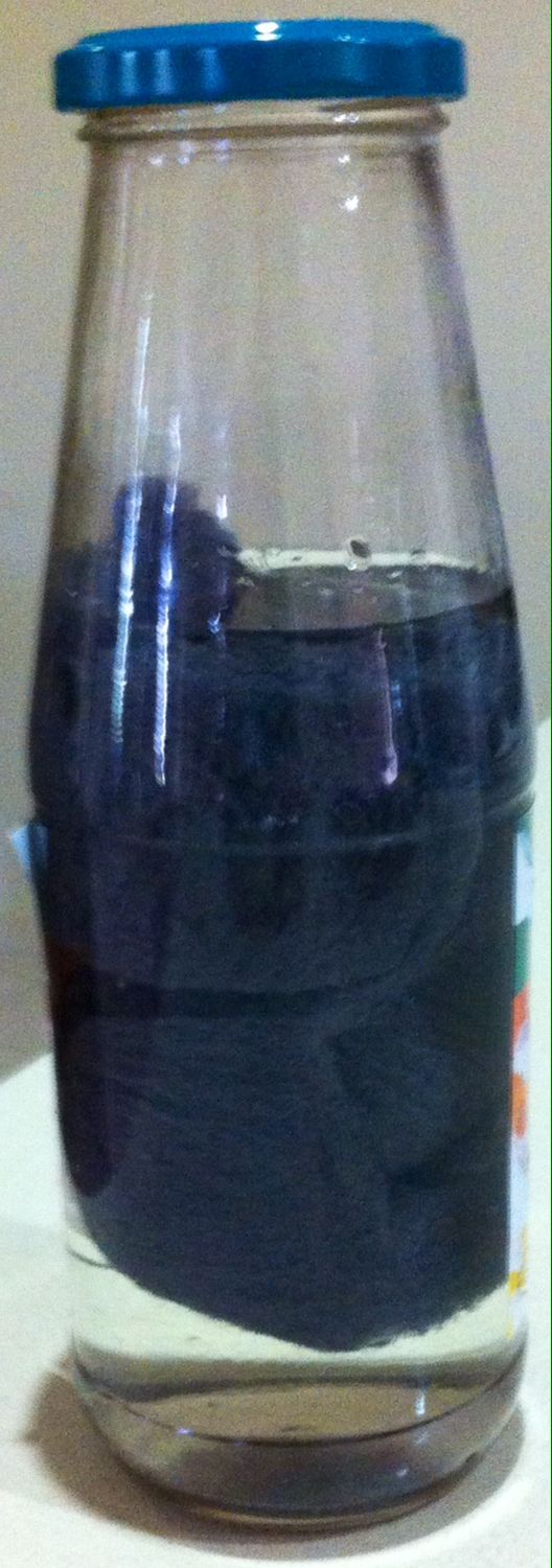

    Beginning of the dark & sinister side project......
Name:	Steel wool in vinegar.jpg
ID:	16430Click image for larger version.
Name:	Tea brewing.jpg
    Bunch of DB's 0000 steel wool from a luthier kit cut up and placed in a jar with 2 cups of white vinegar. In the 2nd Jar we have 10 Liptons Black Tea Bags infusing in 1 litre of boiling water.
  8. #18
    what is this Waz a Waztone stain in the making ?
    what colour are you hoping for ?

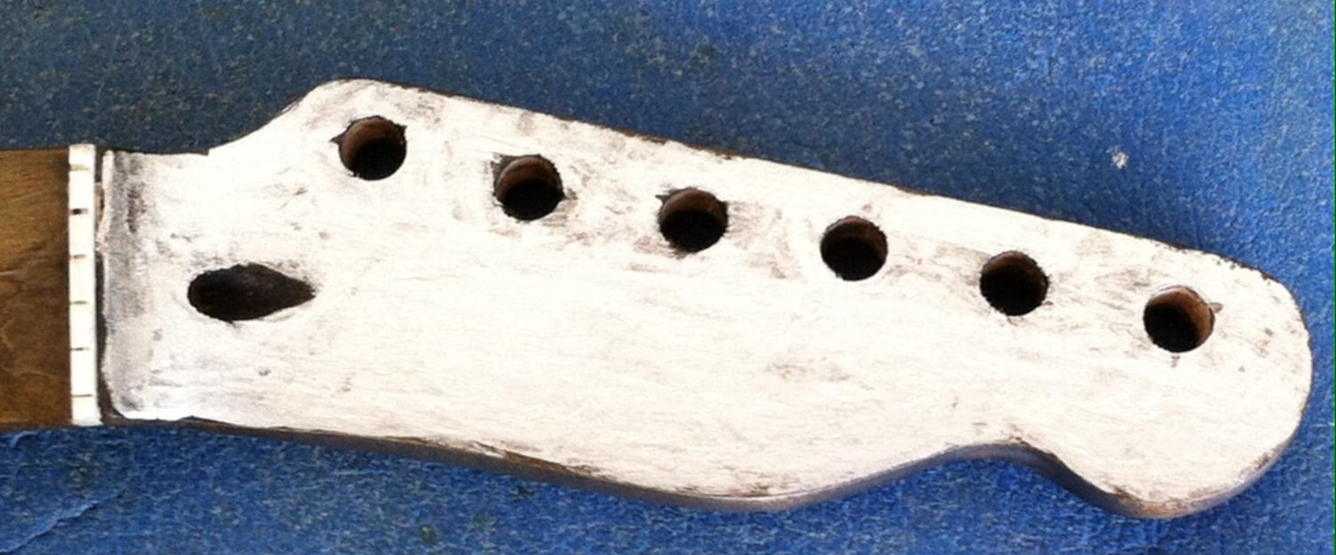

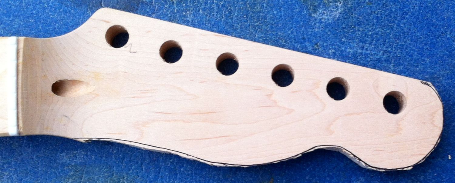

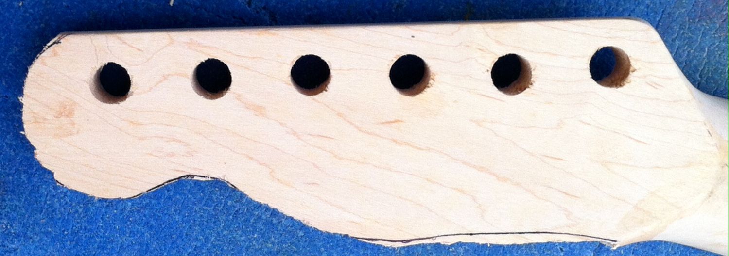

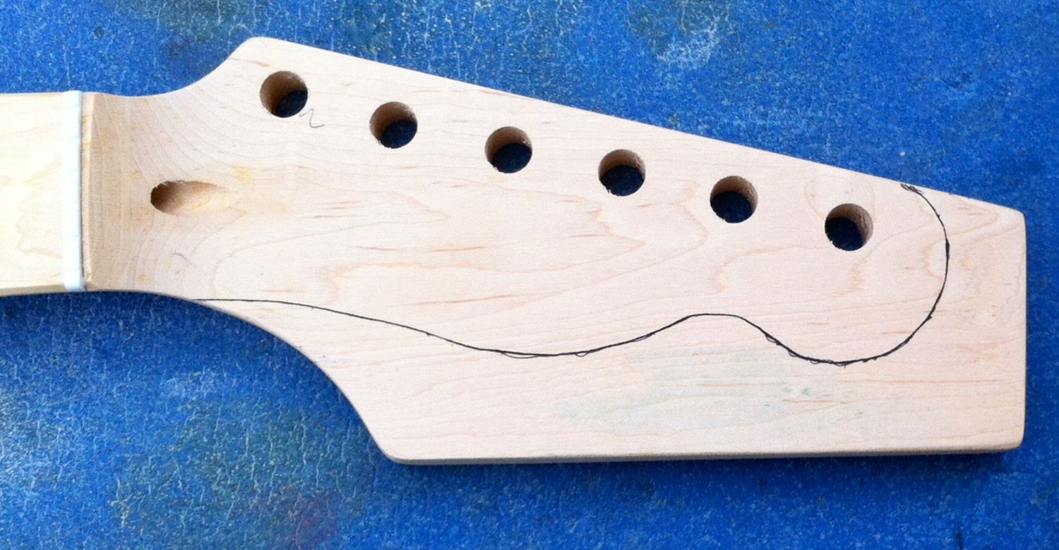

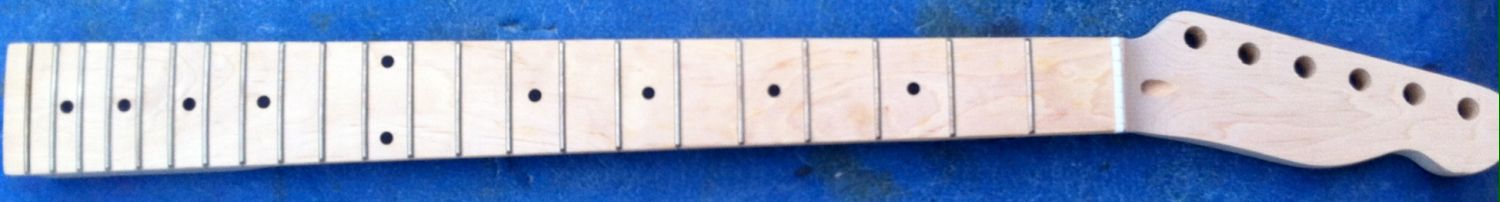

    Headstock shaping day today....
Name:	headstock face drawing.jpg
ID:	16432Click image for larger version.
Name:	headstock rear drawing.jpg
ID:	16433Click image for larger version.
Name:	headstock face rough cut.jpg
ID:	16434Click image for larger version.
Name:	headstock rear rough cut.jpg

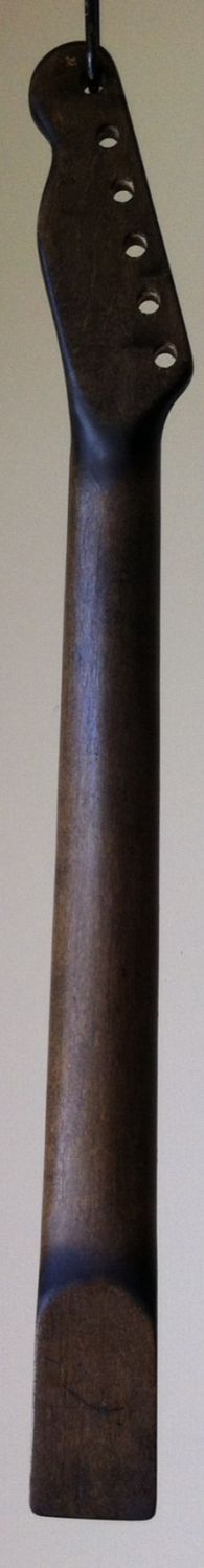

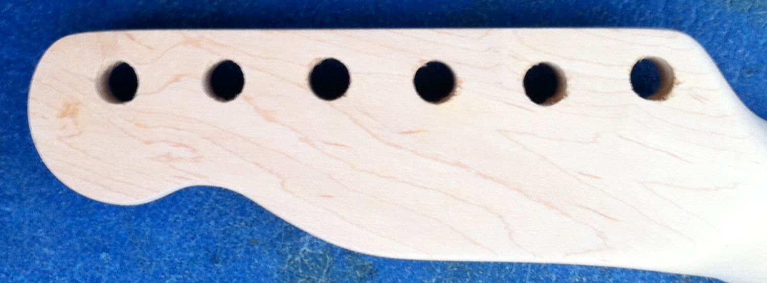

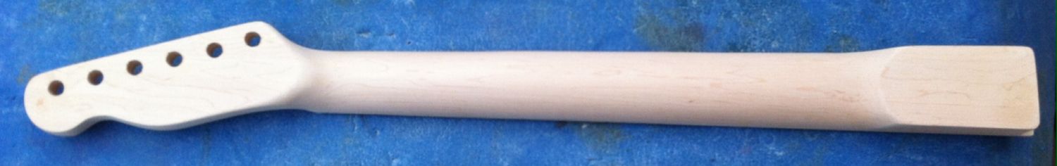

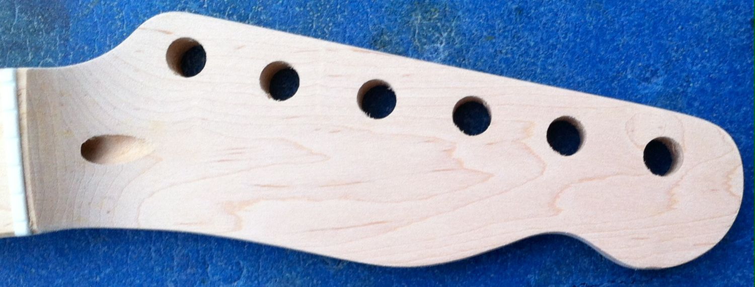

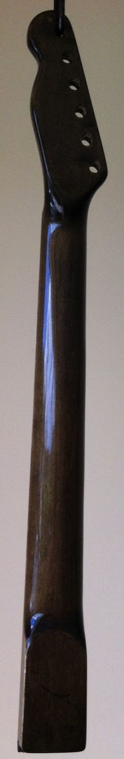

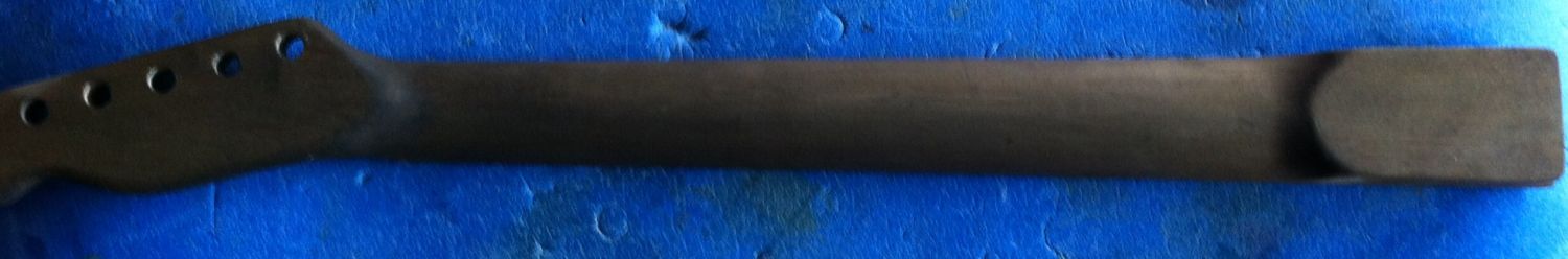

  10. #20
    Amazing what quick work 80 grit paper makes of this sanding job....
Name:	headstock front shaped.jpg
ID:	16436Click image for larger version.
Name:	headstock rear shaped.jpg
ID:	16437Click image for larger version.
Name:	neck front.jpg
ID:	16438Click image for larger version.
    Started sanding the body but as I started late in the day ran out of daylight and the lamb roast was ready for carving.
