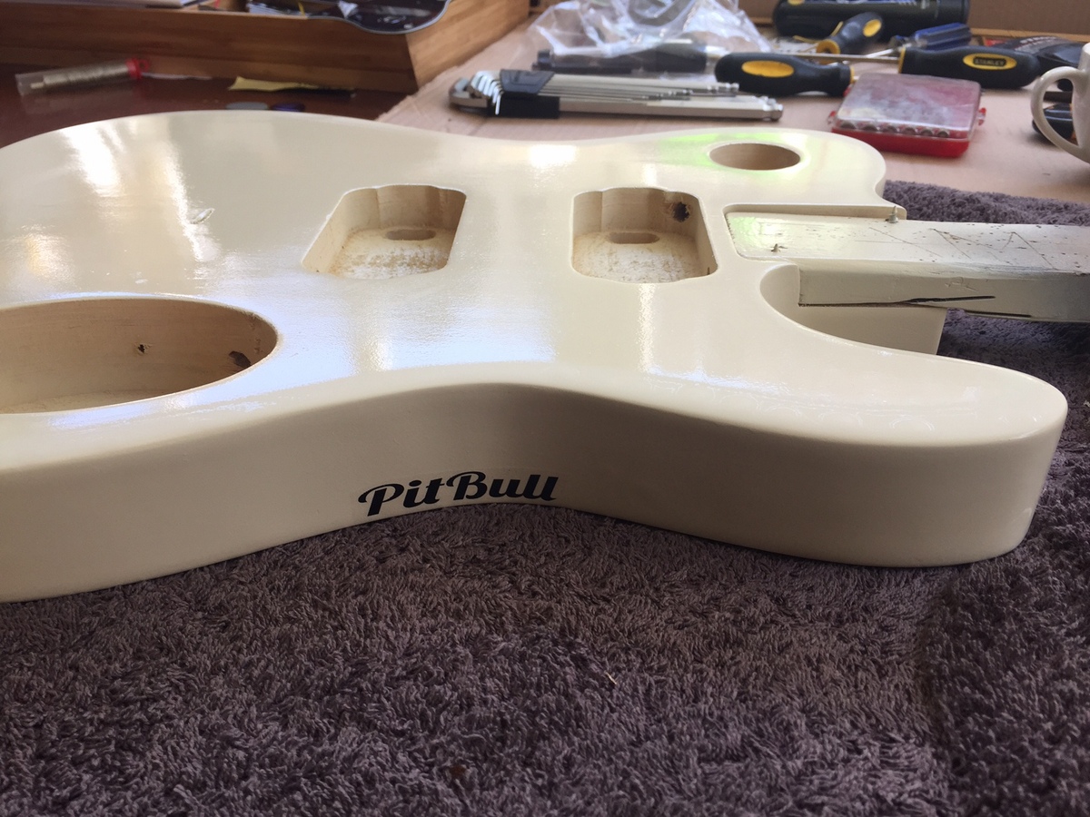

    that expression.....waiting for paint to dry......
    this painting thing is slow workClick image for larger version.

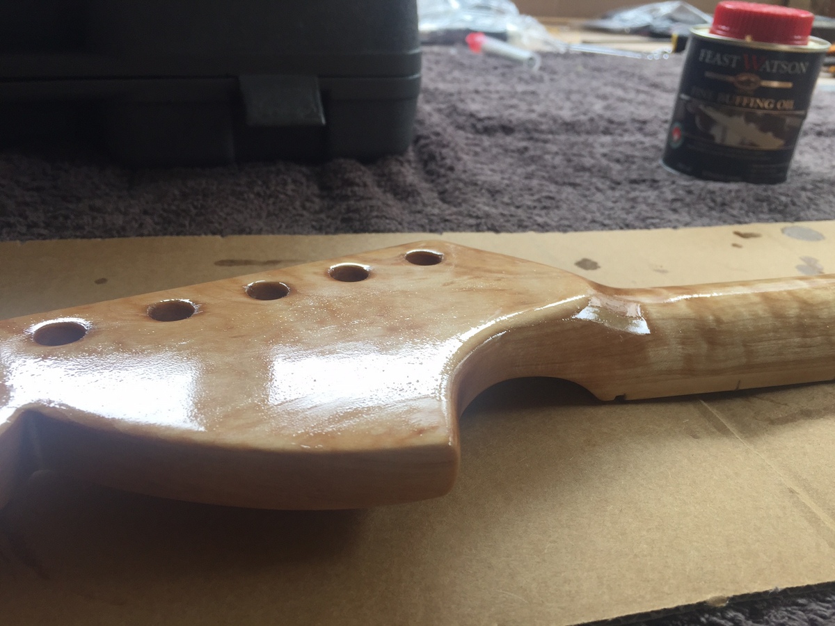

    neck is coming along well too. just used tung oil and fine buffing oil.
