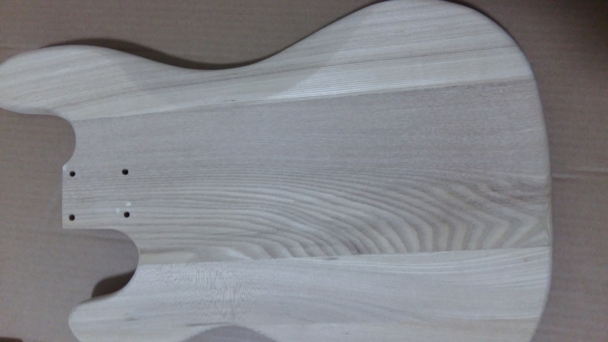

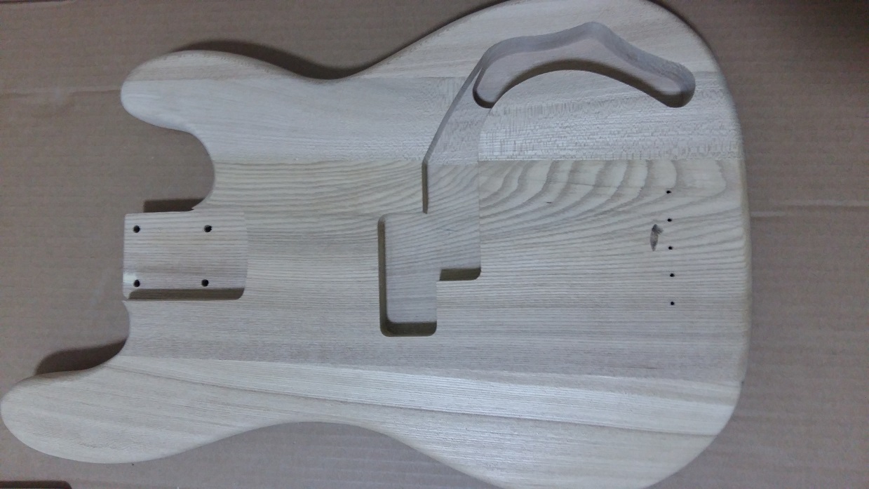

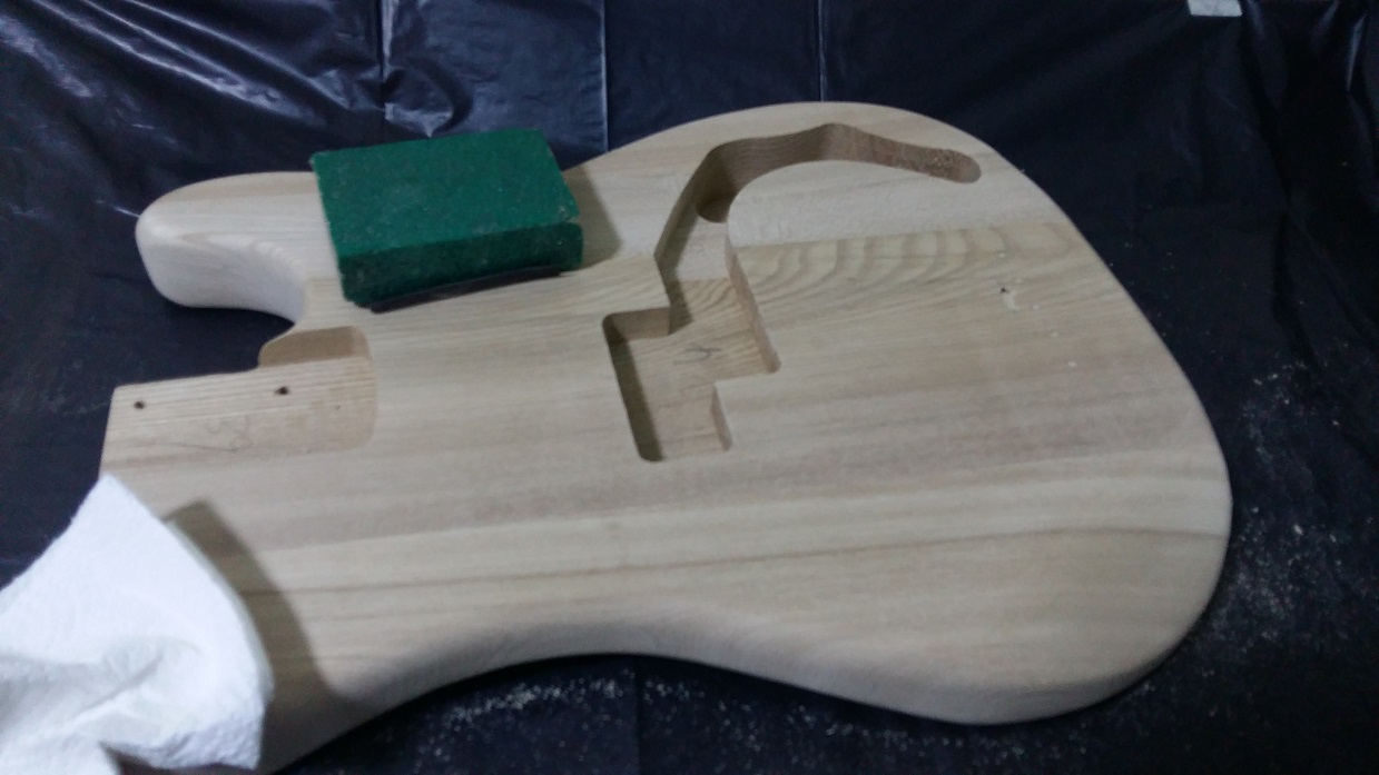

    Day 4&5,
    Start Sanding body out by #120 sanding paper with wood block and hard sponge.
    after sanding on front,side, cutaway, back, neck pocket and cavity.
    came to know it really required a patience and time. got muscle pain after this... but it is really fun!! will continue down to #240, #400 before start filling grain work.

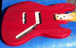

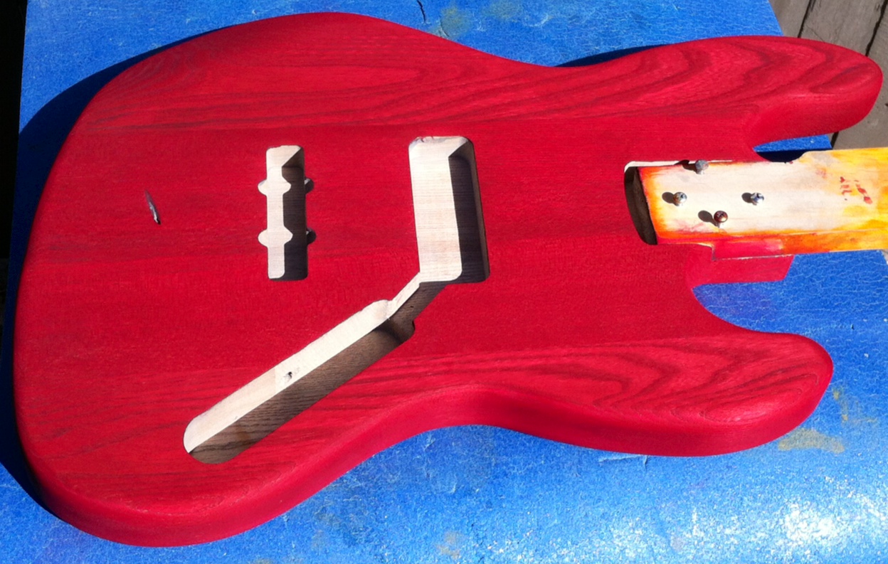

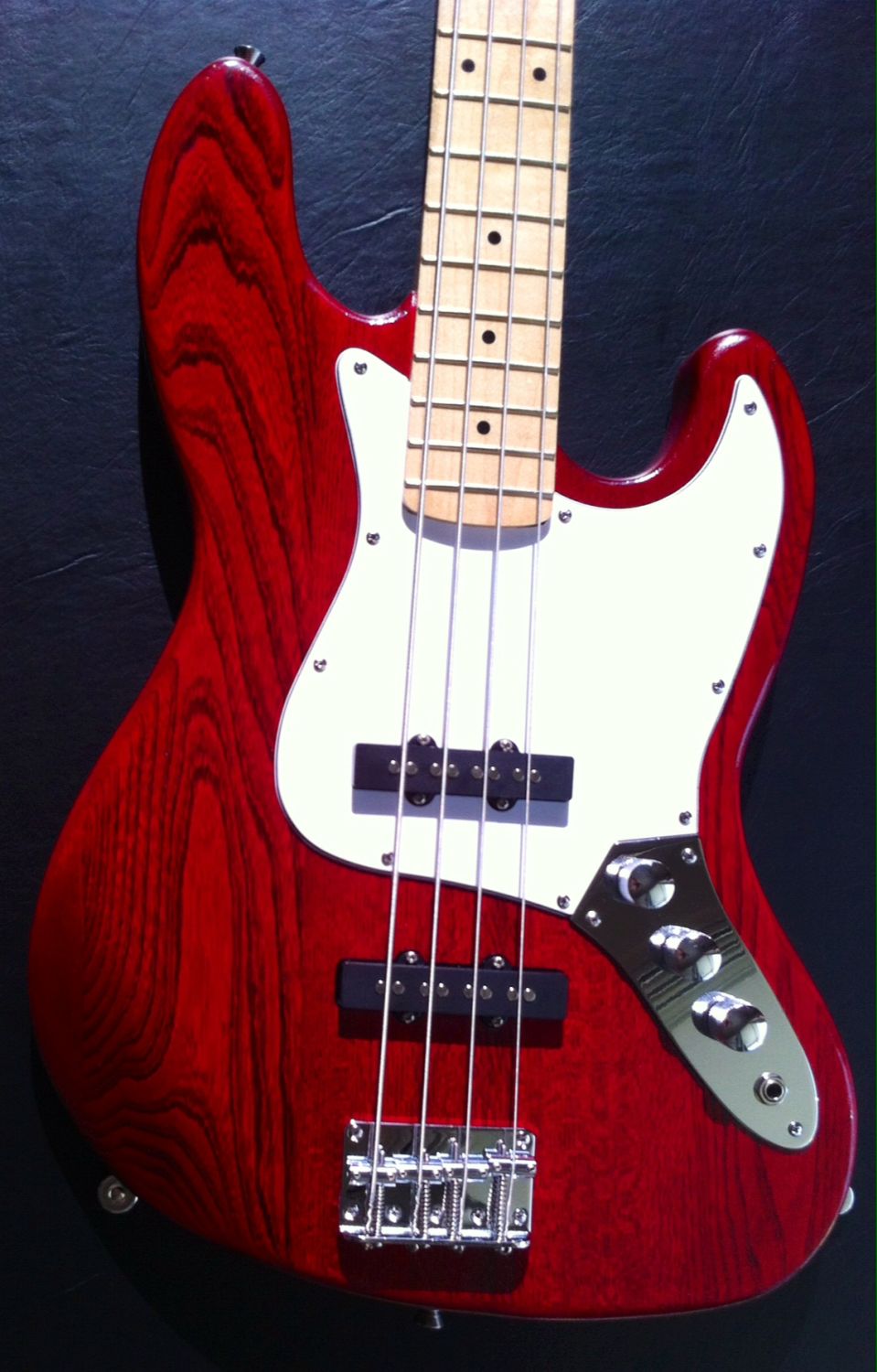

    Hi Toshi, suggest stopping at 240 grit and then applying the grain filler as if you go too much further the grain will close up and not take in as much of the filler. Very important if you are using a contrasting colour to pop the grain. Here is a shot of my Ash J Bass to illustrate what I mean.

    Thanks, Wazkelly!! i was not aware of it and totally agree with you. I would have gone farther... Yup, I am happy to stop at 240 grit.

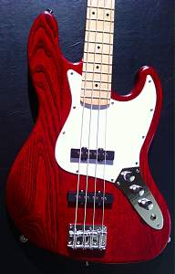

    By the way, that Beautiful red JB is exactly what I am aiming to. Color would be green or blue though, i would like to have that strong contrast on grain. did you apply a grain filler mixed with black stain or something to make the line pop up vividly? actually i was thinking to post this question soon.

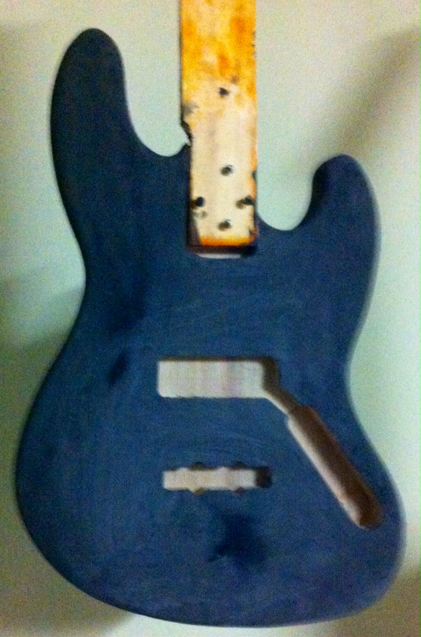

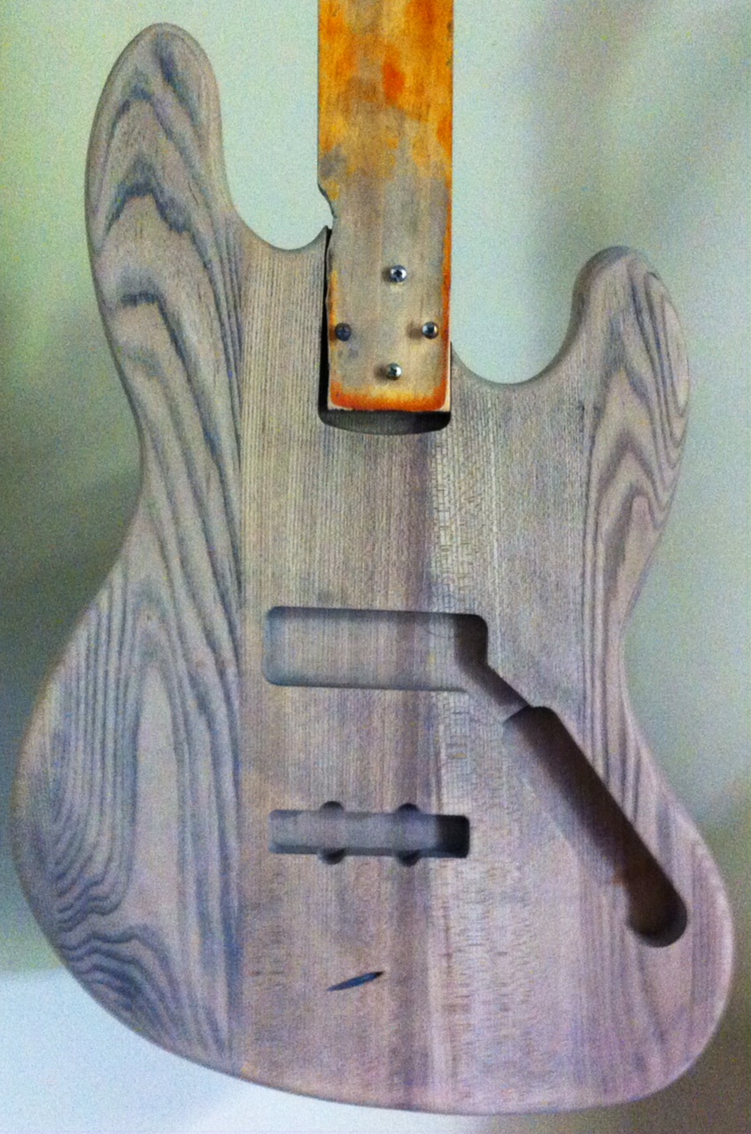

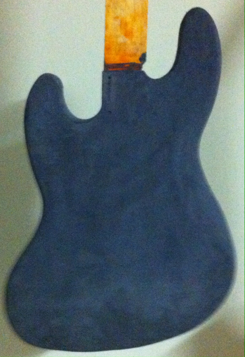

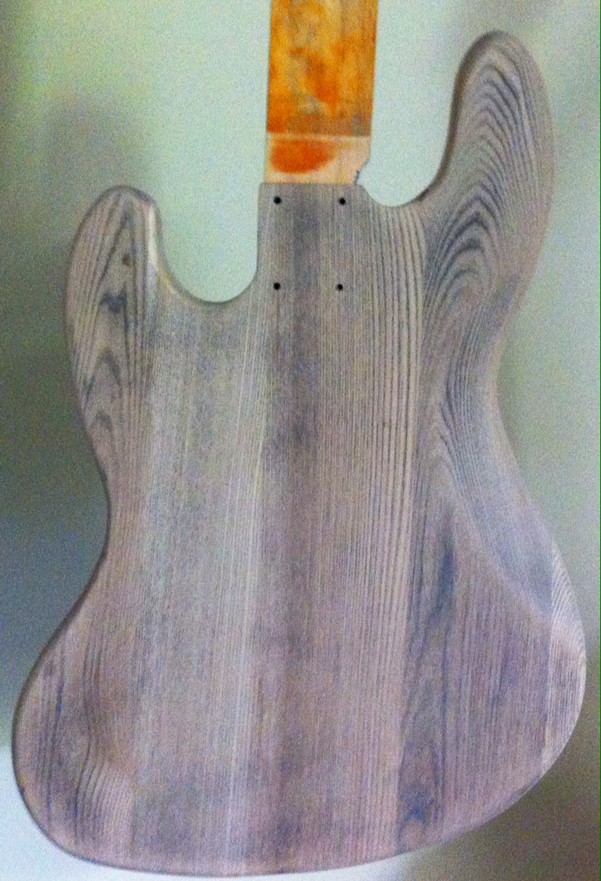

    Hi Toshi, I used ebony timber mate.
ID:	16157Click image for larger version.
    Now after sanded back....
ID:	16159Click image for larger version.
    Then 1st stain of 2 stain coats...
    This method should work with any colour so long as it is not too dark a shade otherwise it blends too much and you lose the contrasting effect.
