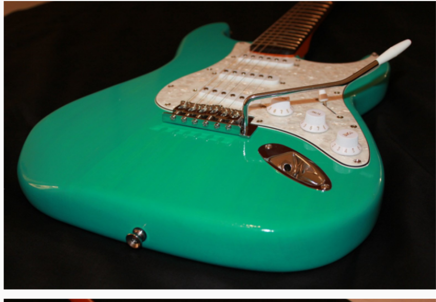

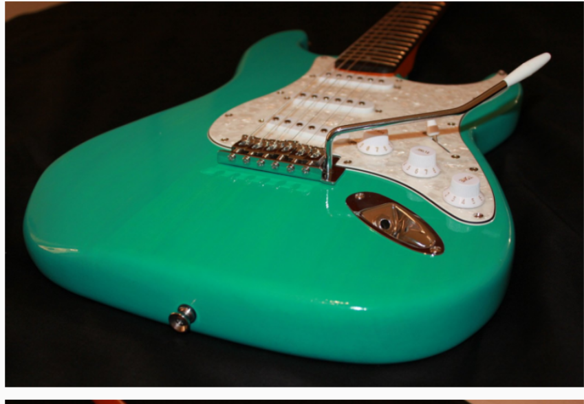

    Looking to find a colour something along the lines of this - but maybe a bit more blue. Any tips?

    Not quite the same but this could possibly get you close
    http://www.pitbullguitars.com/shop/d...tarkine-green/

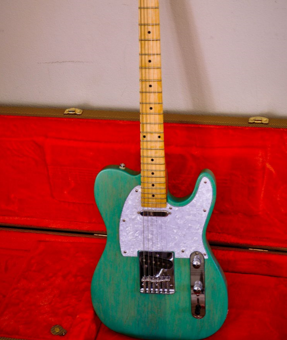

    Been madly researching different finishes I could go for. Really love the look of the Wudtone finishes on lots of guitars on here (surfer girl is sweet)... is there any replacement since PBG no longer stocks it, or even just something similar available elsewhere? Alternatively, some of the colourtone dye stuff looks awesome so I'll look into that too.

    Looking to find a colour something along the lines of this - maybe a bit more blue. Any tips?
