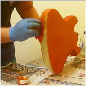

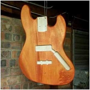

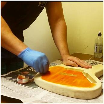

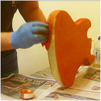

    I purchased a natural tint filler and applied it after scoring the glue line with a sharp blade. After drying I spent several hours this week hand sanding through my layers of paper from 180 to 400 I was happy with the body. Then onto the DT stain application yesterday.

    The back is no where near as solid colour as this picture above looks, that's just the lighting. My application talent is far from great so my result isn't exactly a pro job but I like it since it gives it a rough hand finished look instead of a manufactured feel. Some of the timbermate took the stain, other bits not so much likely due to my application.
    The Bushfire Sunrise looks exactly that, very impressed with the way this colour settled in, the rough job I did when applying has also left what I think looks kind of like flames.

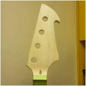

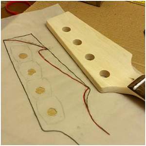

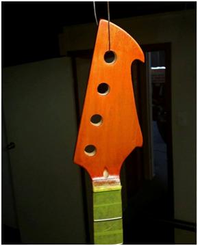

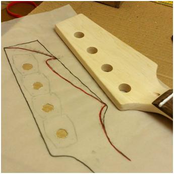

    This then inspired me a bit to change the theme of my bass to match the fire effect so I've shaped out my headstock to be a little more 'flame' style also.
Name:	Neck Layout.JPG
ID:	15952Click image for larger version.
Name:	Neck Shaped.JPG

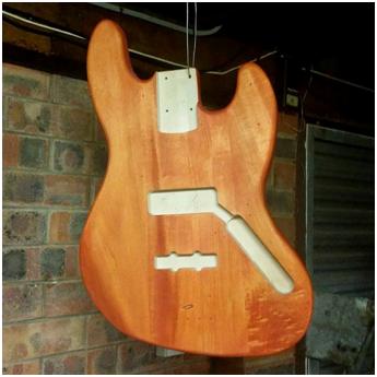

    Now to hang and dry for the week!

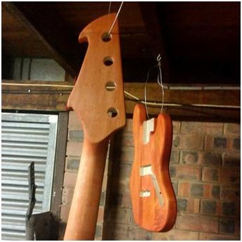

    More pics
Name:	Body Drying.JPG
ID:	15954Click image for larger version.
Name:	Both drying.JPG

    The Dingotone colours often develop/intensify over several days as it dries between coats, so you may see more figure in the wood appear over time. Be flexible with your expected number of coats based on how the colour progresses. Looks good.

    Thanks, at this stage I don't aim to add more colour coats as I wouldn't want too dark of an orange.
    I like it as is though if it develops/intensifies more as it dries this week is totally fine and to be expected as you say. Will be interesting to see the intensifying coat next weekend either way.
