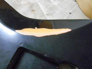

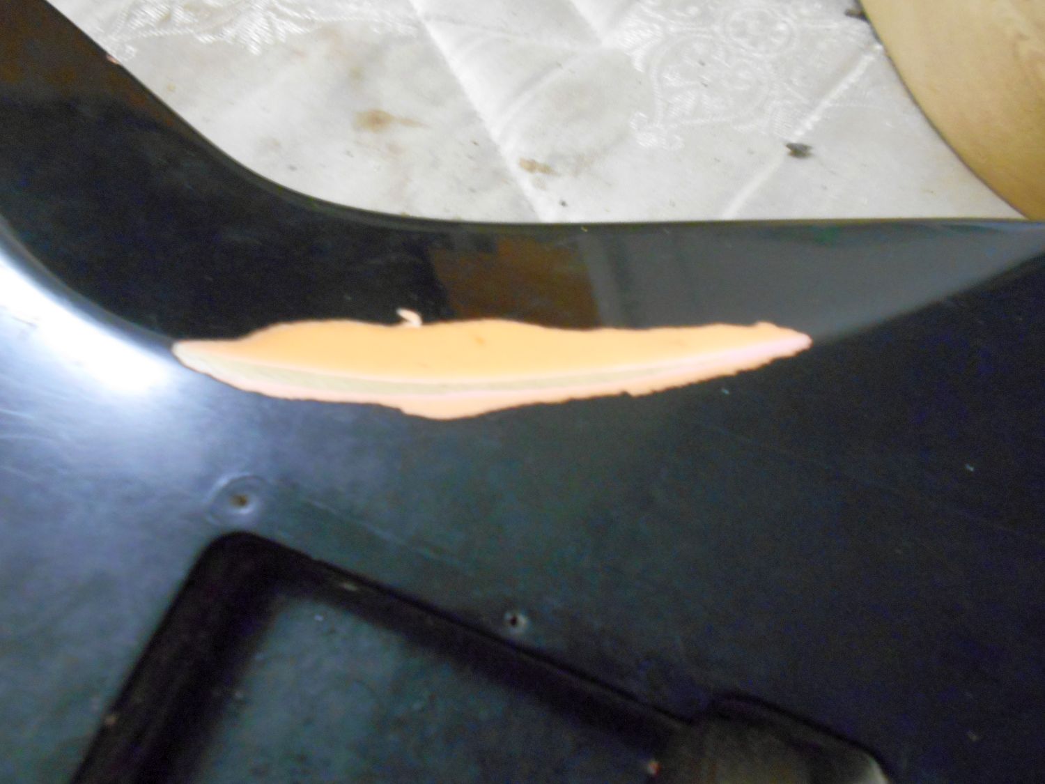

    And here's the close-up pic of the finish wear on the back of the body:
    Not sure if it shows it clearly enough, but you should be able to see the layers of paint on the body, I'm not sure what the cream-coloured stuff is just under the layer of Black Paint, it could be that the previous, or some other, owner decided to re-finish the guitar in Black, I did notice a hole in the control-cavity which had been filled-in prior to the body being re-finished in Black Paint.
    I was just thinking that it would have been unlikely that the headstock logo survived a respray (and certainly not with the original maker's name on), so it's probably a factory finish. Maybe there was a flaw in the original finish so they re-sprayed it black to hide those flaws? Quicker than stripping it back to wood and starting all over again. Both Gibson and Fender have been known to do that.
    It's possible, the neck is actually not the original one that came with the body, the mate who gave the body to me also gave me an all maple neck, which I suppose I could use with the body, but it needs some TLC work done on it, the frets need re-leveling/re-crowning, the fretboard is really grotty, and is coming away from the neck where the nut-shelf is, I'll see if I can get some pics of it posted, I have a feeling that it is an actual 80's Charvel neck, actually, I just had a look at the headstock and I can just make out the Charvel logo on it, would be cool if I can get the neck reconditioned.

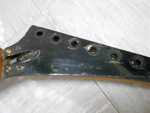

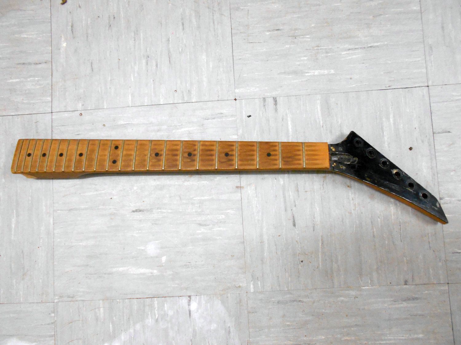

    Here are the picks of what I strongly suspect is an actual Charvel neck:
Name:	Charvel Neck_resized.jpg

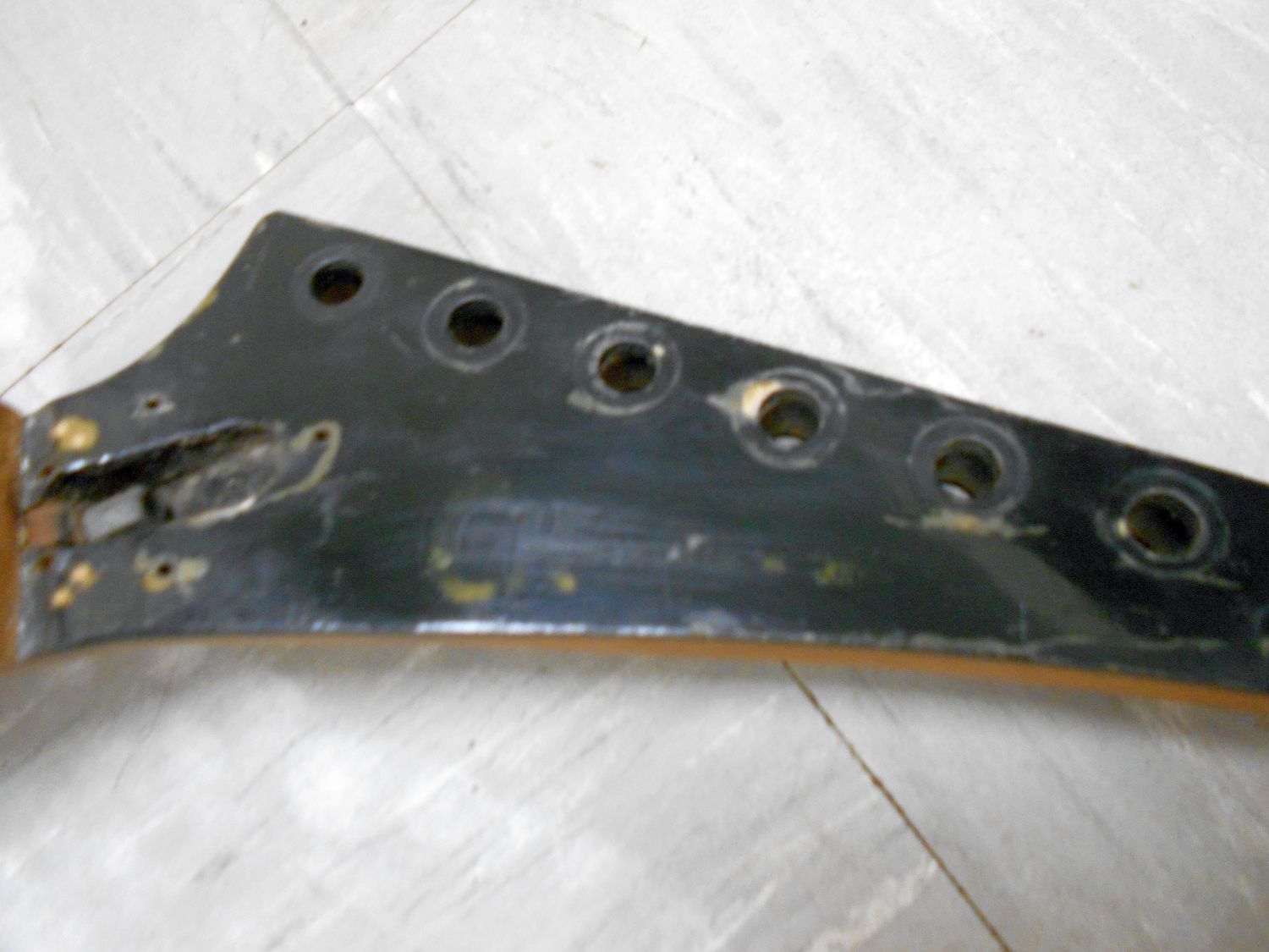

Name:	Charvel Headstock_resized.jpg

    See the faint outlines of the headstock logo?, that looks suspiciously like the Charvel logo to me.

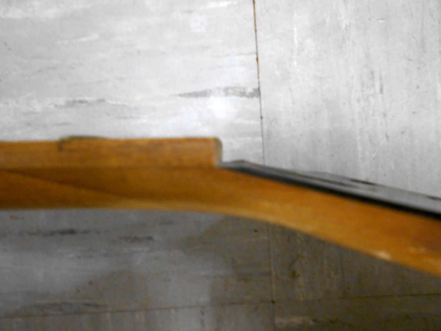

Name:	Neck Side_resized.jpg

    Might be a little hard to see, but just where the nut-shelf is, the fretboard is starting to come away from the neck, I think it should be fixable with some Titebond.

    I think you are spot on about it being a Charvel neck, Doc.
    Now i see why you love blue, great explanation.
    It shouldn't be too hard to fix the neck up, it seems totally usable. Frets out, clean up, wick some slightly watered down titebond into the fret board that's lifting and a rub down and refinish - you'll learn a lot from doing it. I learnt heaps from saving the neck on my jazz guitar project - still unfinished, you'll be fine
    Yes, a Charvel logo. Thought at first it might be a cheaper Charvette, but the 'h' in the Charvete logo is lower-case, not upper as here, so definitely a Charvel. The Gibson style hex-nut truss-rod, rather than a hex-socket one, suggests something less ordinary as well, and some pointy-head Charvels certainly had them.
