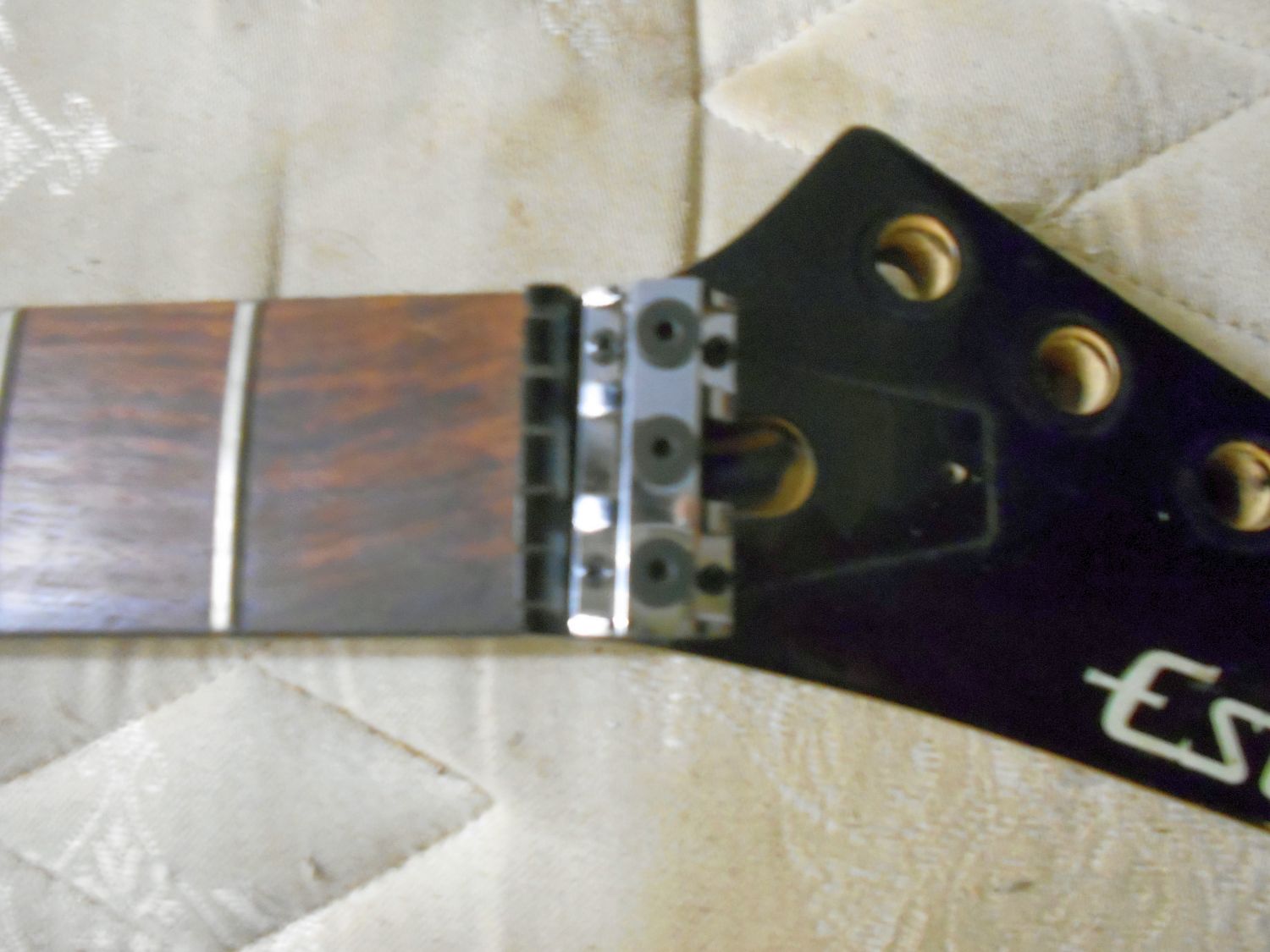

    I managed to get the Kahler String Lock mounted on the Headstock of the neck, all that needs to be done is to re-shape the Truss-Rod cover so that it can be fitted back into place.
    any photo's please Doc ?
    5,548
    Hang on a sec, I'll just take one now and post it shortly mate, I just got lucky and found a black plastic Humbucking Pickup mounting-ring that I can use on the Superstrat body.
    Here you go mate, I know that it looks a bit slightly out of whack, but I really don't think it's going to have an adverse effect on the guitar's performance:
Name:	String Lock_resized.jpg

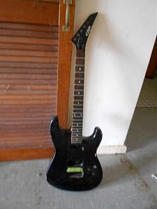

    So, here's what I've worked out for the Super Strat build:
    * Make it look like an 80's Charvel Model 2 Superstrat, finished in Metallic Blue.
    * Keep it simple and go for a single Bridge-Humbucker Pickup Configuration with a 500k Log Volume Pot.
    * Go with a Tonerider Octane Humbucking Pickup (The original Charvel Model 2 used a very high-output Humbucker that measures something like 15k Ohms), I could quite easily use a 500k Push-Pull Pot to implement the coil tapping.
    * Use either a Chrome Schaller Lockmeister Floyd Bridge, or a Chrome Kahler Bridge.
    * Use a set of 6 In Line Chrome Gotoh Tuners same like the ones used on the HotRod Strat.
    * Of course, I'll also add a set of Chrome Ernie Ball Strap-Locks too.
  6. #16
    so Doc why doesn't the string lock look flat ? It will look out of place if it's not parallel with the nut.
    You might as well start a new build diary mate in Non Pitbull gear so people can search for super strat and find it easier.
  7. #17
    5,548
    Good point, I'll start the build-diary this afternoon, I think the String Lock doesn't look flat for a couple of reasons, firstly because I was a bit off when I drilled the holes-i.e. my own incompetence....lol..., I can easily fix that though, secondly, the back of the nut is slightly concave rather than straight, but I will fix it so that it looks better.
    The Headstock is angled-back from the neck, like those on Ibanez guitars.
    I think I've got my "mistake" all sorted out now and the String Lock is sitting a lot more parallel to the nut, thank goodness that it was a relatively easy fix, just some small splinters of wood and some PVA glue is all it took, oh and some elbow-grease too.
