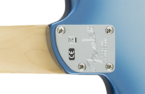

    I'm trying to think of any other areas that could be improved. What do people think about a cutaway heel? Here's Fender's own version on an American Elite Strat.

ID:	15713Click image for larger version.
    Would something like that be worth it, or do people feel it would be too small a change to make any real difference to upper fret access?
    There is of course nothing stopping anyone from doing this themselves and buying a 3rd party neck plate, as long as the neck came undrilled, otherwise the original neck-end high E side screw hole would be visible.
    Any takers for this as standard, or leave as a DIY option (as long as an undrilled neck was available)?

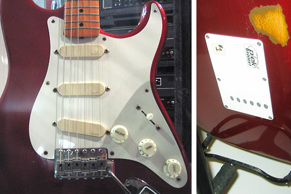

    I've just emailed Adam a new pic of my HotRod Strat, he's going to show it to the workers in the Factory in China, so, it looks like this kit idea will become an official PBG kit......awesome.
