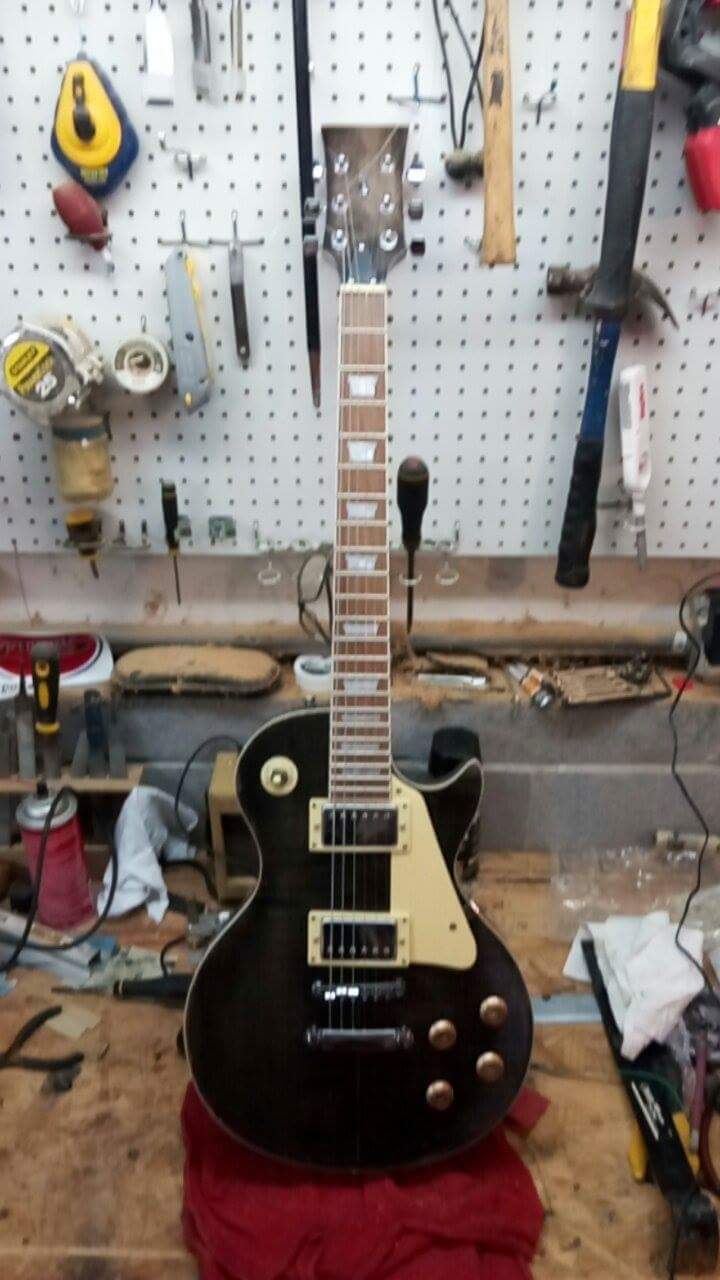

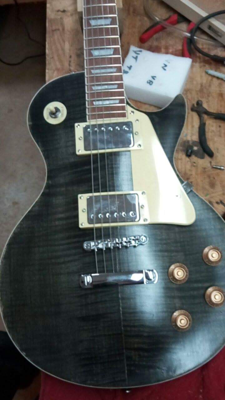

    Finished guitar. .
    Need to get better pics but I'm pleased with the results

    Nice looking build Crank! Well done.
    One suggestion, and this is purely a personal thing, but I would change the volume and tone knobs to a matching colour to the pick guard and pup surrounds. I like things to match!

    I had the same thought. These are what came with the kit. I recently got a 3D printer... Think I'm going to try printing some knobs.
