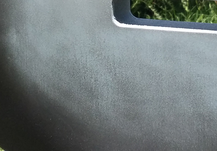

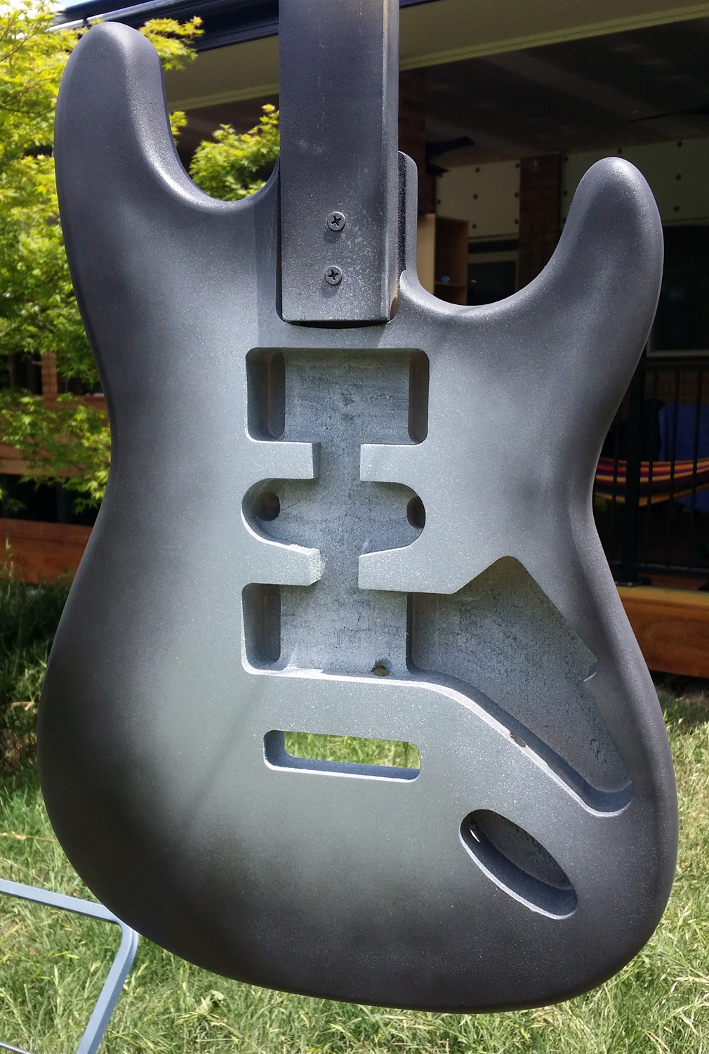

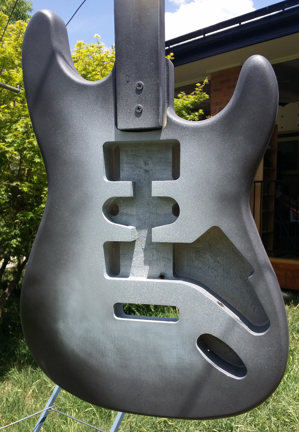

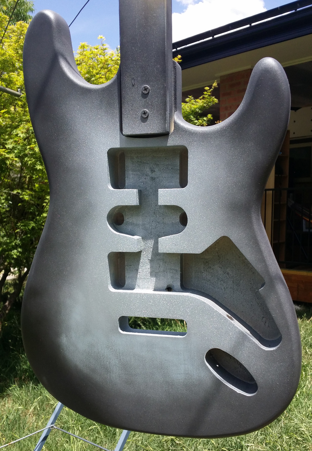

So after a couple of weeks of raising grain, sanding, filling, sealing, priming, I sprayed a couple of layers of the sparkly silver. I'm pretty happy with the coverage - it was pretty fiddly work. The metal flecks clog the nozzle pretty frequently, so I ended up in a routine where I'd spray for 5-10 seconds, then dunk the nozzle in some metho, swirl it around, shake it off, and spray again.

At this stage, it's looking super fabulous. Blindingly glittery. If it was a present for Taylor Swift, I'd be clear coating by now, but instead, it's ready for some smoke.
