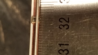

    Looking at your measurements, it looks like you are measuring to the fret board marker, this is not the correct place to measure to.
    Make sure you are taking your measurements from the top of the metal fret, or what is classed as the crown of the fret as mentioned above.

    That gives a value of 629.539mm (± 0.5mm) from the fretboard edge of the nut to the centre of the treble-side post.
    It also says that the bass-side post should be 1.5mm - 3mm further from the nut.
    That's a line that's drawn perpendicular to the nut (you'll have to extend the nut line out a bit), and not from the corner of the nut to the bridge post position.

    Ah - I see what I was doing wrong. Appreciate all the help!

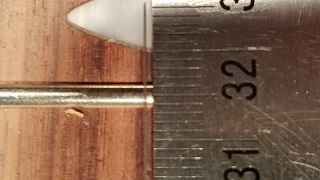

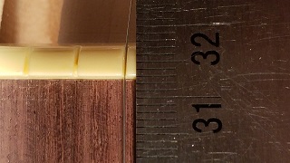

    I think I got it this time

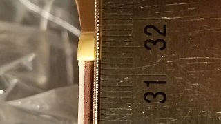

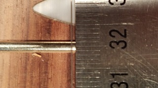

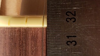

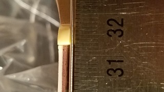

    Saddle to 12th bass:318
    Saddle to 12th treble: 315 (just under)
Name:	saddle to 12th bass.jpg
ID:	15464 Click image for larger version.
Name:	saddle to 12th treble.jpg
    Nut to 12th bass:312.5
    Nut to 12th treble: 312.5
Name:	12th to nut bass.jpg
ID:	15466 Click image for larger version.
Name:	12th to nut treble.jpg
  8. #18
    Mentor Zandit75's Avatar
    May 2016
    Penguin, Tasmania
    1,617
    That looks much better!!
    I personally don't think you have any issue there, but one of the other guys will confirm. I'm just a newbie also!

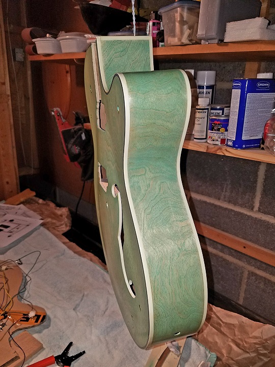

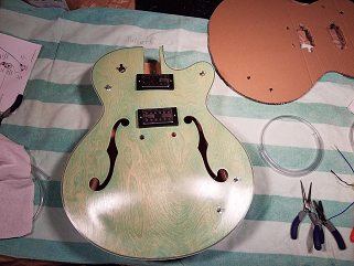

    OK.....completed sanding and applying finish...
Name:	Side finish.jpg
ID:	18178 Name:  Front Finish.png
Size:  93.8 KB Click image for larger version.
Name:	nech finish.png

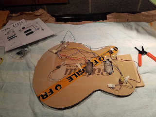

    Then completed wiring and installing electronics....
ID:	18181 Click image for larger version.
Name:	Electronics installed.png

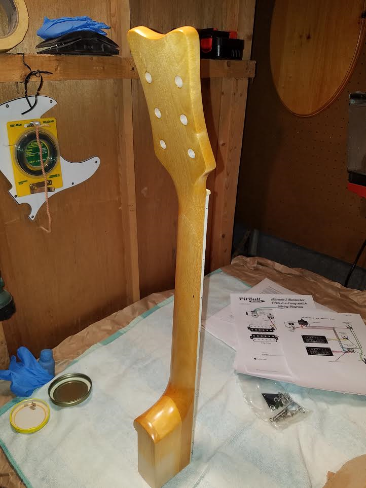

    Getting ready to install machine heads, the bridge / trapeze tailpiece, then the neck and fastening pick-ups.
    I instructional video for glue on neck isn't active. I watched the one for bolt-ons. Are there any tricks for setting a glue-on neck? The rough fit appears to be good, so I was going to apply glue to the neck and body and then clamp it down with protection for the guitar.
