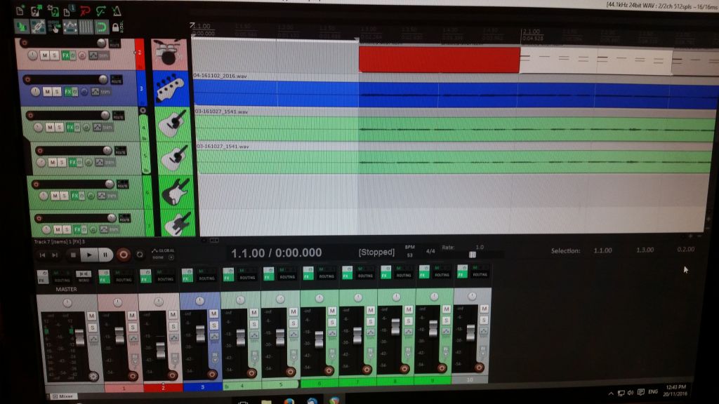

    I most likely did, it's been a while since I purchased my $60.00 license so my memory's a bit rusty, I'm running Windows 10 Home 64 Bit on both my Desktop PC and my Dell Inspiron 15 Laptop, both computers run the same music production software so I can transfer project files from one to the other, I'm using my Focusrite Saffire Pro 40 Firewire Audio Interface with my Desktop PC because my Digi002 died, my sample-rate is usually set to 44,100/16 Bit, I'll have to do some more reading of the Reaper manual, while I'm at it, I'll need to read the user manuals for Ableton Live, FL Studio, and Reason 5 too, I just recently upgraded FL Studio to version 12.4, and in the process I bought a new plugin called Transistor Bass, basically it's a plugin emulation of the old TB-303 Bassline Synthesizer/Sequencer, I used to own an actual TB-303 but it got stolen, it was a real cool bit of 80's retro kit, a bit frustrating to program with it's quirks, foibles, and idiosyncrasies, but the Transistor Bass plugin makes things so much easier, and it gets that sound, I was lucky to get it for only $49.00 (approximately Au$60.00), IK Multimedia offer a real Bass Guitar plugin emulator called Modo Bass, looks interesting.

    I'd immediately advise you to swap to 24 bit recording. With 16-bit, you need to get the recording level as hot as possible (without overloading and getting digital clipping) to maximise the theoretically available 96dB (in practice a bit less) of dynamic range and headroom above the sysytem noise floor. With 24 bit, you can run at much lower input levels e.g. -18dBFS (which is still 21 bits of data) and get a much better theoretical dynamic range and a lower relative noise floor. All the time you are recording at say -1dB or -0.5dB, even though you may not clip digitally, inter-sample peaks mean that when the D/A converter will clip the sound produced.
    You should have somewhere in your software (or find on the web) a true peak meter, which calculates the levels of inter-sample peaks (ISPs). Use it as the last insert on your master bus, and this will tell you if any of your recordings will distort. ISPs are worse on waveforms with sharp, near-vertical, leading edges (such as true square waves) and percussive transients, where they can be almost 3dB above the maximum recorded digital value. ISPs exceeding 0dBFS are one reason why some recordings sound really nasty when converted to MP3s etc.
    So always 24 bits, and take things easy on the recording levels.
