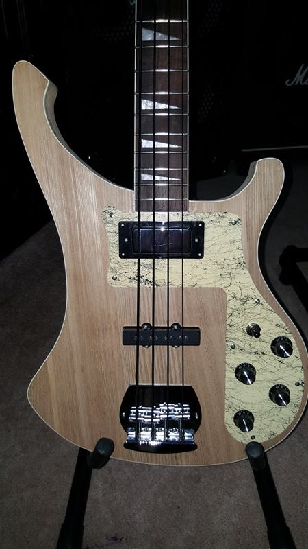

    That looks great! Did you get all the electrics wired up correctly and working without too much bother?
    Thank you Simon. Yes, got them all working properly the first time. I just followed the wiring diagram online here.
    RCA-4 Completed.
