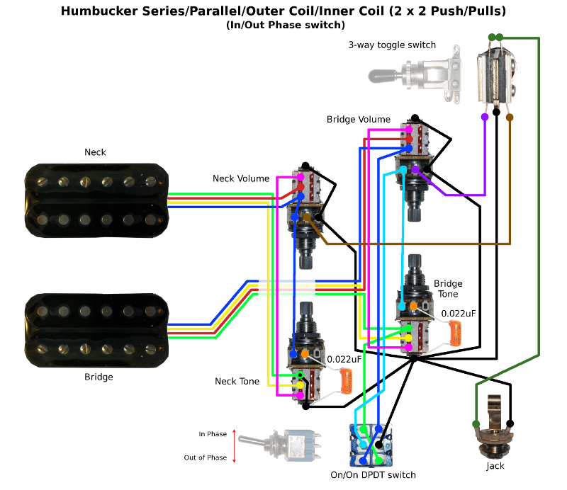

    Yep, something like that layout for separate humbucker/split and series/para push/pulls.
    Any On/On/On double-pole mini-toggle, preferably a lot cheaper, should be fine.
    Wired something like this for the mini-toggle:
    For the inter-linked push/pulls option I don't have a bridge only diagram drawn up, but this should give you the basic idea. Just look at the neck volume and neck tone wiring and ignore everything else (including the phase toggle switch).
    Volume and Tone down: series humbucker
    Volume and Tone up: parallel humbucker
    Volume up, Tone down: screw coil
    Volume down, Tone up: slug coil
    (depending on your configuration)

    Scott, thank you! I need to fill the old output jack hole with something as re-finishing the front is a non-runner; I've re-sited the output jack to an Electrosocket side mount so an on/on sounds like 'the go' there!! Just a bog standard DPDT switch?
    Is this diagram pretty close?
    http://www.guitarelectronics.com/pro...-Parallel.html
