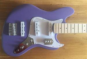

    The colour coats are now sorted. I did two more since the last post, so one key coat and three double headers. I've lightly buffed it back with 800 and it's nice and smooth - so on to the joys of gloss coats!
    Just for fun I put the components roughly on top to see how it would look - I'll be making a completely new pickguard as the middle pickup needs to be slightly further back than the existing pickguard allows so that all three are equally spaced, let alone the rounding off of the lower horn. I quite like the starkness of the white, so instead of doing a very light stain on the neck to "age" it, I'm thinking of just going with some tru-oil. It'll loose a little of the whiteness but not too much...
    You can also see the different bridge I've grabbed for it - do you think it works or should I just go with the standard jazz version? I got it to replicate the look of the tremolo bridge on the Bass VI, which it kinda does but I'm not sure!

  8. #17
    looking good Chuck, the white and purple work well together. Maybe if you can please post a pic with the other bridge so we can see how it looks. Cool idea with the 3 pups !
  9. #18
    Mentor Chuck's Avatar
    Aug 2016
    584
    [Slaps forehead] Why yes, Wok, that would be a good idea wouldn't it?! This one with the standard bridge.

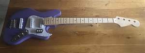

    And a full length shot for good measure...
