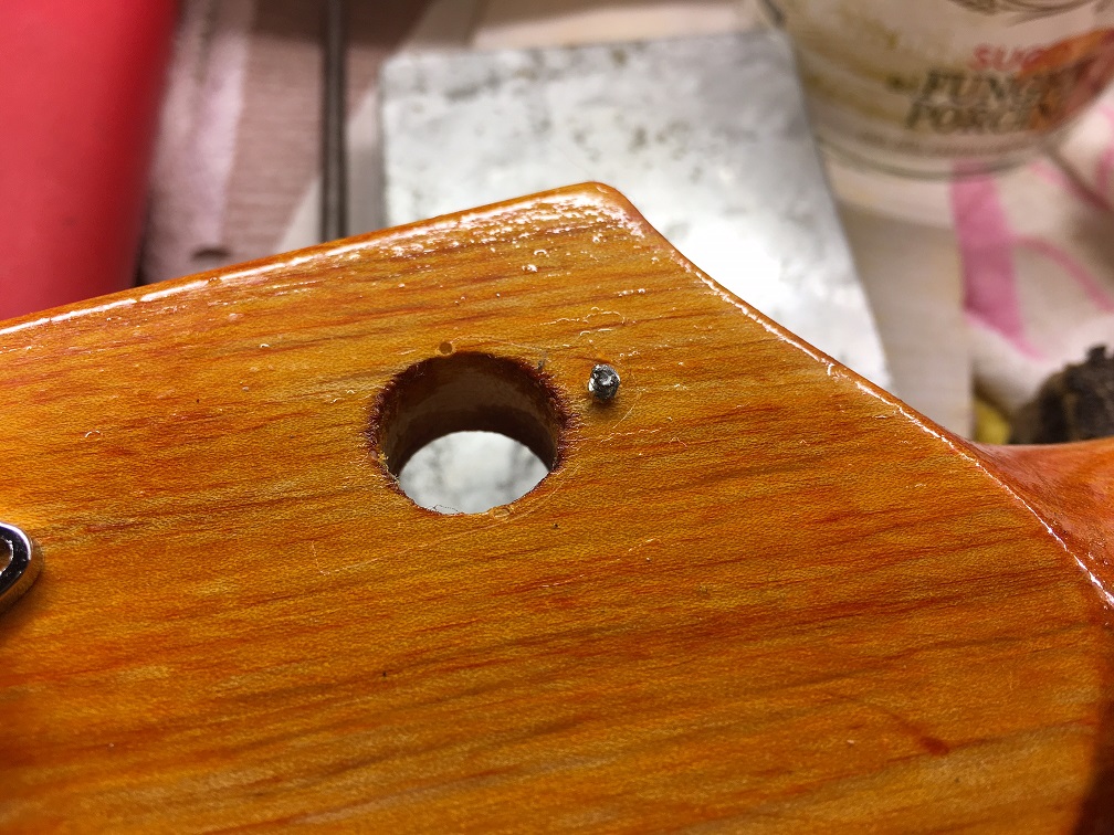

    Got the neck on now. Broke one of the screws on the machine heads. lucky it broke of at the head so I could get it out.......
Name:	Broken Screw.jpg
    Lucky save.
    I religiously wipe the screws in a moist bit of bath soap to lube them up including neck bolts as that Rock Maple is, well, as hard as a rock and this prevents them twisting off like the one in your photo above.
    I bought a block of bees wax and it sits on my work bench when I assemble anything, I just run the thread section of a screw along the edge of the block before putting them in, also makes em easier to get out.

    Good idea Dedman, I have some as well, din't even think of using it.......

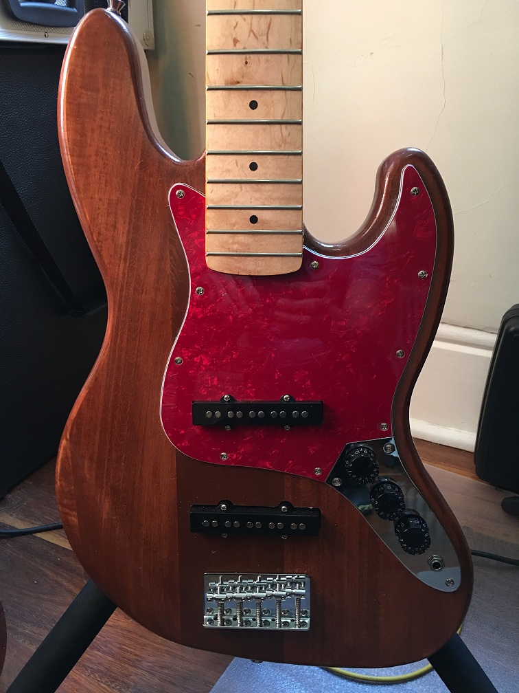

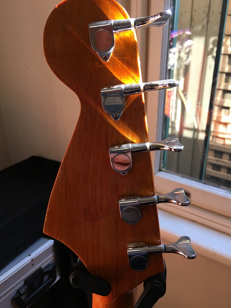

    Got all the hardware on now. Just waiting the the replacement screws from DB and I'll be in business. Neck still a little tacky, needs another week or so before I polish it up I guess.
Name:	Front View 151016.jpg
    Almost there!

Name:	Head View 151016.jpg

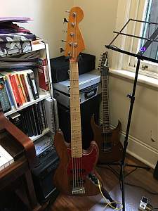

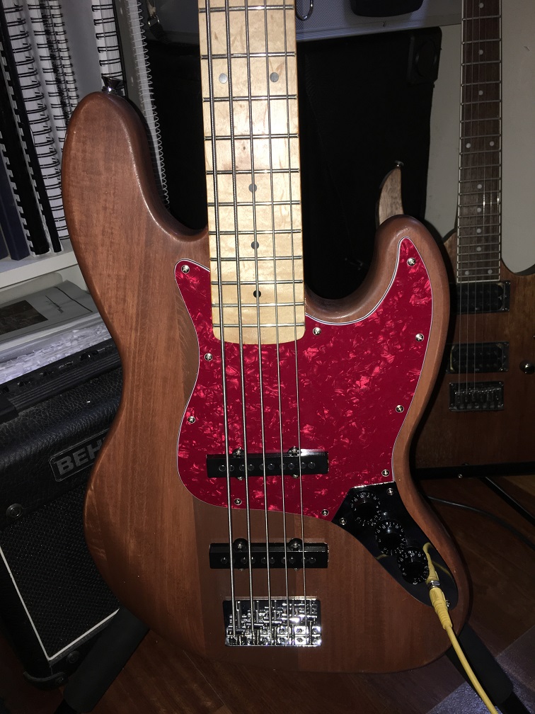

    Strings are on, need to get the action sorted and the adjust the truss rod. It's playable though!
Name:	Strings on body.jpg
Name:	Strings On guitar.jpg
