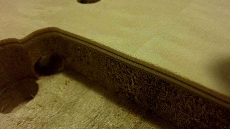

    no worries Storm, have a look into the pickup cavities and you should get an idea how thick the veneer is, should be basswood below it.

    From the top to the black line measures 2mm (0.2cm). Either way, ill still be gentle with the sanding
    Hi Storm I would presume the 2mm is a thin veneer glued to basswood. I haven't heard of a veneer from the factory thicker than 1mm so go easy on the sanding in case !
